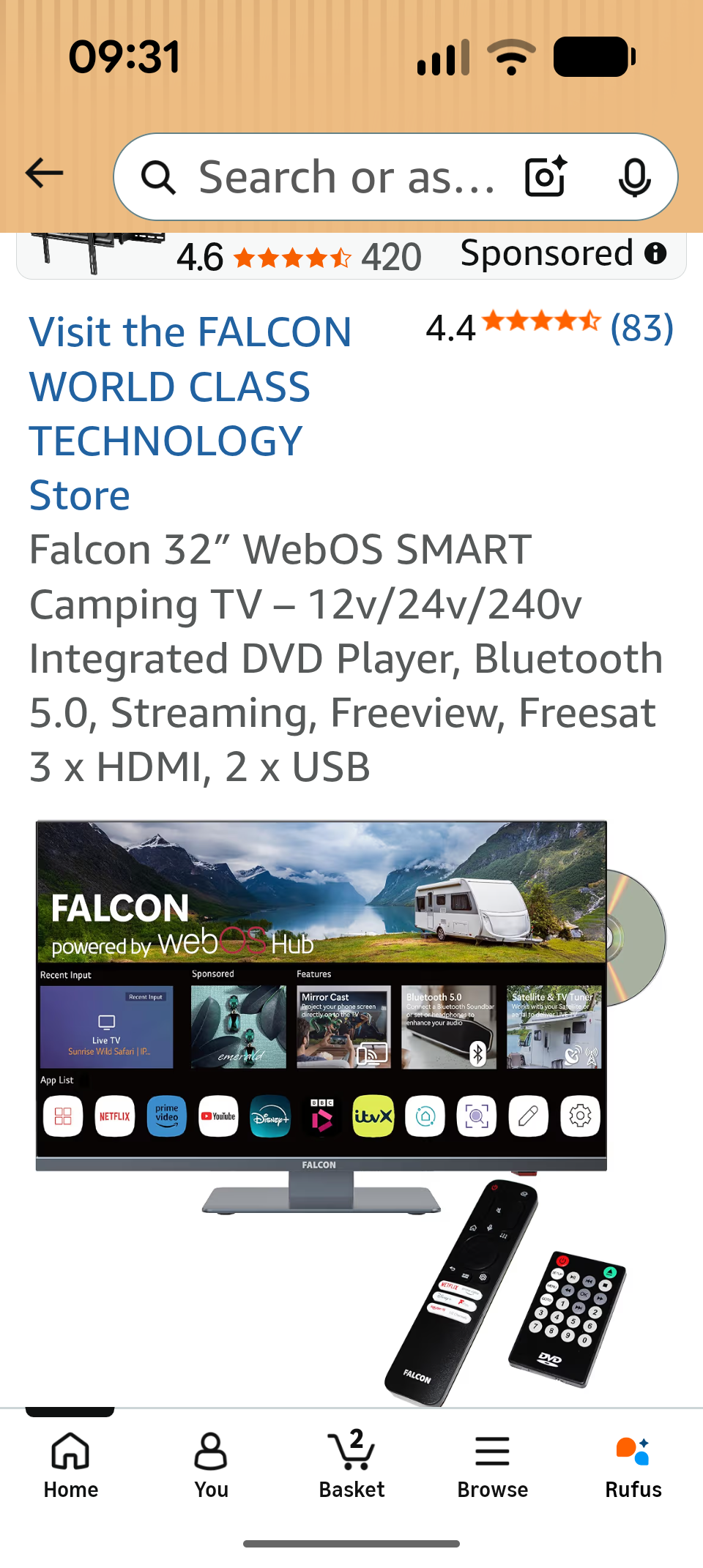

MrsM Posted July 24 Report Posted July 24 We've got a Falcon smart TV with DVD player in our van. Pretty good piece of kit. 1
