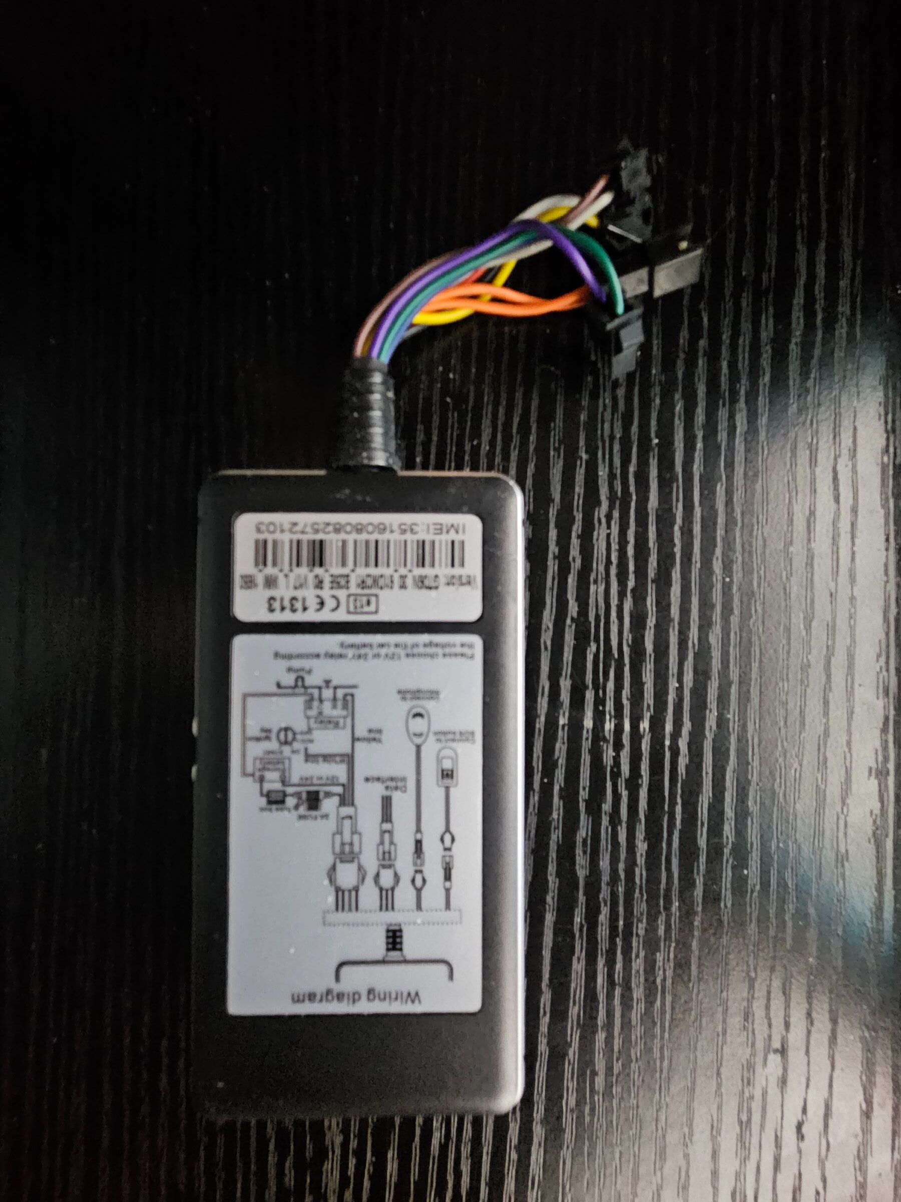

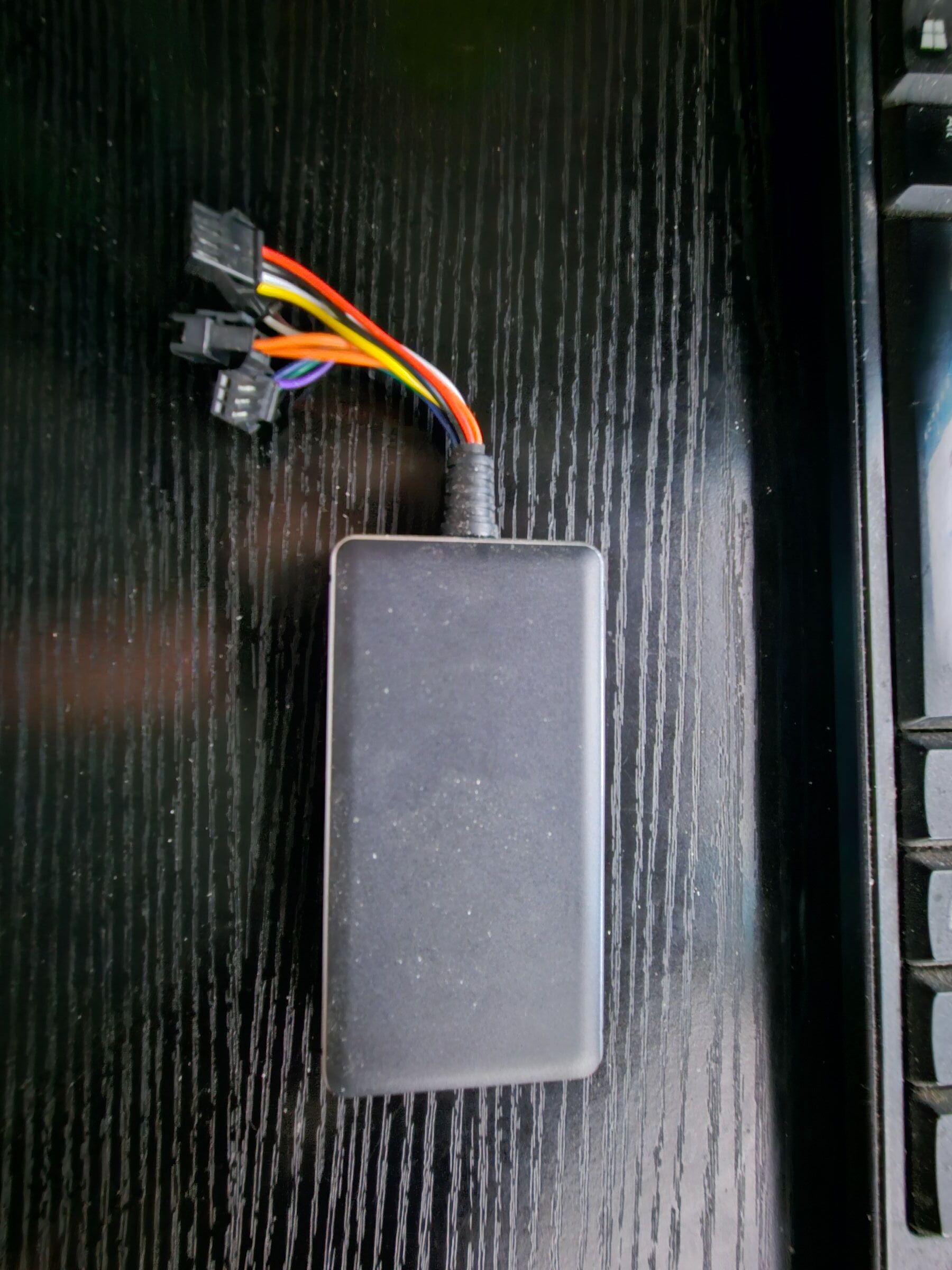

Darrylle Posted July 23 Report Posted July 23 (edited) Firstly, may I state that this site MUST be updated. THIS topic is entirely in the wrong place, due to the fact that the options to place it in the RIGHT place, were hard-coded 10 years ago. A topic subject 'search' MUST show all available topics, BUT.. with an option to add a new one. 😉 (Tidied up by admin, if not useful). I can only hope that my title gets people here (who are serious about REAL narrowboat security). As with bricks and mortar - nothing, but NOTHING can stop a thief getting in. Sometimes, they disable your security features BEFORE they get in (the systems are publicised so much - it's amazing that ANY stop ANY burglars). At this date (July 2026), narrowboat theft seems to have taken an upward curve (we're not seeing marinas being emptied, but I'm seeing monthly, if not weekly requests to 'look out for my boat X'). I've owned lot's of vehicles, including expensive motorcycles (last one: Honda CrossTourer 1300cc - roughly £26k). I fit a 'tracker' to it. It never did get nicked. Waste of tracker TBH. I was almost hoping they tried it. (That's the Harry Enfield 'Old Gits' in me - p'raps). The tracker is a 'cheap' GT06N Chinese model. 20-30 quid (you can get 'em now). Surprisingly good. The features are top... 1) It needs a SIM. Cheapest NOW (on this date): £40 per year - tops - 1pmobile. Data uses 1% of that £40, but - 3 month minimum spend data model.   Find better - let me know. 😉 2) It has geo-fencing (it moves outside your defined physical range - it texts / emails, whatever - YOU define). 3) It has a microphone, so; you can listen-in to the thieving scrotes. 4) It has a speaker, so; you can tell the thieving scrotes what you are intending to do with them, as you are 1 minute away from getting there, with a baseball bat. 5) It has a fuel 'cut-off' feature. Wire it to your diesel pump.   So: call the Police. You can see on it's Google maps (that it sends you when you request it) - exactly where it is, and which direction it's going.   Police get close.    You are talking to the police on a mobile, and they tell you they've spotted it and it's approaching a bridge.   You tell them: "It's travelling at 4mph max; tell me when it's 3 boat lengths away from the bridge".   They say "NOW!"   You send this GPS tracker an SMS, and it cuts the fuel pump.   It slows / stops under the bridge - close distance - easy enough to jump on board (mebbe), but not easy enough to jump OFF - opposite, and if the scrotes DO jump, you've already talked to the cops - they have one both sides. 6) Your boat has not been stripped out, hidden and sprayed. So easy (it is NOT as difficult as you think with compliant repair sites with 'sail-in' buildings). 7) This IS for the GT06N specifically. 8 ) This IS a P.S..... As this CAN communicate with Home Assistant (and all things auto) - it COULD be linked to Home Assistant automation, and COULD effectively stop ANY engine start BEFORE the theft. (It's an option, but now, you need onboard security to notify intrusion - BEFORE). Just sayin' 😉 I'll attach physical images of the tracker, and will add a full list of all SMS message commands required to admin / get responses from it (if ANYONE shows interest). It comes with mic, speaker, emergency 'push' button (automated messaging to relatives etc), all extended wiring etc. (my image shows only the key unit). It was (and still is) a very well thought out 'solution'. I've recently bought my £120k diesel / electric hybrid. I'm Northern, so my IMMEDIATE requirement was a) make it optimally cheaper (5 solar panels), and, I'm going to constant cruise so: SECURITY. They can take it, but I'm going to stop the thieving, bone-idle scum from succeeding. THIS, is how to do it, optimally, for me. Will I STOP it dead? I'm not an idiot - persistent thievery continues, but can I track the chavs, and at 6mph max? Oh yeah; I'll get the scum - thieving my life's work from me? No Socialist councillor will stop me. You know IMMEDIATELY when it is taken. You know EXACTLY where it is, whenever you SMS the GPS tracker. You're likely not that far away and can DRIVE there. You can stand alongside the Police (who I would imagine would be forced to attend for a £120k theft). In THIS boat case - it has remote control, and I am looking at producing an Android app that can take control of it's remote control system (which is already in place) so, I could take control - if I was there, and simply steer it it to us. (This would be totally 'locked down' - single-use Android - no hacking possible - hopefully). I'm looking at developing an Android app specifically for my boat (no others - 'wired-in' ONLY for my boat). However - regardless of that 'remote control' - they're pretty much 'becalmed'. Nowhere to go - nowhere to swim-to, apart from the 'law'. EDIT*: I was aware that the GPS signal MUST be open to unshielded sky (as most people). No problem on my bikes (hidden under plastic fairings). With my 6mm steel narrowboat roof; THAT means that this unit MUST be under the canvas cratch area. Not great, but good enough for now. I'm looking at cracking open my other GT06N to work out how to extend it's GPS signal receiver - wired externally. (Not difficult, by all accounts). It does NOT have a port to do this, by default. I suppose some of us expect too much from 30 quid. (But, I'm absolutely convinced by this units capability; it has proven itself to me over YEARS. I gain nothing personally for this review - I'm happy to say - if it's £20-£30 - grab it - it WORKS so well! It really does. EDIT*: Size of unit = 4" X 2"  Edited July 23 by Darrylle Latter research - GPS unit size 1
Russ T Posted July 23 Report Posted July 23 Good write up. Â Can you confirm if this unit uses something other than the soon to be obsolete (2029 for EE) 2g network? Â ThanksÂ

StephenA Posted July 23 Report Posted July 23 10 hours ago, Russ T said: Good write up.  Can you confirm if this unit uses something other than the soon to be obsolete (2029 for EE) 2g network?  Thanks   It uses the 2G network. 1
