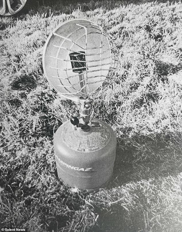

A picture of the heater the couple used was shown at the inquest on Wednesday. It was not designed to be used in enclosed spaces and they succumbed to the fumes from it
A married couple died from carbon monoxide poisoning at a cider festival after they went to sleep in their campervan with a leaky gas heater on that should not have been used indoors, an inquest heard.
Christopher and Kayleigh Coll, who had four children, were found dead in their campervan having succumbed to fumes released by the gas heater which they switched on before bed in chilly October temperatures.

Yes and on the instructions it will no doubt say to use in a well ventilated area which it would appear this particular camper van wasn't.
ETA: Quote from the inquest
"He said that the type of heater being used was a Parabolic heater, which is not designed to be used indoors and must be used in well-ventilated areas"
It would also appear that the campervan conversion had no background ventilation:
'It was an everyday vehicle that was being used. That is why there was no ventilation. It was not designed to be a campervan"

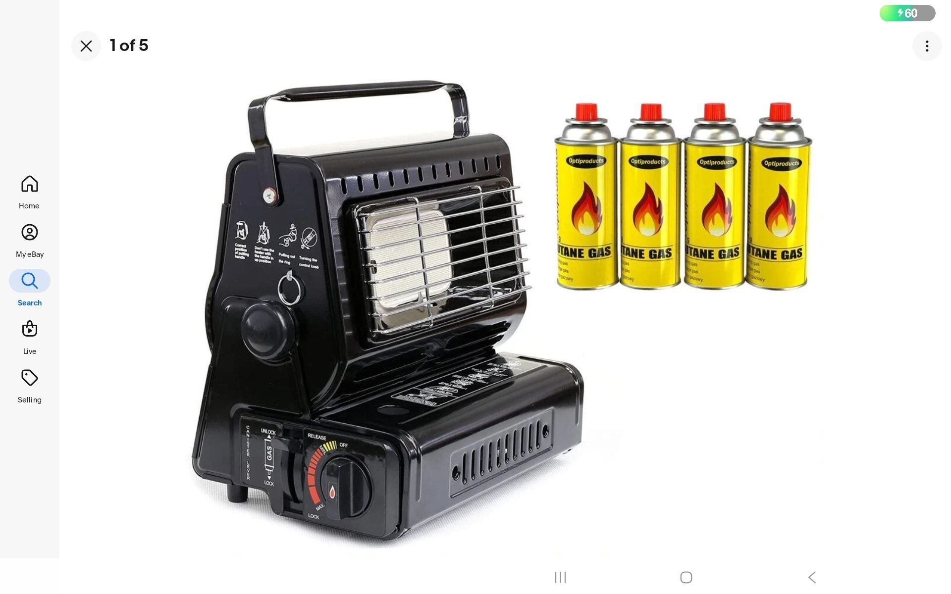

I have run various gas heaters in my boat when i've run out of coal and the CO detector has never even noticed and nor have I.
These ones
.77987.jpg.5da817b24bc8a9179e8a35a8c510eb80.jpgScreenshot_20260723_180316_eBay.thumb.jpg.a4529798e2fe6444a34c258fc9a16ebb.jpgfq180-7.jpg.fc0982ef36b814c76affd67c9156eae6.jpg
These ones

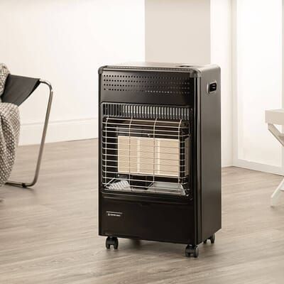

These are superser type heaters which are designed to be used indoors. They have flame failure and oxygen depletion sensor to shut it down if the pilot flame goes out or O2 levels drop too low. They rely on high O2 levels so complete combustion takes place so no/little carbon monoxide is produced, so require ventilation. Along with Carbon dioxide and water vapour, they produce Nitrogen dioxide which isn't ideal for indoor air quality.
I imagine most steel canal boats have sufficient door vents and mushroom vents to already have enough ventilation to run one of these, but best to check.
