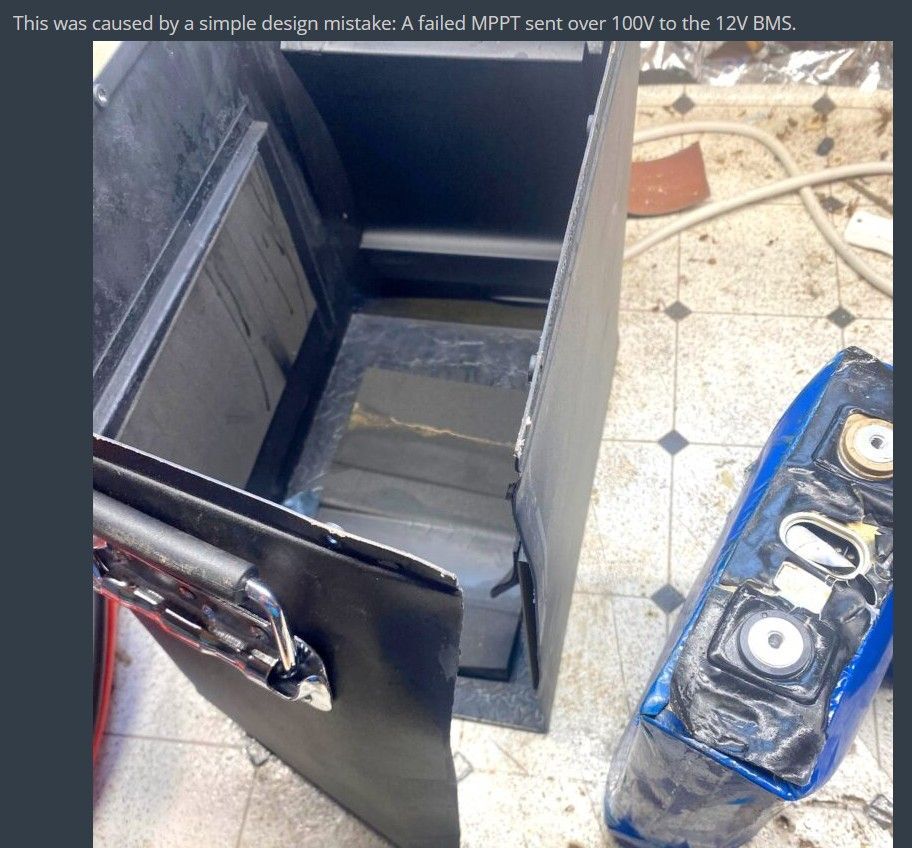

The simple fact is that the ABC boat had an LFP battery/BMS and external charging system, just like all the other boats with LFP batteries on board, and something (which ABC refuse to disclose...) went horribly wrong which shouldn't have happened but did. AFAIK it's the first recorded case of such an LFP fire/explosion caused by overcharging/gassing on a boat, but it still happened, and there's nothing in place to try and stop it happening again.
Before saying "oh, this was an exceptional case, used every day..." there have been other non-dayboat cases of gross LFP overcharging from things like an MPPT failing short-circuit and dumping the full solar panel voltage into the battery (see picture) -- and this could happen to any boat if there are no suitable failsafes in place, which I suspect many don't have. Yes this one didn't cause a gas explosion, but I suspect that's more by luck than judgement.
Yes these are relatively rare (but real...) occurrences, but the problem is that the consequences can be severe, and the regulatory bodies are not going to wait for somebody to be killed before taking action -- because if they did everyone would throw their hands in the air and cry "Why didn't they warn us?". More to the point for the near term, insurers are already starting to put lithium clauses into their policies, many of which are unjustified and will cause major difficulties for some boaters, and this problem will only get worse unless a sensible common policy on "LFP installs on boats" can be arrived at.
That Incident makes interesting reading. I wonder whether the professional/competent installer would have picked up on the fact that the array was oversized for the controller,and the BMS may well have done it's job otherwise.
Doesn't help, a 12V BMS will typically use MOSFETs rated at 30V-60V (depending on design quality/cost), shove 100V into these (that's only 3 series panels, quite normal) and they're likely to fail short-circuit (because that's what power MOSFETs typically do with major overvoltages).
Edited by IanD
But if it was correctly sized,the mppt would not have failed,or at least less likely to have failed.If the voltage was limited to below the MOSFET rating too,it should also function properly.
My point is,how many competent/professional installers would examine an existing solar install when installing LFP. The answer,should be all of them, judging by that article
Edited by Russ T
What would happen to a lead acid battery in this scenario? Presumably nothing good, as the author says:
That's not how MPPTs work -- of course they're designed not to fail when run within their ratings (e.g. a 150V MPPT for 3 series panels with ~100V output), but nevertheless they do occasionally fail. And if they do, the most likely failure mode is short-circuit.
If this happens and they let the full panel voltage through to the BMS then what happens depends on the design and component ratings -- a 48V BMS will almost certainly survive, a 24V one might or might not, a 12V one will almost certainly fail (not designed to withstand 8x nominal input voltage). Guess which is most common on boats?
The point about LFP is that it really *is* the entire system that matters for safety, including all charging sources as well as the BMS/control system. So yes, an installer should check any solar installation.
Whether they also check for things like alternators frying due to heavy loading or dying due to the inductive spike is there's a HV disconnect while charging is a more subtle point; the Guidance Note points this out, you could say it's a cost issue for the boater rather than a safety one, but I imagine that if either happens and they have to buy a new alternator they're not going to be very happy with their installer... 😉
Yes, the LA cells would have presumably boiled dry. But the issue is that the volume of gas emitted from a grossly overcharged LFP cell is *way* higher than from an LA cell, at least 500l/kWh (some report up to 6000l/kWh) compared to 25l/kWh for FLA (5l/kWh for VRLA).
LA batteries already have ventilation requirements when installed in boats, right now there are no such regulations for LFP -- which is entirely wrong, given the above facts.
Edited by IanD
So still potentially a situation that would cause a fire or explosion then?
Yes, which is precisely why there are rules (RCR/BSS?) about LA ventilation.
Since LFP emit 20x/100x/250x/1000x more gas (depending which LFP/LA numbers you use) the fire/explosion risk when overcharged is much higher, unless suitable precautions are taken.
Edited by IanD
