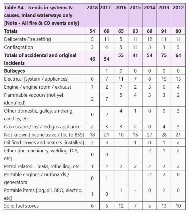

jonathanA Posted July 13 Report Posted July 13 44 minutes ago, IanD said: Now consider electric drive boats -- my guess is there are maybe 100 on the canals, and last year one of them blew up. That's 1%, 100x bigger... 😞 And it's the only data point anyone has -- maybe it won't happen again for 10 years or 100 years, maybe it'll happen again this year. What you can say is that if LFP (electric drive, as installed today) was as safe as gas (as installed today) the odds against that accident happening were 100:1 -- but it happened, which suggests that LFP as installed today is not as safe as people think/hope. So why would anyone think that LFP batteries shouldn't have similar restrictions to LPG gas bottles? (not in living space, vented overboard) I can't help think you are confusing electric drive and domestic systems... so the 1 % argument is fair enough for drive systems and I would suggest the very large amount of stored energy in a full electric drive system warrants more care. However what's the percentage of boats with LFP domestic batteries? Based on this forum its at least 30% maybe nearer 50% so let's say 10,000 boats have some lfp install ? How many reported cases of fires with boat lfp systems. ? None ? A handful of poor long wire installs maybe? So accepting that in the one known fault condition for LFP, of over charging causes more gas than for an equivalent LA Isn't that the fairly unlikely situation that needs looking at and isn't your assertion that LFP installs are as dangerous as gas installs typical of the hysteria that is coloring the whole Lithium battery debate ?
MtB Posted July 13 Report Posted July 13 55 minutes ago, IanD said: And that works -- out of maybe 30000 boats with gas on the inland waterways there are about 3 explosions per year on average, which is 0.01%. And just to point out gas explosions are not the only (or even the main) risk where DIY gas work is concerned. Carbon monoxide poisoning is far more common. 1 hour ago, Alan de Enfield said: Rumours abound - my personal recommendation would be to do nothing until the specification / requiremenst are finalised and issued. WHAT????!!!!! You'd have the OP struggle along with his existing batteries for another decade??!!
Alan de Enfield Posted July 13 Report Posted July 13 3 minutes ago, MtB said: And just to point out gas explosions are not the only (or even the main) risk where DIY gas work is concerned. Carbon monoxide poisoning is far more common. WHAT????!!!!! You'd have the OP struggle along with his existing batteries for another decade??!! I reckon there is enough drive behind this that within 2 years it'll all be decided and published - could even be less.
IanD Posted July 13 Report Posted July 13 (edited) 24 minutes ago, jonathanA said: I can't help think you are confusing electric drive and domestic systems... so the 1 % argument is fair enough for drive systems and I would suggest the very large amount of stored energy in a full electric drive system warrants more care. However what's the percentage of boats with LFP domestic batteries? Based on this forum its at least 30% maybe nearer 50% so let's say 10,000 boats have some lfp install ? How many reported cases of fires with boat lfp systems. ? None ? A handful of poor long wire installs maybe? So accepting that in the one known fault condition for LFP, of over charging causes more gas than for an equivalent LA Isn't that the fairly unlikely situation that needs looking at and isn't your assertion that LFP installs are as dangerous as gas installs typical of the hysteria that is coloring the whole Lithium battery debate ? The "big hot dangerous" threshold for LFP batteries is something like 1kWh according to the ISO standards -- this is where it becomes too big to try and put any fire out (just get out!), the risk of emitting large quantities of toxic/flammable gas becomes too high, and precautions like venting/not in living space become necessary. Yes propulsion batteries (like the ABC dayboat) obviously fall into this, but so do even small domestic LFP batteries -- a single 12V 105Ah for example. The amount of gas emitted from a grossly overcharged LFP battery is something above 100x that emitted from a gassing LA battery the same size, and that's the basic problem. For this to happen, all that you need is a battery/BMS/charger failure like (it seems) happened on the ABC boat -- and this can happen just as easily on a domestic system as a propulsion one. The fact that it hasn't could be because there have not been many domestic LFP installs other than using drop-in batteries not rack-mount ones like in the ABC boat, but as numbers go up this kind of event is likely to recur. Believe me, I've tried arguing that there have been lots of LFP batteries out there for years with no such problems, but this comes up against the brick wall which is that they all include similar components, and similar things can go wrong, and the consequences if this happens are similar. The risk might be small but the consequences are severe, and that's exactly what regulators and insurers don't like. I think you'd have to conclude that as they're done at the moment LFP installs -- even domestic, and certainly electric drive -- probably *are* more dangerous per boat than LPG installs -- not 100x (though you could make a good case for this for electric drive), but they're certainly not as safe as everyone used to think... 😞 17 minutes ago, MtB said: And just to point out gas explosions are not the only (or even the main) risk where DIY gas work is concerned. Carbon monoxide poisoning is far more common. WHAT????!!!!! You'd have the OP struggle along with his existing batteries for another decade??!! Here are the actual numbers for fire/CO events -- gas escape averages out about 3 per year, electrical about 10, CO isn't separated out. Edited July 13 by IanD 1
