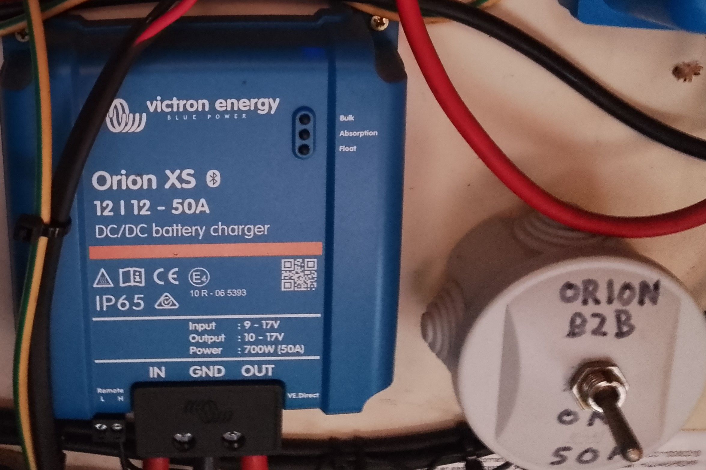

13 hours ago, Jen-in-Wellies said:
You can also fit a simple switch, wired across the Remote L H connections on any Victron  Orion B2B to disable them. I do this in summer, when solar supplies all my electrical use. Switch it back on, when required, over the darker months to suplement the solar.
Posted this pic before.
The OP can install solar charged LiFePO4 now and won't have to make a decision on winter charging for a few months.
Couldn't you just switch off the B2B using the Victron app rather than having a physical switch? I've probably misunderstood what you mean.
You could. A switch is easier and quicker and you can see at a glance if it is enabled. KISS principle.

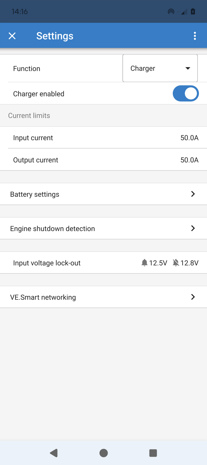

22 minutes ago, blackrose said:
Ok got it, thanks.
For some reason I had both input and output set at 30A. I didn't realise I could set the input current. I've now got the input set at 35A and the output at 50A.
You could monitor the temperature of your Alternator to see if you could increase that current at all for faster charging
