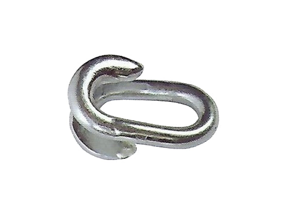

I couldn't when I was looking a few years back. In the end I made my own using chain, rings and repair links (hammered flat) in place of the shackles.
