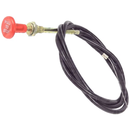

blackrose Posted Wednesday at 08:47 Report Posted Wednesday at 08:47 33 minutes ago, cuthound said: One of the first things I did in my Beta 43 was to paint the stop lever red (it was Beta green like everything on the engine, including the hoses) so that anyone unfamiliar with the engine could identify it and stop the engine should the stop solenoid fail. My stop solenoid became disconnected once and it's quite disconcerting when you push the stop button and nothing happens. I drilled a hole in the control pedestal and attached one of these "Pull to stop" cables to the stop lever so I can manually stop the engine without lifting cruiser stern deck boards. 1
David Mack Posted Wednesday at 11:09 Report Posted Wednesday at 11:09 I remember when all those "pull to stop" cables had the word "choke" printed on the knob.
