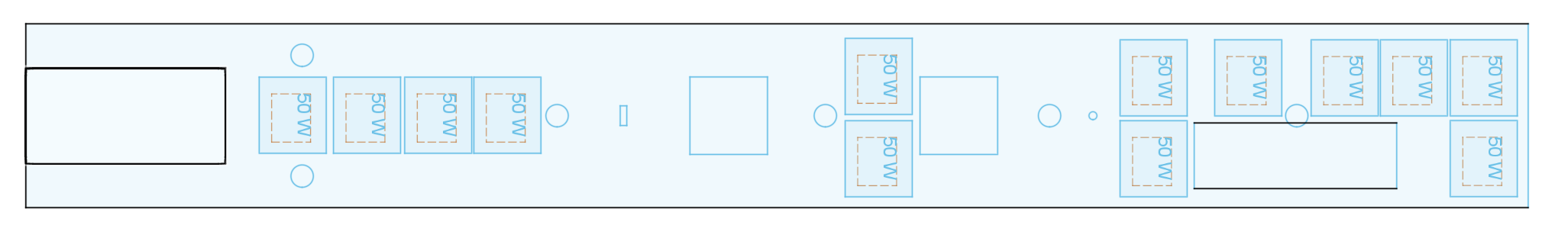

My roof is more cut up due to two Houdini hatches , a couple of port/starboard mushrooms, and a built-in plank etc. rack the positioning of which I really don't like but there it is.  Latest thought is 13 small 50W panels on magnetic feet.
Ive got 2 x 275 W,  550W,  which is just adequate for a low user.. 650 will be better, not sure about the extra cost and the serial v parallel electrics?
I wonder if you have considered having the first four panels tilting, because this would be fairly easy to alter. You could of course have the middle ones tilting, gives you a differernt aspect. I would think about having a group of two then three on the port side, but not bother with the two starboard ones, particularly if costs were  being stretched.
I think one has to be careful to prevent any corrosion.

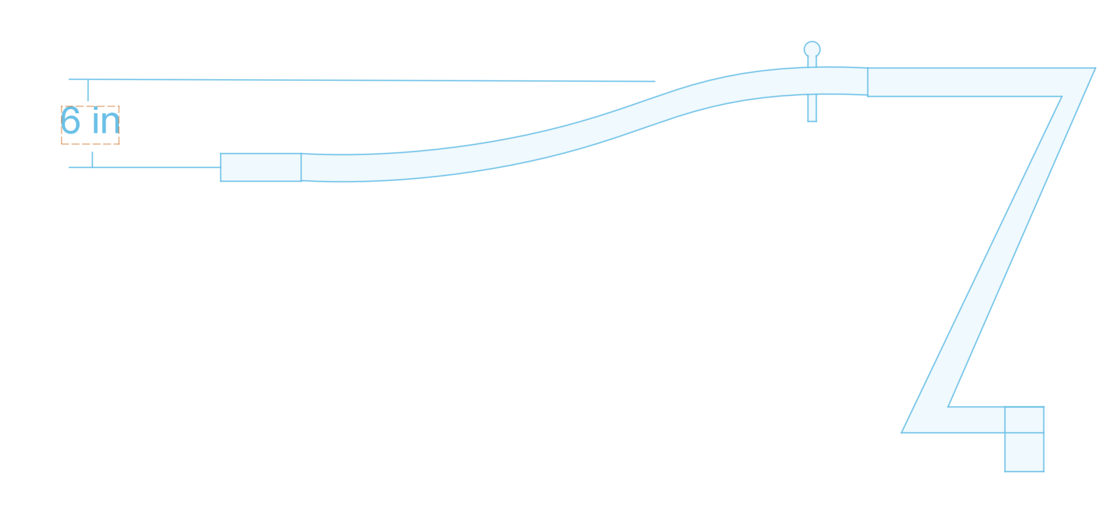

One thing that I will not get used to and seriously needs to be rectified:  The original owner appears to have been quite a tall man.  The tiller height is at least 6 inches too high and causes me serious shoulder strain.  I've been told that the fix for this is to saw down and re-weld the swan neck, which sounds like an expensive and time consuming procedure.
Why does this not exist?

The answer does exist.
Stand on a milk-crate and not only will it be easier with the tiller, but you'll be able to look down the length of the boat.
Does Snow White know you have bought a boat ?
Stand on a 6" high box first to check, before spending a load of money getting a tiller bar shaped like that!
A decent boatbuilder would probably find cutting and shutting the Z iron easier than bending the tiller tube - especially if you have a brass tiller.
A point to note: If you have a trad or a semi trad stern, check the clearance between the end of the tiller handle and the back doors/ slide rails. Lowering the handle end can result in a nasty finger trap, and you may need to shorten the tiller handle, which will then give you less leverage for steering.

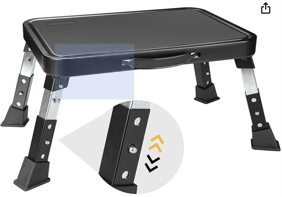

Within two days of steering this boat I bought one of these
Oh yes, it's a shoulder saver, and as you say, it does provide a nice view.  It also provides another thing to manage, and something to trip over.  I suppose I could get used to it, especially once I see the estimate for chopping the swan neck and tiller.  It also comes in handy as a step to get up to the roof from the semi-trad locker.  And to deal with the other piece of tall-man evidence, the toilet.
It doesn''t feel like a long-term solution for steering.
Yes, definitely the tiller would need to be two or three inches shorter. More work.
This seems to me to be a matter of equipage.   There are tube bending mills that make a double curve like that a piece of cake.  A canal boat builder just doesn't have tube bending in his tradition or repertoire, and may not have ever seen one.  A sailboat builder who does railings, perhaps, might be more equipped for such fabrication.
The curved tiller idea is also presented as an attempt to annoy the natives by coloring... ahem... colouring outside the lines.  Apparently successful.  🤣
Yes but in ductile materials such as steel or copper, but not in brass. Brass is not ductile and does not take kindly to attempts to bend - it snaps instead.
I would leave it and stand on what you have. If you look at other boats quite a few people stand on milk crates and the like. Alternative is to change sides from time to time or as LadyG suggests (politely) use your body for a while.
I suspect the boat was built with the tiller as it came and not for anyone in particular but could be wrong for some boats.
Also worth noting that it’s probably a thing on long pounds and so on quite a few canals you won’t get a chance to get sore. You may also find that a bit like an athlete your musculature will get adapted to this new usage.
May I enquire exactly how high your tiller bar is, above the steering step or deck?
My own tiller on the last boat seemed high but once standing on the steering step (trad stern boat) it was fine for me, and standing directly ahead of the tiller and leaning back onto the wooden handle to steer, it fitted the small of my back perfectly.
Do you stand on your semi trad to one side of the tiller? Or in front of it?

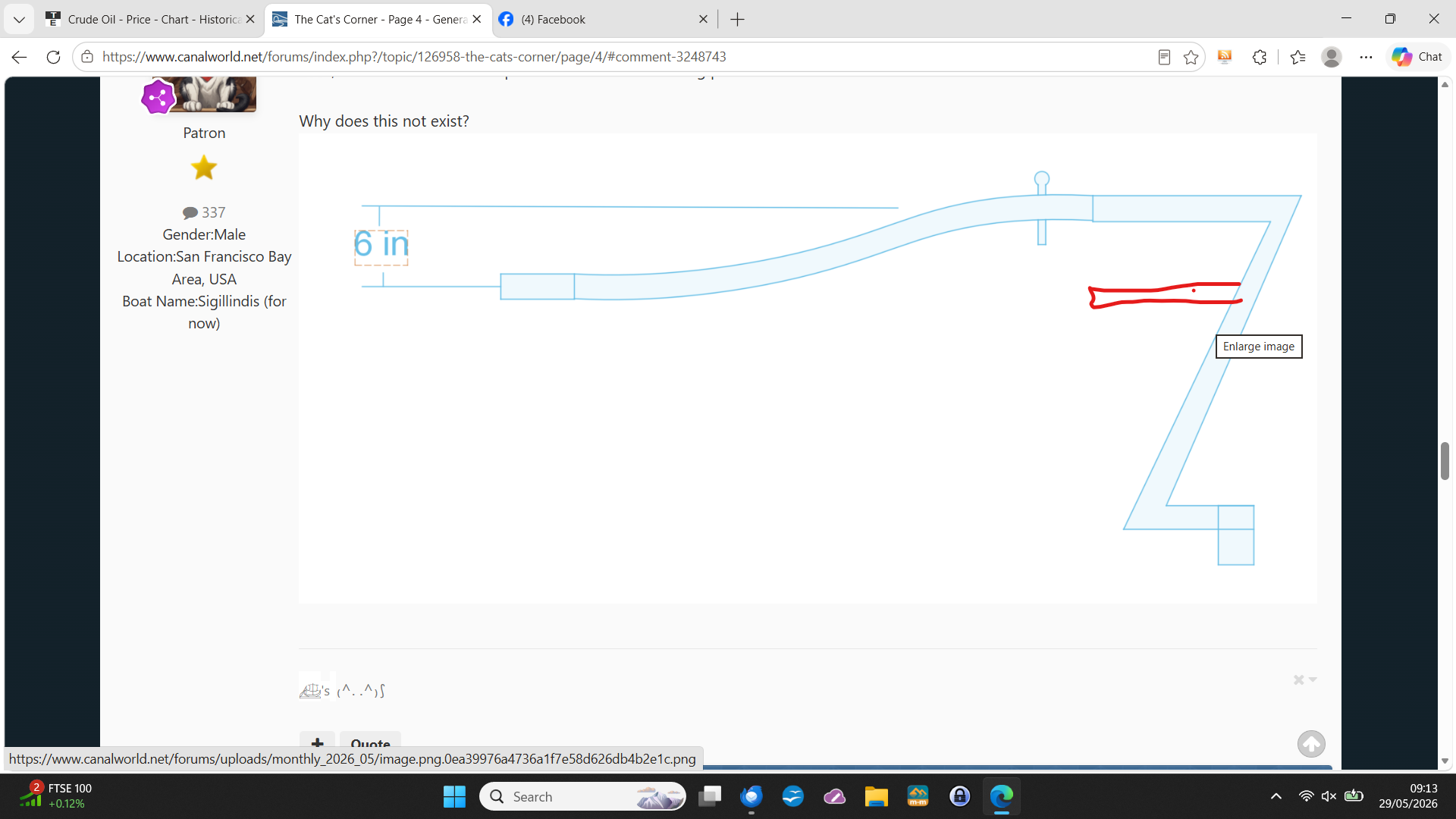

Weld a new bit on

The previous owner of my boat was a short ar*e.
He had the swan neck set so that when you steered from the correct position (inside the stern doors with the tiller behind you) your fingers got trapped between the cabin return and the tiller handle.
I had the bends on the swan neck eased (by heating them and re-bending them)  equally, because I hate tiller bars that are not parallel to the water.
Edited by cuthound
Clarification
When we got kelpie, you would often get trapped knuckles between the tiller and the cabin roof. It now has a hinge on the tiler with it permanently angled slightly up. I often steer with the tiller under my armpit which saves shoulder muscles 🙂
