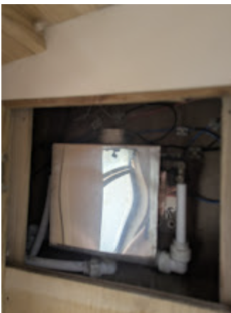

The head tank for the coolant loop is empty.  Here is the had tank:

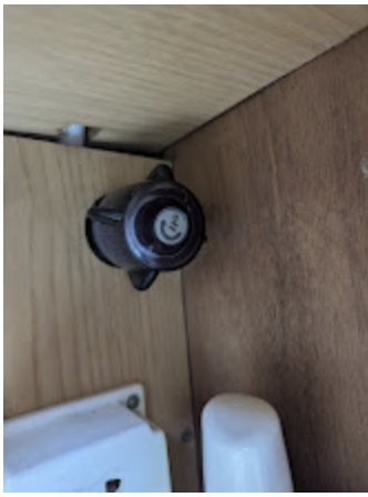

Under it is a valve, closed.

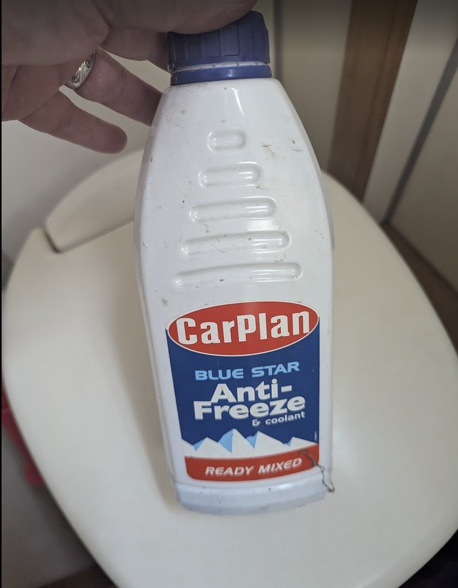

This is the liquid product I found on the boat:
What is the sequence of filling the tank, opening and closing the valve, and bleeding the radiator?  And do I dilute this "ready mixed" antifreeze?
OK, the valve under the head tank isn't a shut-off valve, it's a filler valve from the water system.  Now I get it.

A pic of a header tank with all its surrounding pipework circuitry concealed with woodwork is hard to decipher. All boats are different, albeit with some common themes often used. Similarly with the valve. Without being able to see the pipe it is in, along with were it comes from and where it goes, about all anyone can say is it was made by SpeedFit about 20 years ago. Possibly.
Yes, snowflakes that narrowboats are.  I get it.  I had assumed the setup was common.
I needed to bleed out a big air pocket in one of my radiators, but I was concerned that the fluid had to come from somewhere.  My friend searched for and found the head tank, which was empty.  What I had to do and did was to add some antifreeze to the head tank, fill the rest with water by opening the pictured valve and feeling with a finger for when it was full, and then bleed the radiator with the circulation pump off.  All good now.  Rear of cabin is now getting full heat.

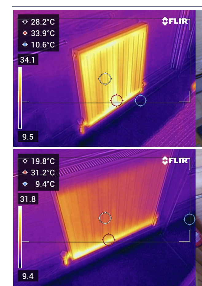

Ya want impressive?  The reason I knew about the air pocket was from thermal imaging in the pre-purchase survey.
Top image is fully functioning radiator.  Bottom is the one I just bled.

Us professionals at this can tell though, without a thermal imaging camera, just by looking at a radiator.
One can feel the radiant heat from a hot radiator on one's face from a distance, once one gets tuned into it.
And if that fails, putting one's hand on the rad immediately removes any doubt!

Nor can I tell if a radiator is hot by looking at a photograph of it, lol.

Uh, yes, and I respect your experience, something on this subject I ain't got.  I understand that to you using thermal imaging to diagnose a radiator is like having a fancy instrument to tell you it's daylight outside.  But I have never lived with hydronic heating systems other than on narrowboats.  They are very much uncommon where I live, where most homes use forced air.  The difference between a warm and a hot radiator and why it would be that way... just doesn't occur to me naturally.  Without some kind of prompting I would have simply lived with the condition, wishing I was warmer.
