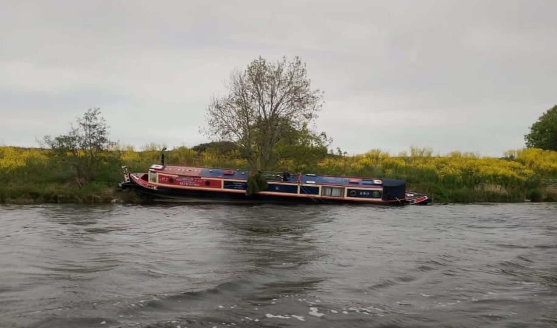

From Facebook via another group:
This is Tenacious (that used to belong to Ian M Thompson), on the non-tidal Trent near Cromwell Lock.
Any idea how it happened, being towed or under her own power
The boat has been there many months and it seems the winter high water levels have left it grounded.
@MrsM posted about this boat back in February when she was concerned about how it was moored.
I'm still concerned about it! It's too nice a boat to be left like that. Is it taking on water does anyone know? I reported it to CRT but the owner obviously didn't move it. 😞
Looks like any worries about any potential security issues was the least of this boats problems!
I would say it is not taking on water at present but it is possible the bow has been below the water a some point when river levels were  higher .
  • Sad 1
If anyone knows how I can get in touch with the current owner of Tenacious then please let me know - I can't get this boat out of my mind.
I have emailed Great Haywood, who had the boat up for sale in 2024, and also CRT asking them to pass on my contact details to the registered keeper.
