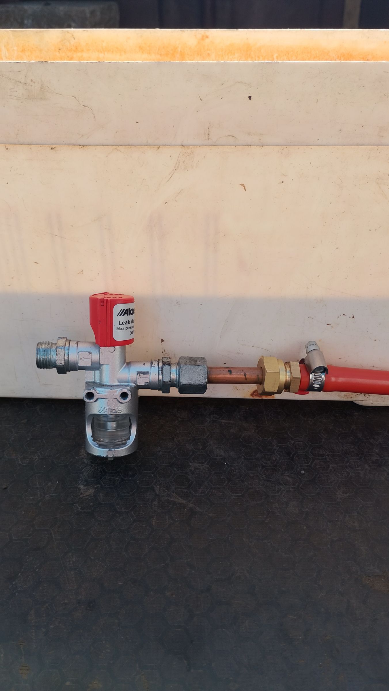

I have a few questions in regard to use of a 10mm Alde bubble tester, and it's compliance with BSS regulations
The copper piping in my boat is 3/8 imperial. The current gas bottle set up is the regulator connected by 8mm gas hose to a Fulham nozzle bulkhead compression fitting located in the gas locker.
This creates the issue of having to swap out the Fulham nozzle to a reducing coupler compression fitting 10mm to 3/8 , if I was to use all copper pipe from the bubble tester.
The 8mm version of this bubble tester comes with 2 barbed inserts, which are designed to connect to hose on both the inlet and outlet, presumably for use in motorhomes/vans ect .However I'm unsure why the 10mm version does not come with such? I probably should have bought the 8mm version!
If you refer to the picture , my solution has been to use a small section of 10mm pipe connected directly to the bubble tester , with a 10mm Fulham nozzle attached to hose(class 2) with a jubilee clip, that then goes to the regulator.
The same will then be done to the outlet side and then it can be easily connected to the existing Fulham nozzle to the 3/8' gas work.
Total length of flexible hose around 50cm on both sides ,so with in the 1metre limit stipulated in the BSS. I am unsure whether jubilee clips are sufficient, or are some other sort of clips needed?
I have seen various examples of gas hose being used with these 10mm bubble testers but only on the inlet side between the gas bottle and the bubble tester.
Can any one see any issues with this set up, and whether it would go against BSS requirements. These testers are designed for use with gas hose , so I feel as though this still  fits with in conditions set out in Appendix d of the bss regarding post 2008 bubble testers
When you go slightly off-piste like this, the person who needs convincing it complies is your BSS examiner. Marshalling arguments that it complies will be no help at all if your BSS bod takes against it. Even appeals to the BSS office when you know you're right don't help (or so we learn on here).
Being pragmatic, you're probably best off asking this question of your BSS bod first rather than afterwards, rather than trying to persuade him or her later that it complies.
As far as I can tell that is OK for bss providing the hoses* are less than 1 metre. I just looked up the bss tests for this (see below)
A friends boat has just failed for having that set up but the numpty who Installed it just forced the hose onto the 10mm copper pipe and stuck 2 jubilee clips on it. 4 yrs ago a bss examiner passed it, last Saturday a different one failed it. (Although his advice was to fit compression to Fulham nozzles and he would pass it).
* obviously proper gas hose marked appropriately and in good condition.

actually still had the BSS page open heres what it says
Applicability – where a bubble leak detector of suitable proprietary manufacturer is located within a
cylinder locker or cylinder housing, up to 1m of hose may be installed between the cylinder mounted
regulator and the detector, and up to 1m of hose may be installed between the detector and the supply
pipework. The hose between the detector and the supply pipework must be located within the locker
or housing.
Applicability – where there is a single appliance located very close to the cylinder installation it is
permissible for hose to run from the cylinder installation to the appliance without pipework provided
the hose length does not exceed 1m.
Applicability – for ‘all-hose’ systems apply Check 7.9.6
and 7.9.6 says (amongst other things)  :
hoses must have permanently attached end fittings, such as swaged
sleeve or sleeve and threaded insert (worm-drive clamps are not
permitted);
you live and learn...

Thanks for bringing this section to my attention 👍 So technically you can have up to 2 metres of gas hose! Wild
I looked in to this a bit more and apparently it's an addition to the 2023 BSS. There is a document , where they give reasons why changes were made and for 7.9.4
Explanation of change: This new Applicability formalises the longstanding BSS Office position.
So I feel more confident that with the Fulham nozzles this should be compliant and the use of jubilee clips ( aka worm driven clips) should be fine as it's not part of an "all hose" system.
