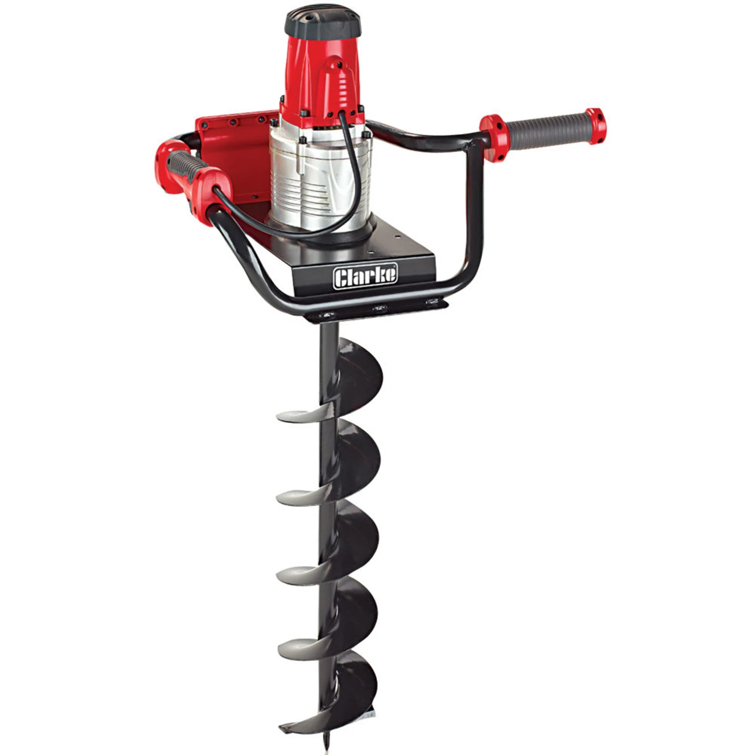

The problem with those screw anchors is they have to be put into the ground by hand and how are you going to do that on hard ground?
Edited by blackrose

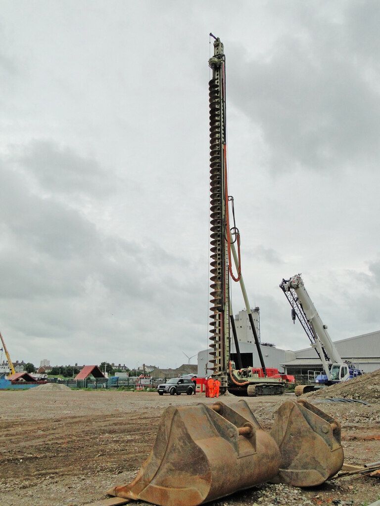

Jen, that's not the mooring peg! You need half a truck of concrete after boring out the hole, then should hold your 50m rebar loop good and firm. 👍
And raise you
