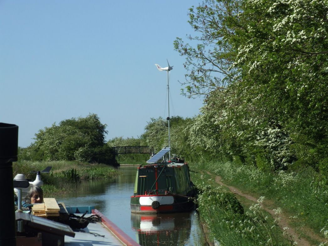

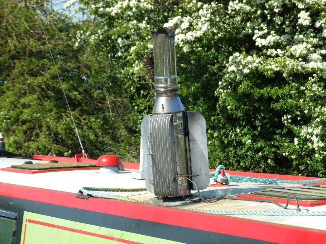

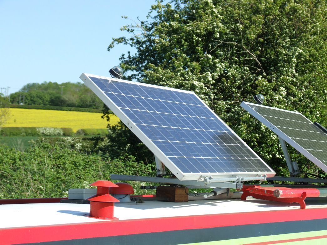

ditchcrawler Posted April 30 Report Posted April 30 Passed this today, wind genny, what I think are self tracking solar panels and a Peltier stack on the stove chimney 1 1
Up-Side-Down Posted May 1 Author Report Posted May 1 9 hours ago, ditchcrawler said: Passed this today, wind genny, what I think are self tracking solar panels and a Peltier stack on the stove chimney The peltier stack is an interesting observation. Any thoughts or comments from anybody ..........?
ditchcrawler Posted May 1 Report Posted May 1 1 hour ago, Up-Side-Down said: The peltier stack is an interesting observation. Any thoughts or comments from anybody ..........? He said it was fun but he wouldn't bother again. He likes playing I think 1
