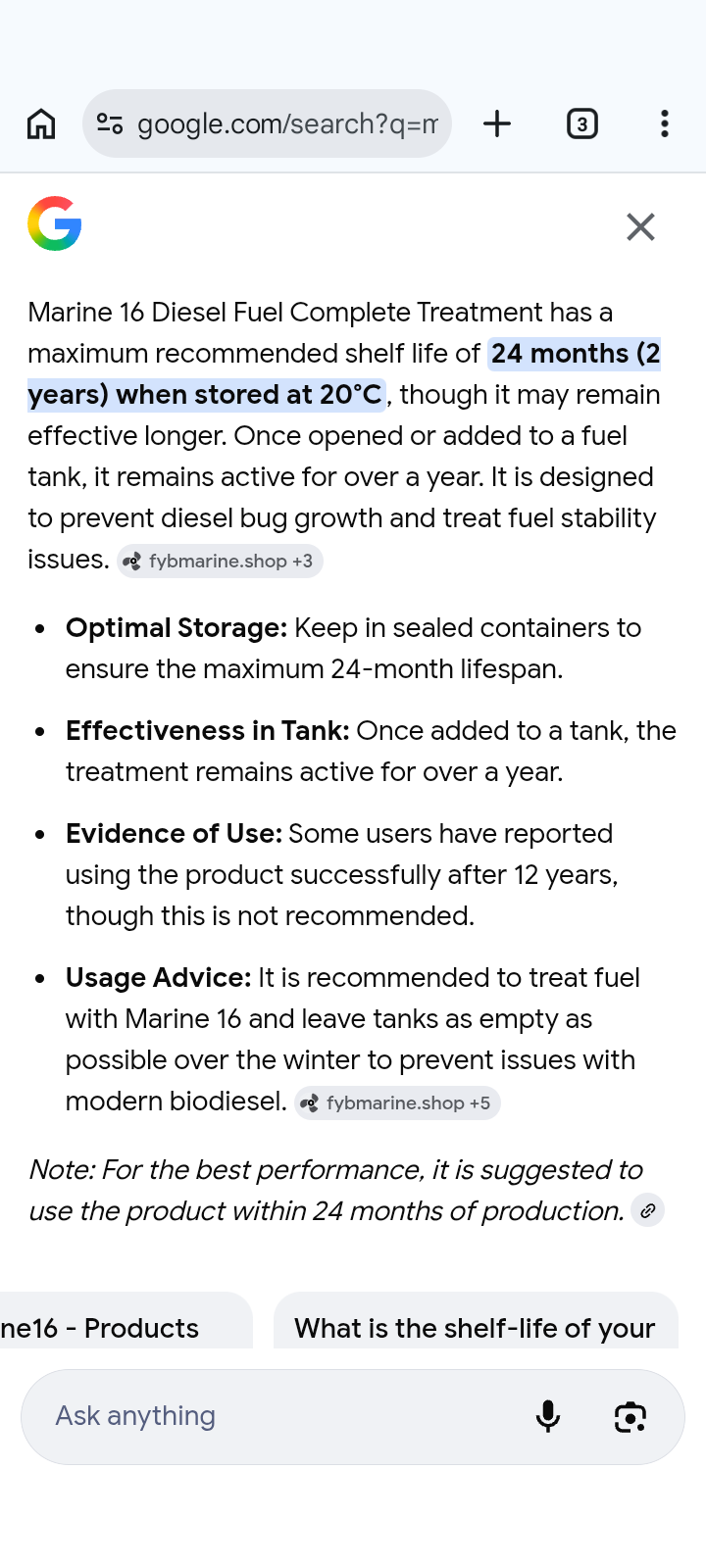

Where did you find the shelf life info? Because I used to have a larger bottle and as only filling up twice a year it lasted ages

ISTR that my bottle has a "use by" date stamped on the bottom.
I think marine 16 only recently added an expiry date.
Sounds like a good marketing idea.
I was just thinking that I don't remember seeing an expiry date on it

Can't remember exactly when I bought it, but it was the last couple of years and the expiry on it is this September I think.
A search suggests it was 2022 when they started to add an expiry date. So no so recently as I imagined.
Only the thread I quoted. Yes I got a bigger bottle, longer ago and it probably has no mark on the bottom. I regard the stuff as so toxic I'm loathe to invert the bottle to find out.
Then I came to wonder "can it actually expire or go off or get used up?" because it's hardly going to go mouldy is it?!
I guess some component may oxidise. The way fats can go rancid, even while in the freezer. It's not a biological process, just one that can interfere with biology.

Also, regarding Marine 16's shelf life, I had a half bottle turn into a dirty brown sludge after a couple of years sitting under cover outside.

Mine looks OK, now 3½yo plus however long it sat on the shelf.
Keeping it in the dark seems sensible, and I have not always done. Not to stop algae using the sun, but to prevent UV exciting bonds to split. The PET bottle is transparent to UV unless they added something to block that.
It could be better to buy  fuel additive in smaller bottles so as to avoid keeping part bottles in storage for long periods.

Manufacturing date states 14 November 2025 and expiry date 13 November 2028 so 3 year shelf life.
