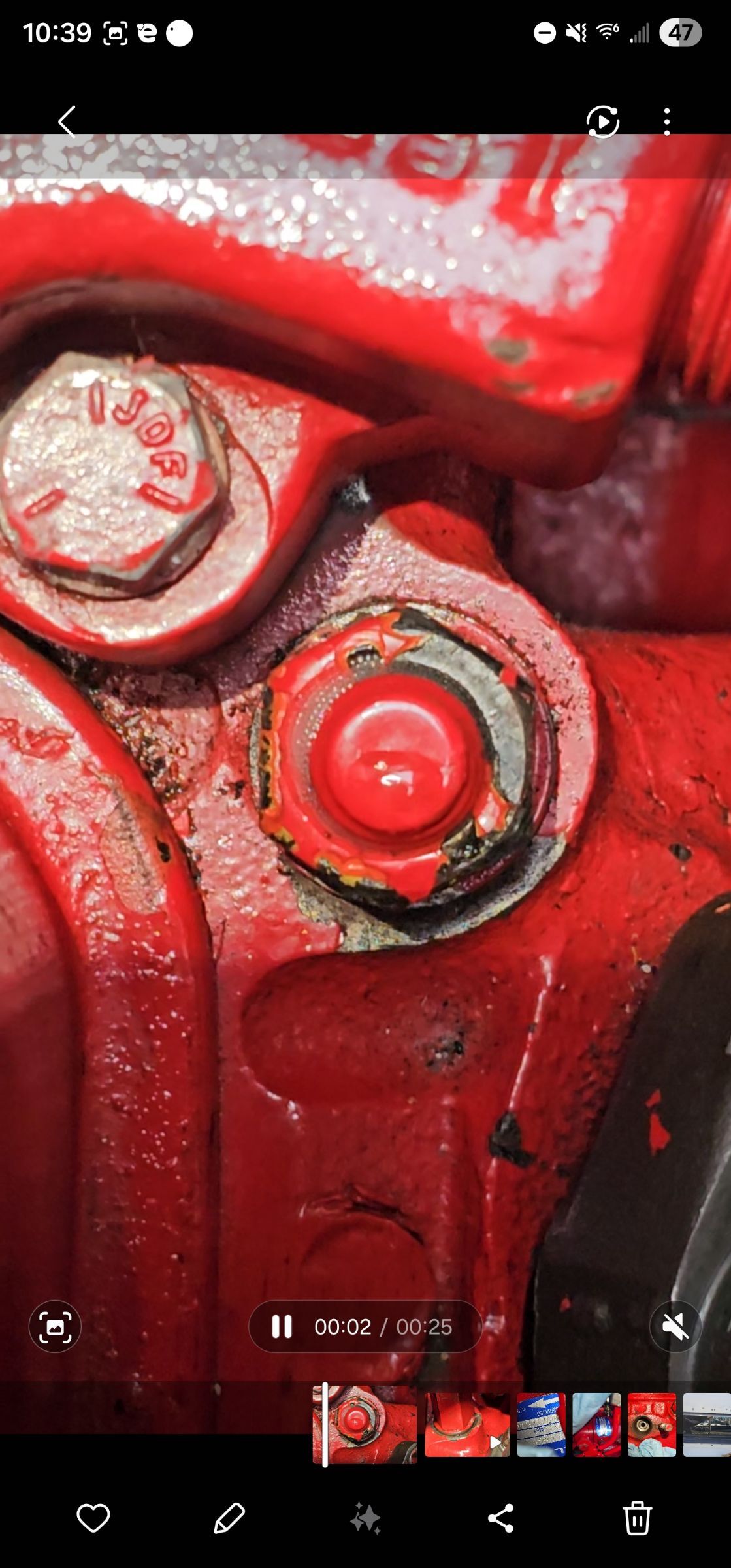

I've attached a photo of the bubbling for what that's worth.
Did you re-torque the head bolts under the rocker shaft - rhetorical question.
First of all, apart from the lumpiness, that might just be cold air/gas between the stud and hole in the cylinder head expanding when heated and escaping (bubbles reduce when hot) so the first thing I would do is try to give it a good high speed/power run to see if it overheats or the bubbling gets worse or stops.

Attached a photo about 5 seconds after moving it away from the bubbling bolt.

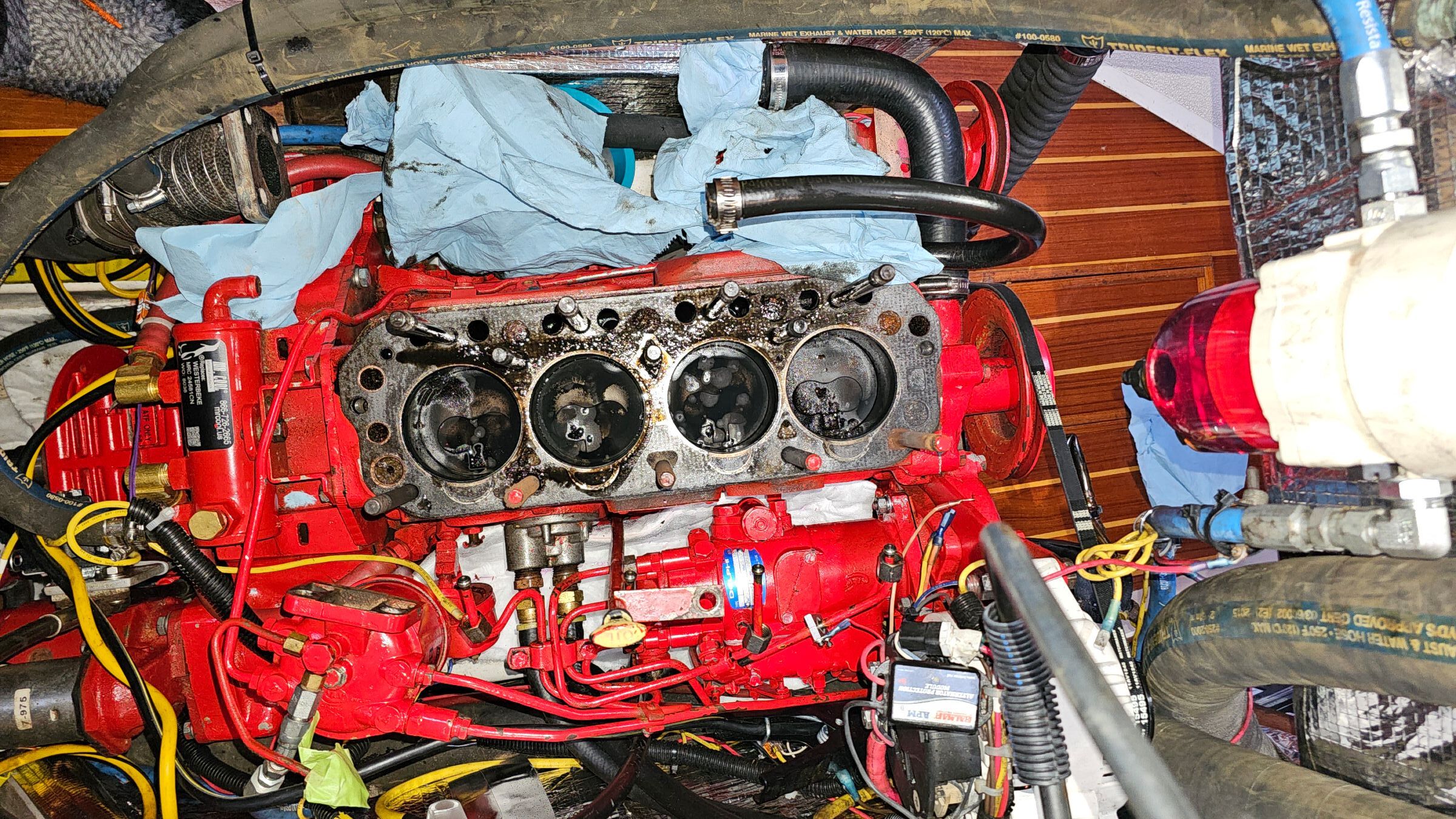

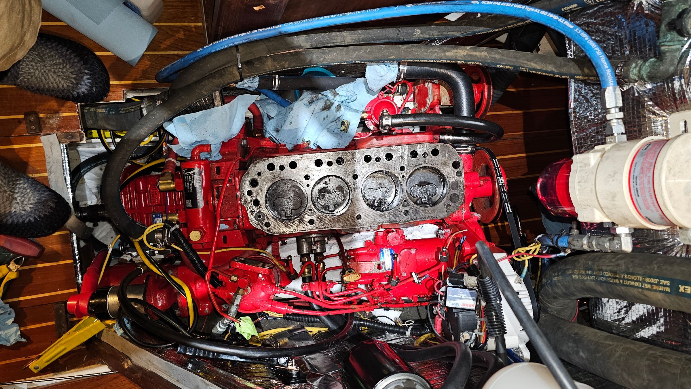

Okay head is off! things looks pretty good to my inexperienced eye. First photo with the old gasket in place and second with the gasket removed and first round of cleaning.
I'm planning on cleaning some of the carbon of the top part of the cylindars (the rest is smooth with evident cross hatching), but do I need to worry about any gunk getting between the pistons, rings, and cylindar wall?
I had assumed the oil/combustion will take care of anything small and large debris I'll vacuum up. But I have just seen some folks recommending to put thick grease on the cylindar / pistons to block anything from getting between the piston and cylindar. Have I endangered my engine by missing this simple thing?
Do not clean the full top of the piston, leave a ring of carbon around the top, say about 1/4" wide. This stops damaging any carbon build up between on the side piston crown that is said to improve the seal.
I have never greased the bores, but when using abrasive cloth to clean the head face, I always stuffed the bores with rag.
Edited to add: Within the details I can see in the photo, I can't see any indication that the bubbling around the stud was a failing head gasket, although photos give limitations. On the 1.8 the most common failure point is between cylinders 1 & 2 or 3 & 4, between 2 & 3 is less common. So well away from the studs.
Thanks Tony,
Well I hope there's nothing bad stuck between the cylindar wall and piston. I'll do my best to remove any debris and cover them for further cleaning.
I'm taking the head to a shop to get professionally cleaned and resurfaced so I'll let them worry bout the head cleaning parts :)
I agree there's nothing obvious but those bubbles had to be coming from somewhere. I think this has to be the last thing I check for my sanity lol.

I had a problem where a tiny amount of oil was escaping though a bolt thread on a crankcase. The tapping was a through tapping and the oil was following the threads. Threadlock solved this. Bearing in mind that I have no idea how combustion gas could get onto the head studs or familiarity with BMC engines and can’t claim much experience could putting a small bit of thread lock on the offending stud (the bit that threads into the block) be worth a try when you reassemble. I’m assuming you could use a low strength threadlock so that you can get the stud out again if you need to
It certainly would not hurt to do that, but the drilling for the oil feed to the rocker shaft is at the opposite end of the block, I think, so that seems less likely, but never say never.
The offending stud is close to the pushrod hole, but unless the crankcase breather was horribly blocked, I can't see that having any bearing on the bubbles.
Edited by Tony Brooks
Small correction the offending studs are close to cylindar 1 and between 2 and 3 on the opposite side of the push rod holes. There's not much over there except for some small coolant channels that seemed all much blocked. I gentally cleared these and will do a quick coolant flush when I'm done with this project.
