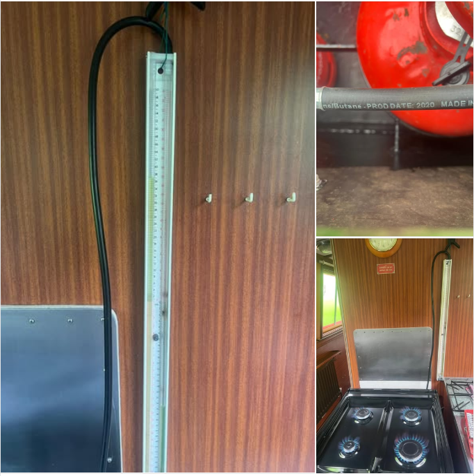

agg221 Posted April 9 Report Posted April 9 (edited) 1 hour ago, ditchcrawler said: Just popped up on FB My only question is why don't they make the hose to the manometer a bit longer so that it can dangle directly over the burner? Alec Edited April 9 by agg221
