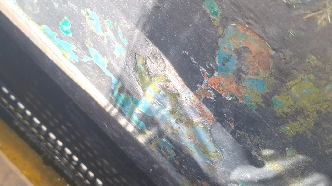

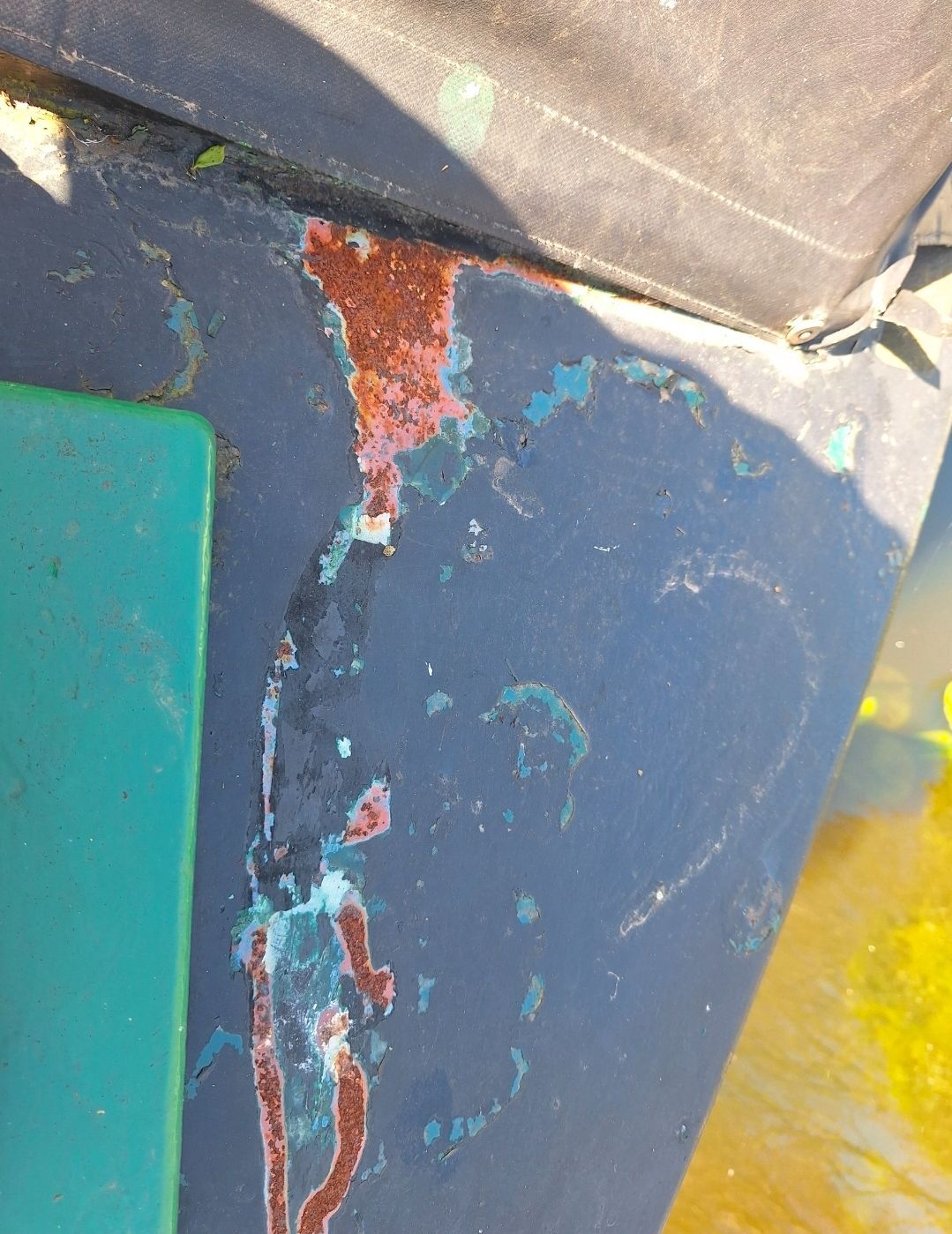

The bodge paint job on this boat, especially on the stern was peeling away in chunks like in the first photo and clearly just painted over old paint with no prep. I know this is a major job sanding back and doing properly. Can you do this sort of work DIY whilst in the water? (I'm thinking about the dust/debri pollution/or rules in a marina).
How worrying are the areas of rust like in the photos? Or just a case of sanding, treating and repainting?

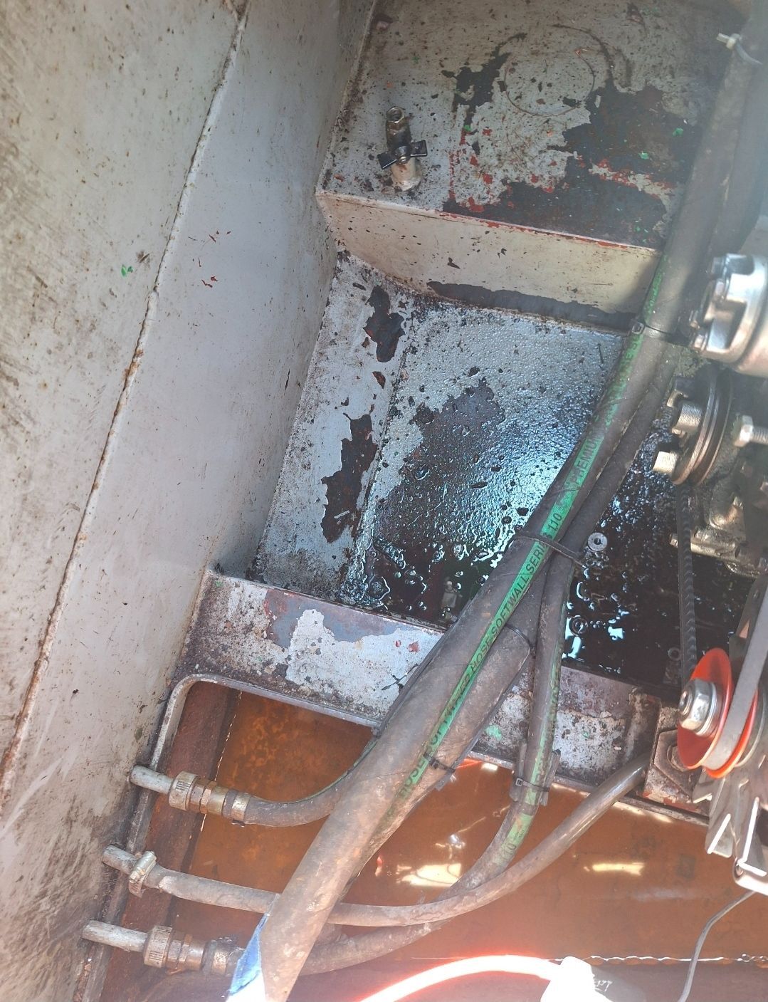

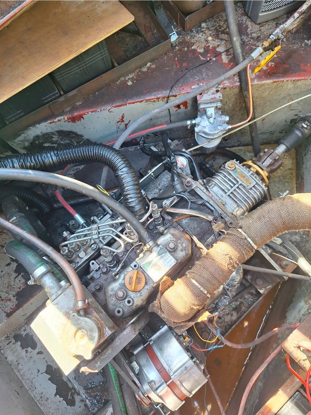

The ad said the engine had been overhauled this year. There was some water in the engine bay..The deck board was pretty worn and drainage channels full of crap so I expected some rainwater but it looked and smelt like it was mixed with oil/diesel, but I know very little about it. The engine started fine with a bit of white smoke.

Engine bay:
Screenshot_20260407_151839_Photos.jpg.3387597a4b46f2039f47471e59befbbd.jpgScreenshot_20260407_151926_Photos.jpg.efc910d646e31ff188706a06776c4208.jpg
FWIW the images around the engine area look as expected on an older boat and far better than many.

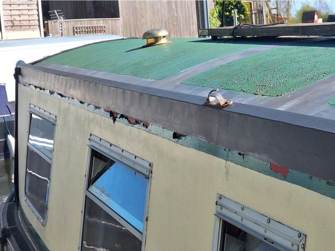

What does give me concerns is that black strip along the top of the cabin side, bridging the area where the cabin side joins the roof/handrail. It looks as if it is a separate piece of material (not necessary cloth, just something unidentified), and it looks as if rust is creeping down from below it. I wonder what it is hiding and why it was fitted. I wonder if it is hiding rust holes or something.
Looks to me like a black painted steel handrail and cream cabin side, both in reasonable condition.  But someone has overpainted the red coach line in green without doing the preparation first, hence the green is peeling off.
I agree. Better than most, although rusty on the side where the bilge water gathers - very common.
If you are correct, and you may well be, the marks/distortion along the top suggest that it has been tack welded along its length rather than continuousely and that would seem to be an ideal invitation for rusting.
I would be equally interested in what is going on under the "gritty green" patches on the roof.  I would  want to do a  good check that they are adhering all over and that there is not water trapped beneath them.
An in water repaint is feasible.  The big job will be removing all the old paint for which a scabbler, Tercoo rotary blaster or a needle gun are the tool of  choice.  Forget main removal with sanding discs/belts unless you have a lot of time.  You will still need them for corners etc.  Modern tools come  with dust extraction -you must use it.  Scabblers stc produce chips rather than dust and this can be captured with a vacuum cleaner hose.
Working outside,  plan to do small sections and get a non-porous primer on as soon as possible after paint removal, cleaning up and treating any rust.  Same for top coats, but organise good, windless, weather🤞. Insects will be a fact of life.  Brush off the ones that stick, touch up after any that crawl.
If possible, rent a wet dock for the job- allow 4-6 weeks overall or 1-2 weeks for just the finish coats.  After the big paint clean-off at the start you will spend much time waiting for paint to dry
I'm not sure I Agree with David.
It looks far more than an added extra layer or two of paint peeling off.
I read it as severe rusting of the underlying steel, quite likely involving some pitting.
The complete grab rail structure seems weird to me, as overall it projects out beyond the cabin sides.  I'm happy to be corrected, but I don't think it is standard David Piper construction.  I'm not even convinced it is original to the boat.
I can't place why I think this, but additionally the windows do not look to me typical of those usually found on Piper builds.
What it sparked in my mind was the way early Liverpool boats had separate cabin sides and roof, with the roof folded down over the top of the cabin sides.
  • Sad 1
The baseplate is unlikely to be a single sheet of steel, so there are transverse welds across the width of the boat joining the individual sheets together. Budget boatbuilders weld these from the top only, which will leave a visible gap on the underside if there is not full weld penetration. I assume this is what the surveyor has spotted.
