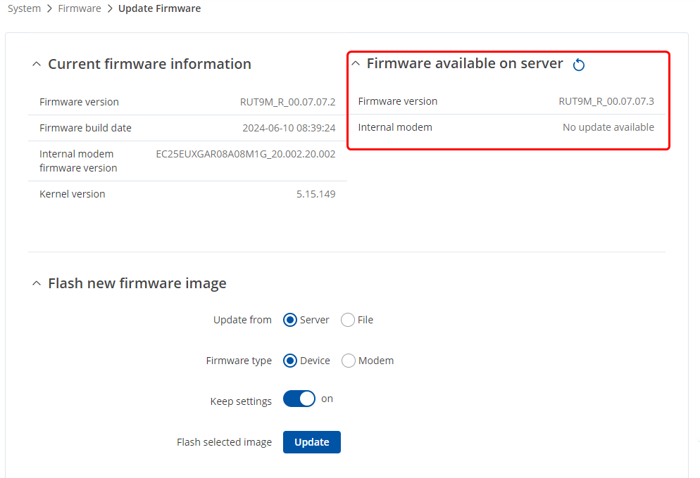

Thanks for this, so its not the usual updates you get - mine is on RUTX_R_00.07.21.3. I'm not sure how I would update the other one?
If you click the Modem button under Firmware Type, and it shows there's a modem update available in the red box, you can update it - modem firmware can only be updated over the air though, not from a local file.
Generally it's a good idea to keep the modem firmware up to date as 5G standards and networking are still changing all the time, but this is an exception!
1 minute ago, robtheplod said:
Is this in the RMS or direct to the router?
Direct to the router on web UI. I think modem firmware has been moved to its own tab though on versions above 7.20 so that screenshot may not be accurate actually...
fab thanks... I'll just keep well away, although fortunately locally we only have 4G so should be ok..... :)

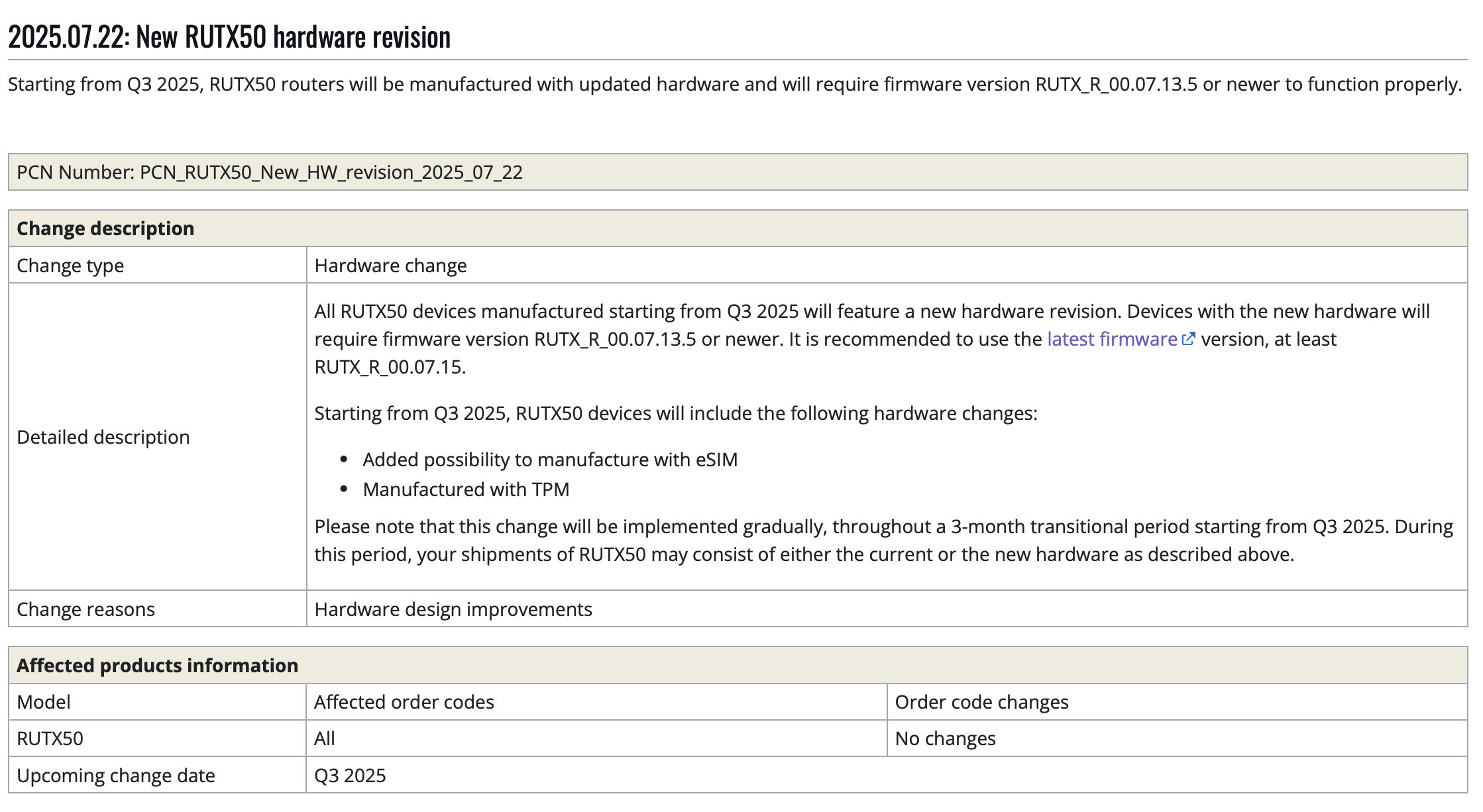

I'ea RUTX50, not on that modem firmware version and am up to date. How do you know what type of modem you have as the Op mentions Quechtel RG520.
Edited by JoeC
Login to the web interface and should be under the Network -> Mobile tab
As far as I can tell, it's only the newer hardware revision RUTX50s which have the RG520 modem, since late last year. You probably have an older hardware revision with a different modem.Screenshot2026-04-08at11_35_04.thumb.png.9023ca3ff0b70b6ecd55579a28939d44.png

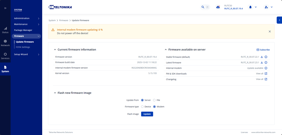

On my RUC50, I was able to successfully update the modem firmware through the WebUI. It appears that Teltonika has released an updated modem firmware version that fixes the 5G issue.
To perform the update, I navigated to:
System → Firmware → Update Firmware → Modem Update
The modem firmware update completed successfully, and I got RG520NEBDCR03A06M4G
Yep, upgraded yesterday too, seems to have fixed the 5G problem! Took over a month for the fix which was frustrating - it's possible to downgrade the firmware as someone on the Teltonika forum demonstrated, but that wasn't adopted as the official workaround.
