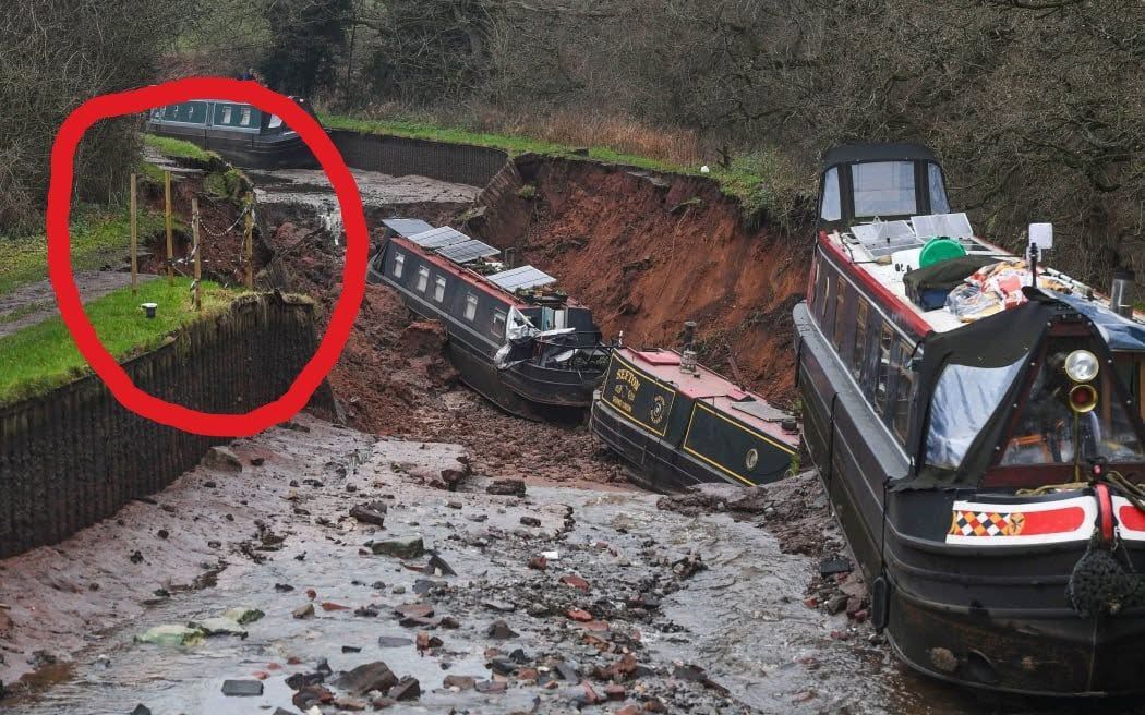

Or maybe this had some hand in the breech -
That's the cordoned-off hole in the towpath @magnetman mentioned multiple times as a possible cause, right back at the start IIRC.
#33
Wouldn't you then have thought that the breach would have occurred there and it would have disappeared, not some distance further up so it got left behind?
Yes and he was right.
In its initial report into the breech, CRT said the type of void in the photo could be a possible cause. It went on to claim that the towpath side of the embankment did not have any defects. However, a Principal Inspection earlier in 2025 records a known void at this location which had not been repaired ...
The Principal Inspection report also records that piles over a 200 metre length on the towpath side (which includes the breach site) were to be replaced in 2027. Again, this is not mentioned in CRT's initial report.
Since the embankment breached on the offside, its difficult to see how a defect on the towpath side could have initiated the breach or had any significant impact on the subsequent escape of water and washout of much of the embankment and bed.
#37
Except perhaps in the minds of anti-CRT posters looking to lay the blame on CRT... 😉
Edited by IanD
#38
There is a concept in civil engineering called 'tunnelling' IIRC, (no not that sort of tunnel) where even the tiniest trickle of water finding its way somewhere unexpected can open it out into a big enough tunnel to collapse a hillside nowhere near the start of the trickle. All IIRC as explained by MM.
#39
David Mac,
I suggest you read CRT's initial report but in brief they suggest that piping over time caused a large void to form under the bed of the canal. It was collapse of the canal bed into this void that initiated the sequence of events that led to the breech (rather than the defect). The defect on the towpath side was visual evidence that piping was happening.
Piping is term you are searching for.
Edited by Allan(nb Albert)
#40
Piping
YES!!!!
#41
19 minutes ago, MtB said:
YES!!!!
Except that still doesn't prove that the towpath hole being pointed at caused the breach, which is what people keep suggesting.
It means that *if* piping was happening -- and *if* it was happening on both banks, which AFAIK there is no evidence for -- then the hole on the towpath side might have been the early-warning canary in the coalmine, *if* it was caused by the same piping that caused the breach -- not by any means certain since one is at towpath level and the other probably at the bottom of the canal.
That's an awful lot of *ifs*... 😉
It's also possible that there was no causal link between the towpath hole and the offside breach, which was caused by penetration of water down through the canal bed, and that there's no effective way of spotting this before it suddenly starts to leak water fast, and probably then breach within a few hours.
The fact that the breach destroyed any evidence of what actually caused it means this is all speculation; serial CRT-haters like @Allan(nb Albert) can try and keep on pointing the finger of blame at CRT based on nothing more than "it's all their fault, here's what might have happened", and all CRT can basically say in response is "this is what might have happened but there's no way to prove it either way".
Edited by IanD
#42
The real question that arises here is why did CRT claim in its initial report that no defects existed on Embankment 1 (i.e. towpath side) when this is clearly not the case?
... and why was no mention made that it intended to replace 200 meters of piling next year?
