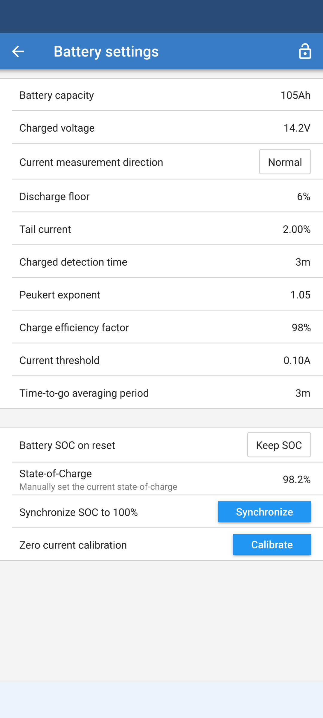

Yes ok the majority here were telling me to use voltage.
The problem is that SOC on my battery monitor tends to indicate 100% far too early while battery voltage suggests it's much lower.
In which case your monitor is set up wrongly.
Mine is spot on.
Try these for a Victron monitor
Obviously the battery capacity is different
Edited by GUMPY
If you post the settings of the BMV, I can comment and suggest.
