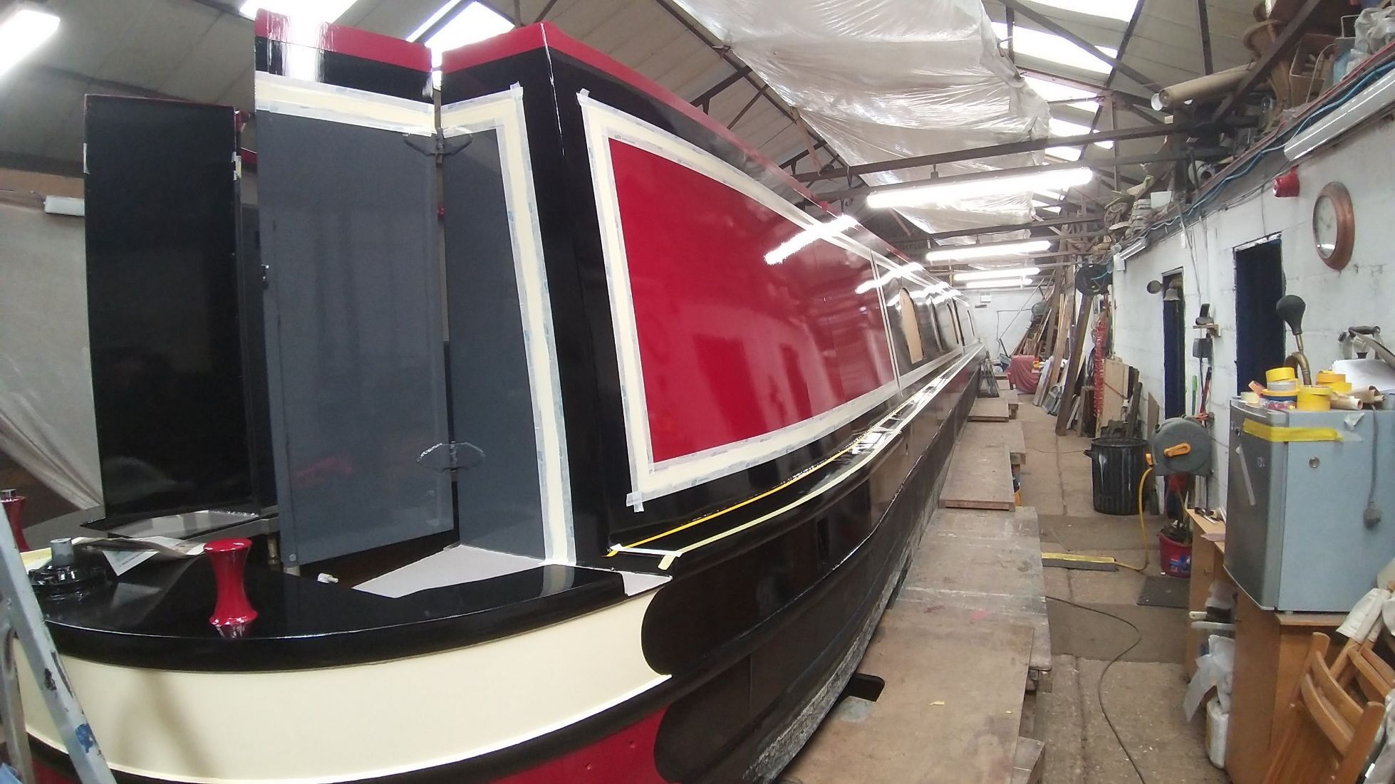

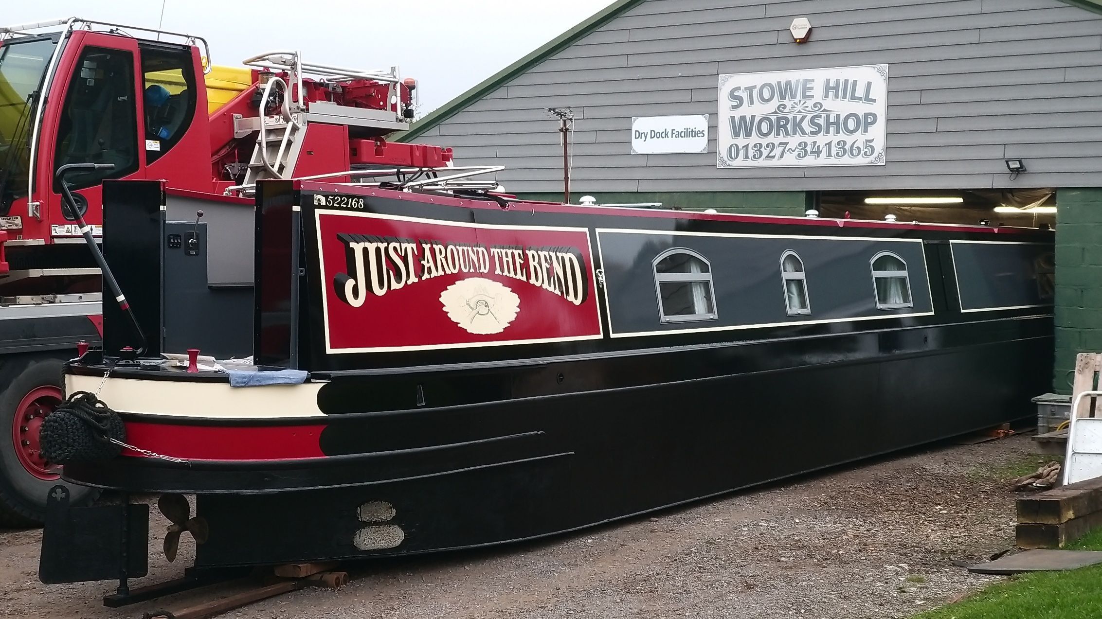

matty40s Posted March 24 Report Posted March 24 (edited) 3 hours ago, Sid Charles said: Matty It is a sort of plum colour, deffo not post office, what is Ayers? Ayers is too light then. This boat has Bounty red, very popular at present. Any darker than that and you are in the Plum, Maroon, mercedes red territory. Edited March 24 by matty40s

Sid Charles Posted March 24 Author Report Posted March 24 2 hours ago, system 4-50 said: This ^^^^ Whatever the shade you buy it won't be that shade for too long. imho. … I do still have quite a bit of Buckingham green available 😁😁😁 I'm only painting the panels in this colour 2 hours ago, matty40s said: Ayers is too light then. This boat has Bounty red, very popular at present. Any darker than that and you are in the Plum, Maroon, mercedes red territory. Matty, that is close but like you say darker and you are into maroon, that paintwork is lovely The charts which Tony Brooks sent are very helpful, I seem to be drawn to Deep Plum or Loganberry, but would love to see them in the flesh, so if I am using roller and laying off with a good brush is it a coach paint I'm looking for, do you think Craftmaster could mix me a colour, I like their paints.

Sid Charles Posted July 19 Author Report Posted July 19 On 24/03/2026 at 12:11, matty40s said: Ayers is too light then. This boat has Bounty red, very popular at present. Any darker than that and you are in the Plum, Maroon, mercedes red territory. Going back to paints, I decided on Crimson Lake and Graphite grey; however, today I did a test patch with the grey and it's far too dark, what is the grey on this boat, it looks a great job by the way. 1
