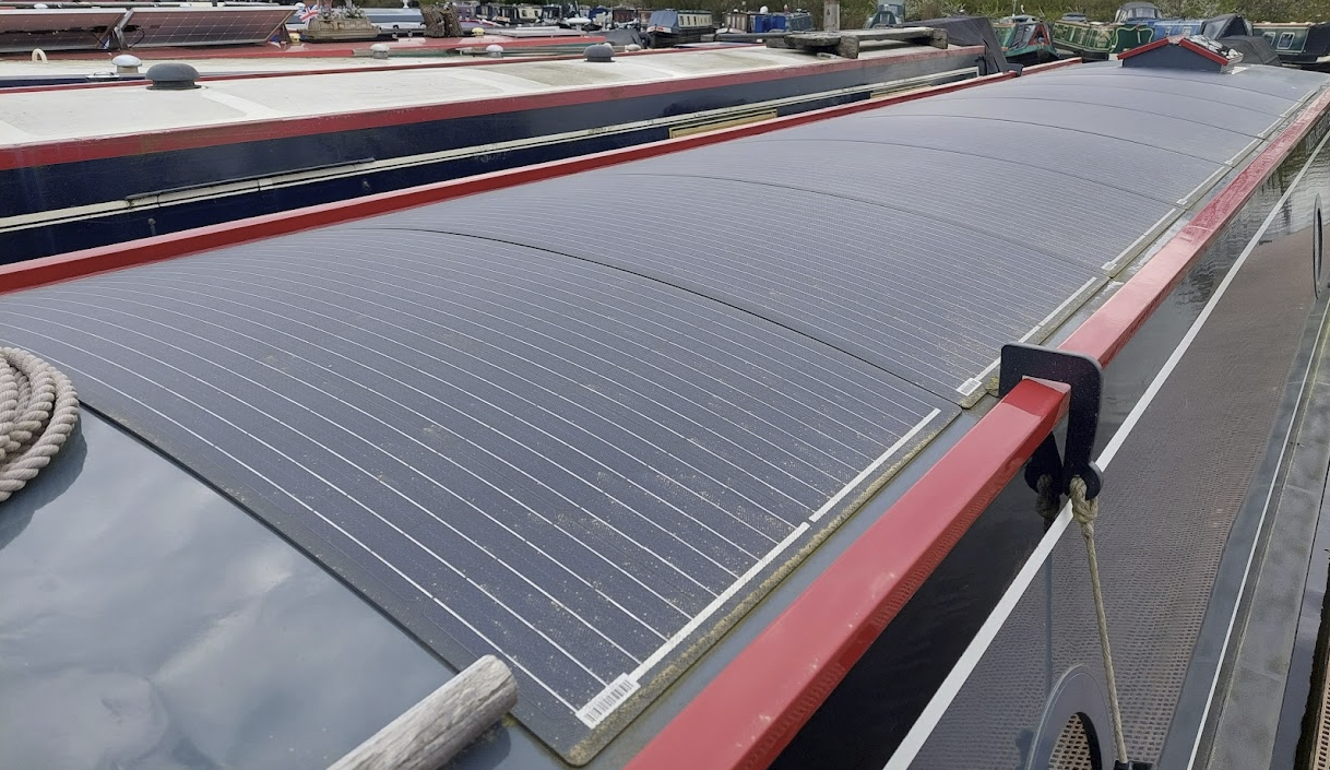

For an example of what can go wrong with semi-flexible panels, here are pictures I took this morning of two boats built by the same builder in the same year (2023) with two different batches of the same panels from the same supplier.
The delamination is obviously a manufacturing fault, almost certainly some failure in process/quality control. I have been told that other boats and boatbuilders have also sometimes seen the same problem with these panels, which suggests it was *not* a one-off problem with one batch.  The problem is not even an entire bad batch, I have 13 panels all from the same batch (adjacent serial numbers), 2 are absolutely fine (like the first picture) and 11 have completely delaminated, the top protective film has lost adhesion and can be simply lifted off, as my hand shows... 😞
OTOH I also know there are boaters out there with the same panels on boats more than 5 years old with no problems (and the other boat I photographed) -- and also boaters who have had similar delamination problems. I'm not willing to trust that the manufacturer has found out what the problem is (I believe they deny that one exists) and has fixed it (especially since they're only offering a 12 month warranty on replacements), and don't want to re-enter the good/bad panel lottery -- so am going to replace them with rigid panels even though this is a major PITA.

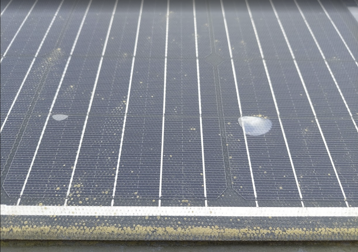

The worrying thing is that until the panels fail they look absolutely fine, and the progression is quite rapid -- as I said, over 3 winters I went from 13 good to 8 good/5 part-fails to 2 good/11 complete fails, but the boat near me with the same panels fitted a few months earlier has no fails -- well, one significant bubble on one panel, see photos. Will my remaining 2 also fail if left? Will theirs start fail over time or stay good? What would replacements do, stay good or fail?
No way to tell, until they fail they look exactly the same... 😞
