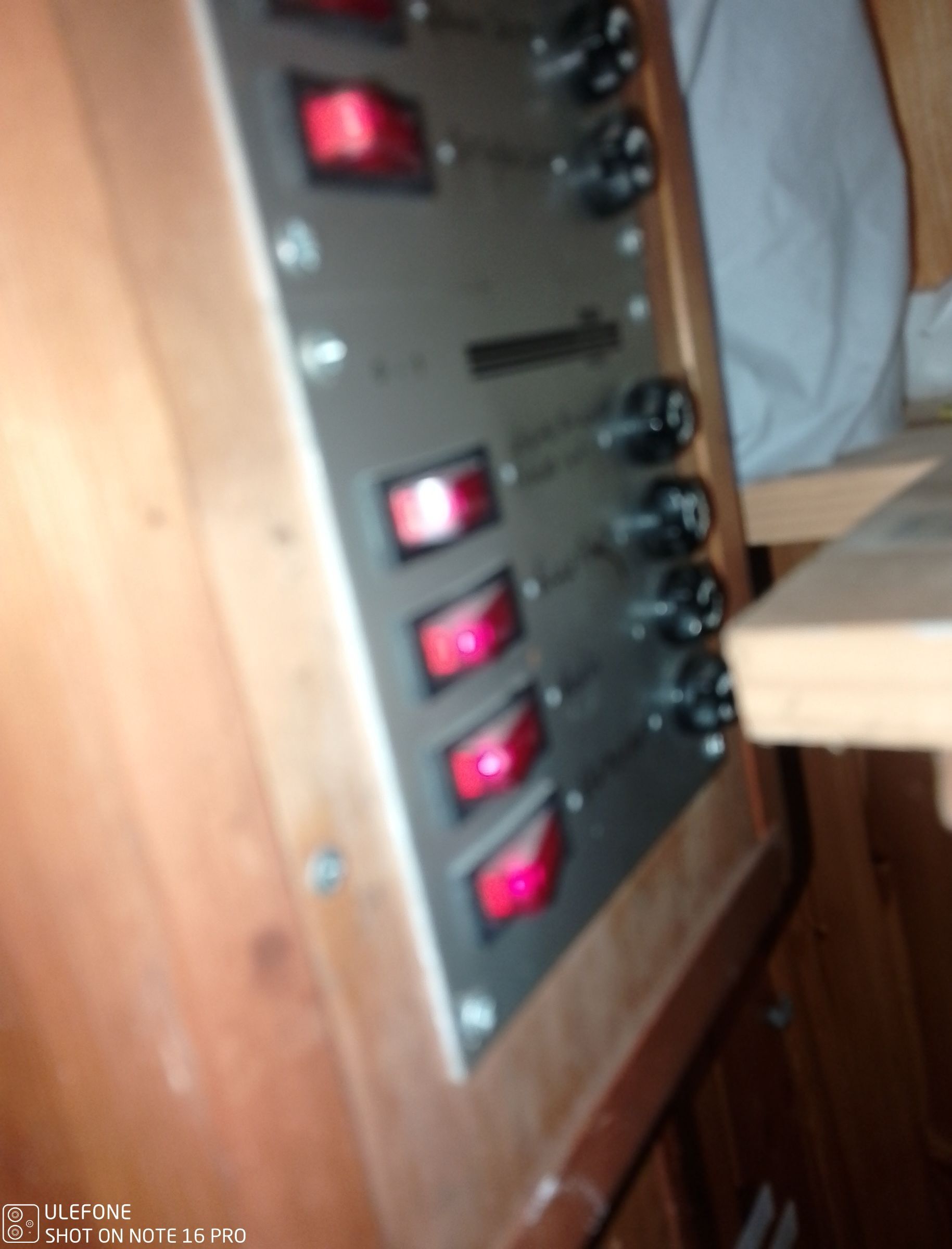

Tony Brooks Posted March 21 Report Posted March 21 1 hour ago, Memories said: The picture below is my fuse panel there is no other switch for bilge pumps except on this panel, it is lit but that doesn't give me confidence The fact it lights up when you turn the switch on only says that you have 12V+ to the switch, it does not mean that the switch is connecting the 12V to the output terminal, although to a degree it might be depending upon the way the switch is wired. I don't see how you can now avoid looking behind the panel to ensure output wire is on the switch and then try to follow the wire to see where it goes and what it connects to - if anything. Bilge pump bodies tend to be white with blue or red "trims". I think that you need to bite the bullet and go looking for it, you might just find a loose wire hanging in the bilge and no bilge pump.
