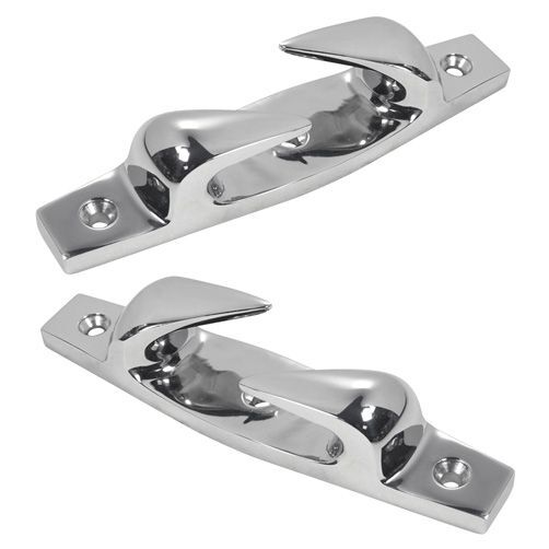

Having 'bashed' a fair-lead for center line, port side; I now have a new set, LH and RH.
Question please, what makes the difference between Left Hand and Right hand, and why?

 You perhaps, for leading the centre line, have got symetrical ones, not shaped R or L ones.
All you need is for the fairlead to keep the line from sliding bacl and forth on the roof edges/handrails.
If you look at these 2, the top one is the port one, which naturally let's the line go from the centre point, and then bend without stressing the line, to the rear of the boat.
The bottom one likewise does the same on the starboard side.
The pointy bit over the line holds the line in the fairlead.

I know that, but it seems to be an uneccessary complication when basic non handed ones would be easier the get the line in.
If you buy 2 sets you can put a l/h and a r/h on the port side and use one for when the centre line goes to stern and the other for when centre line goes to bow
It depends on the size/type of line and how/when you use them, but if it is easier to get the line in then it as also easier for the line to jump out.
