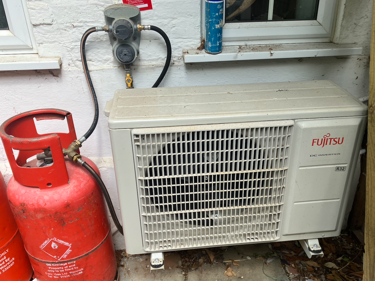

I installed exactly this in my hovel about three years ago. It was an interesting exercise but rather than spend £1,300 on getting the F-Gas ticket myself and spending £5k on all the gear to go with it, I asked a local air-con firm to evacuate, charge and commission my new system. They charged me £200 which seemed too cheap as it took the chap about three hours, plus the gas.
Both the inside (floor standing) unit and the outside unit are quite large and would take up a lot of space on a narrowboat.
Here's the outside unit. That's a 19kg gas bottle next to it, for scale.
