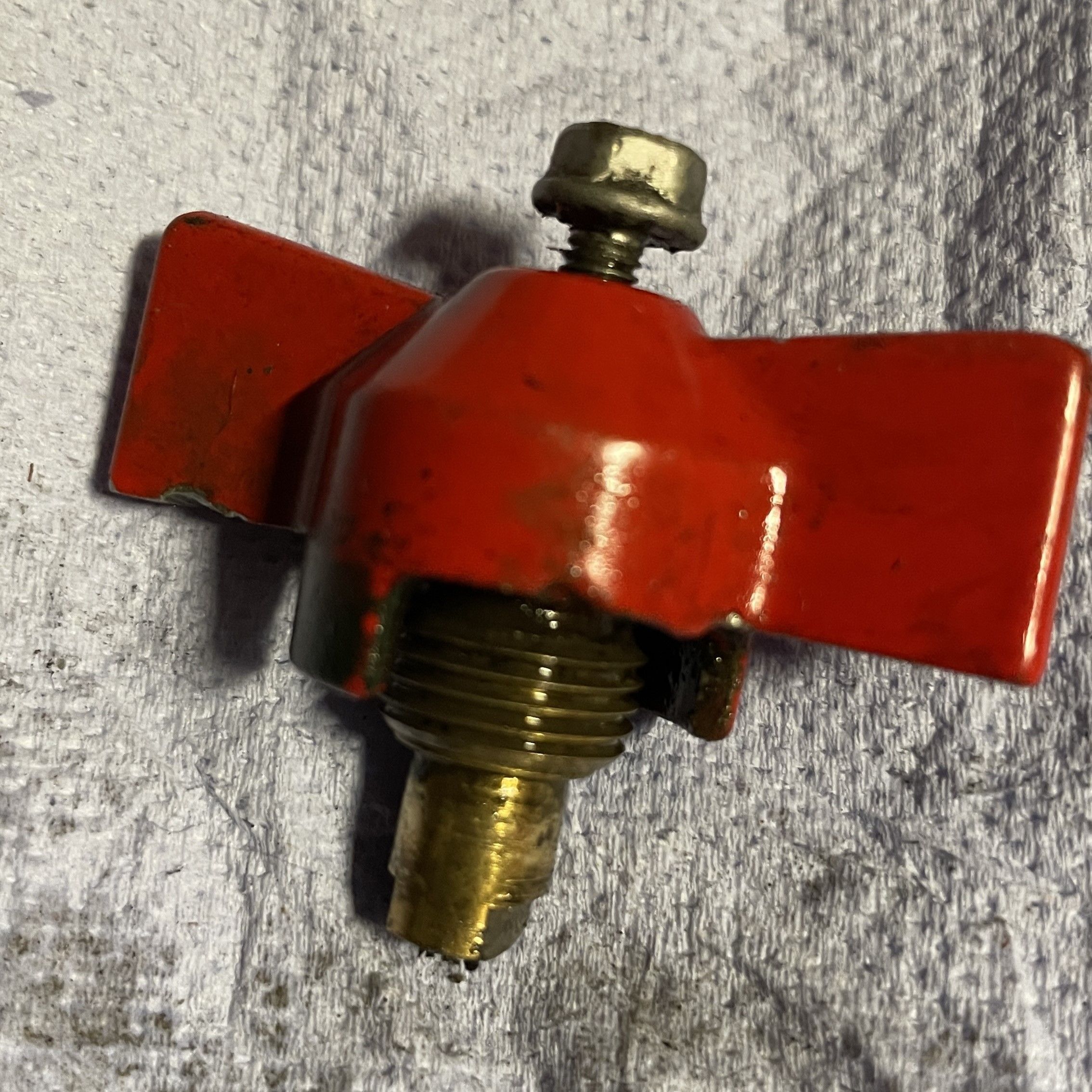

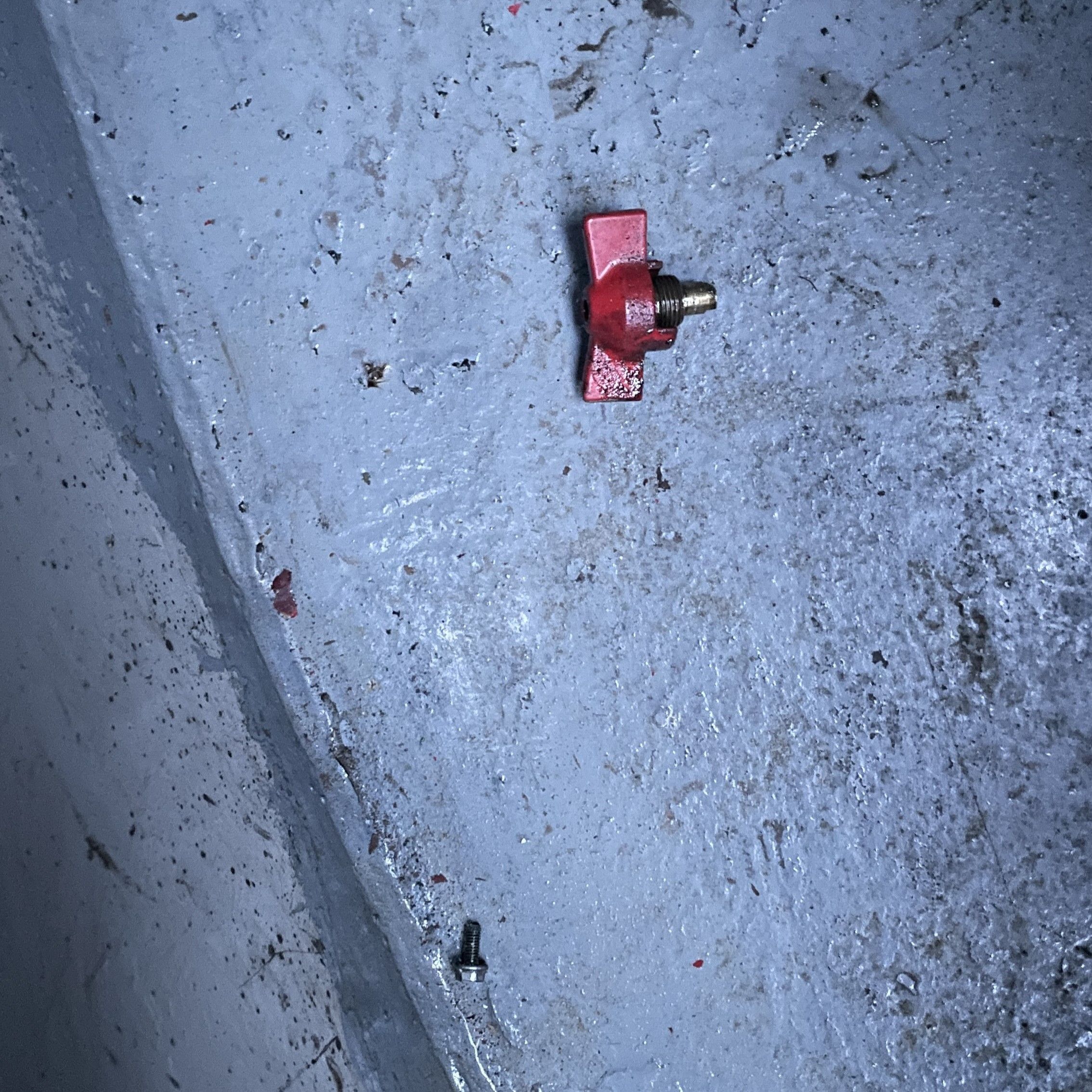

I'm a new liveaboard, and all has gone well with about 30 hours of cruising so far. But after cruising yesterday, I found this wayward part lying in my bilge! I've no idea what it is, though I'm thinking it was something loose that fell off the port side of my Beta 38. The tip is a bit oily/greasy, and it's on the opposite side of my batteries, so I don't think it's anything electrical (like a battery isolation switch). I also recently repainted the bilge, so I'm confident this is new, as I would have noticed if it had been just hiding in the corner. No new leaks from the engine.
Any ideas?
Looks like the knob, and part inner works of a liquid valve.  Look first at the oil sump pump as they are often fitted in the suction line to choose between engine and gearbox.
Otherwise, follow the fuel pipes from the tank to the engine and then the other pipe, from the engine to the tank.
Findcwhee it fits before running the engline again as its absencd is likely to allow a lsrgish fuel or pol leak to build up.

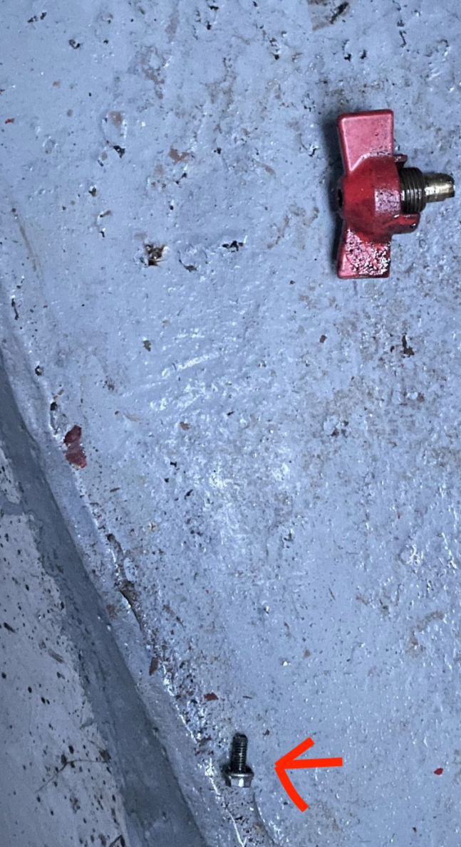

That is the screw wot holds the red bit on.  It is shown, in the right place, but loose,  in the OPs second pic.

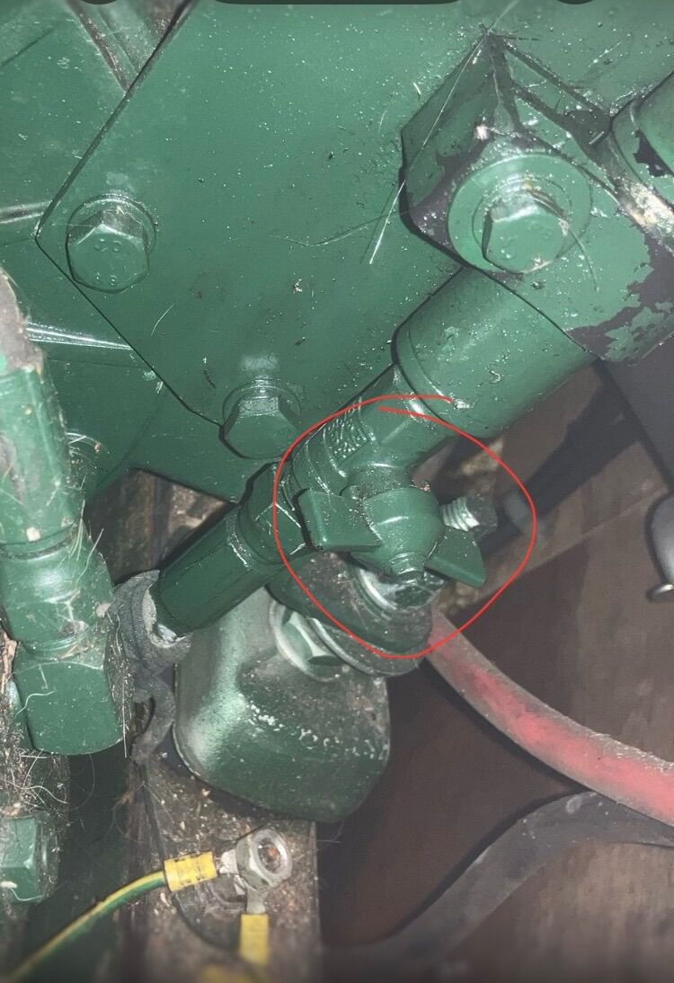

It does look like that. If so, it is a long way up from the sump, so there should be minimum leaks with it fallen out.
@tcp13 Is the engine painted red? Beta tend to spray paint everything on the engine/gearbox package the same colour. Green for keel cooled, red for wet exhaust. Older engines tend to be red.
Almost certainly the valve on the sump pump. It should have been closed before it fell off (you only open it to pump the oil out) so no harm will ensue (until the next time you want to change the oil) but it is a simple matter to screw it back on again to the valve, which is below the T handled sump pump near the rear of the engine.

Looks like it is on the other side for a Beta 38 vs our Beta 43

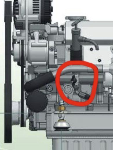

10 minutes ago, BoatingLifeUpNorth2 said:
From a Beta 43, leading up to the sump pump.

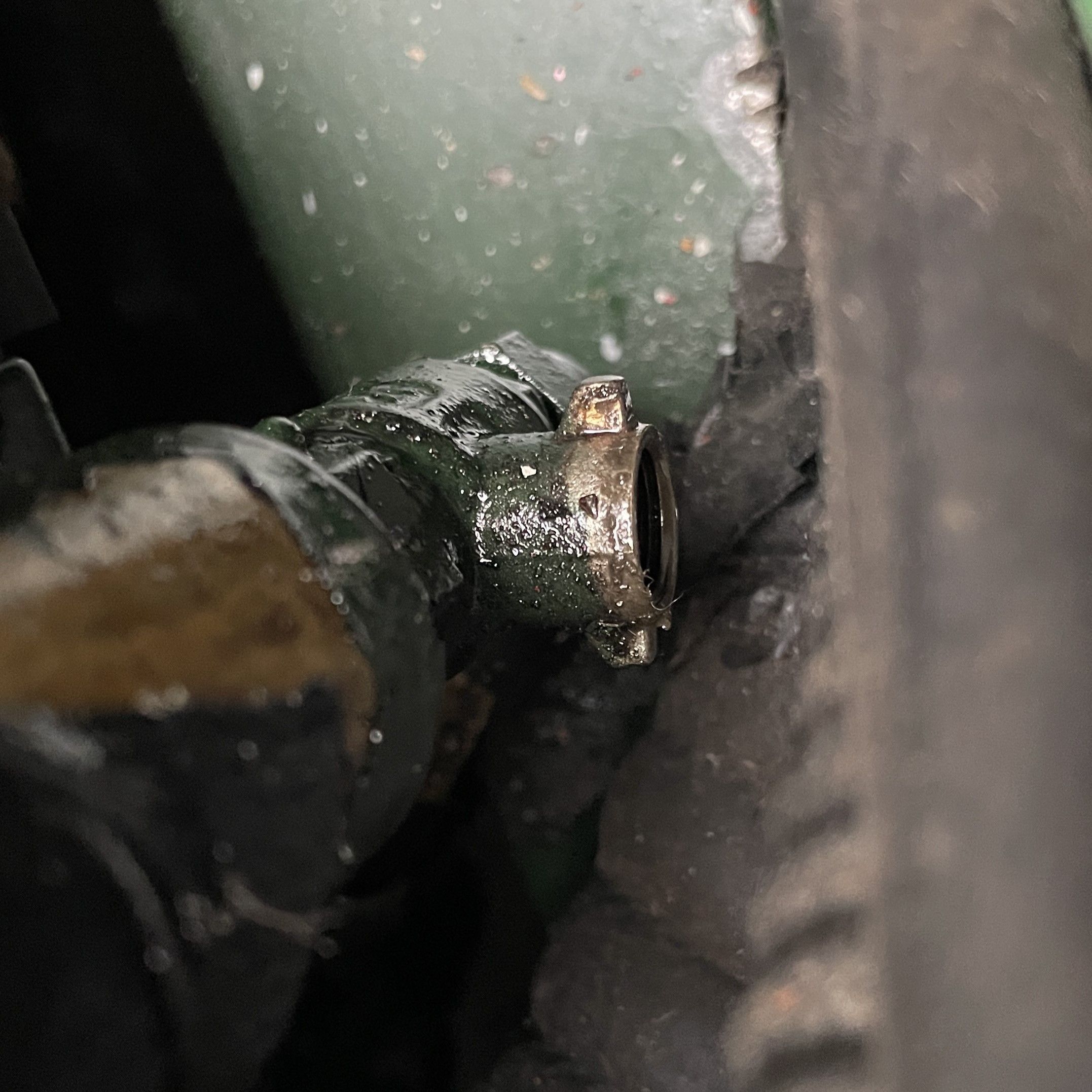

Thanks everyone for the sleuthing. It is indeed a valve leading up to the sump pump, the hole for which was hiding behind a run of cables.
I'm still working out how to reseat it, as the "wings" on either side of the port prevent it from being screwed in all the way... perhaps that's how it fell out to begin with.
I would suggest that f you take the screw which may have now fallen out a s per the photo out, you can then pull the red knob off. I bet there is a hexagon under it to tighten it back into its fitting. then replace the knob. If no hexagon, then I expect there is a shank that you can put some grips on.
A red handle on a green Beta engine, after all that.
Those wings are to limit the travel of the knob to 1/4 turn or whatever (i.e valve open and closed). I think you probably have to screw the brass core in first, then fit the knob and secure it with the machine screw.
