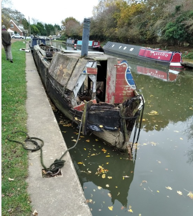

Having now seen the pictures I reckon expanding foam would have enough pressure to push the transom off.

1 hour ago, Chris Yearsley said:
I'd not thought of that. It's an (Enfield?) outdrive ("Z drive"?). I was wondering how we could have caused so much damage when pulling away from the bank, without noticing it. And the damage goes high up. I wasn't on the boat much on the voyage as I worked all the locks and often got off at narrow bridges to help push away in case my daughter's rather uncertain steering caused issues. She did say that at one point the boat seemed to hit something underwater, hard, but keep going. And there's certainly an old repair inside that corner - so it's weaker than it was designed to be.
The pictures below show the (lower part of) the damage now, amd how much better the boat looked when my daughter bought it. She has been tremendously upset thinking it's all her fault, but if the boat had a weak repair, and then the outdrive hit something, then could it just be tremendous bad luck? I thought I'd read that the outdrive was supposed to kick up if it hit an obstruction, but it's very old and if it's corroded maybe it doesn't move like it should?
It leaks much more when the engine is running. Even with a patch repair I don't want to take it far at all.  Caggys yard is 9 miles, if they get back to me with the ability to help that would be best. For the in-water patch repair, and also the dry full rebuild of the damage, these guys are very friendly and helpful, I just need to find a way to get it dry somewhere for them to work on. Probably not cheap but I'm beyond being fussy and I think this is a problem that needs good, then quick, as the priorities. https://wrcomposites.co.uk/repairs-and-modifications/
1. I don't think the damage is anything to do with you. I think the reason the boat looked so well is that it had been bodged with some kind of filler, possibly ordinary car body filler, that has now fallen out. A large chunk of something bodgy seems to be missing now.
If the outdrive did hit something in ahead than that could cause the bodge to fall out, I don't think there was ever sufficient preparation before bodging.
2. I think that every time you go between ahead and astern that corner of the transom will wave about and as engines vibrate I am not surprised it leaks more when the engine is running. My view is, in view of the depth and extent of the damage, that none of the adhesive and filler/putty type suggestions will work.
3. It looks to me as if there was an attempted glass repair on the inside of the hull, but not very well done because it seems to radiused, instead of a pretty tight right angle, and it looks as if the glass mat was never properly wetted out with resin.
4. If you do decide to re[air it yourself I think the inner glass bodge needs to be cut off, and possibly metal angles bolted across the gap inside to give the repair some mechanical strength. Possibly three about 2 to 3 inches wide. Then glass over the whole lot on the inside with several layers of mat. hen cured that should stabilise the area so you can grind chamfers on the rough edges of the crack so you can push more well wetted mat into the gap and over the chamfers to give it a larger "gripping area". Then smooth and apply epoxy filler or gel coat. It will be the inside glassing that gives it strength so put the glass mat over at least a foot either side of the crack - more gripping area!
Having written all that I suspect the least cost and probably the best option is to scrap it, if the engine is any good you MIGHT get it done for free, but expect to pay, get quotes

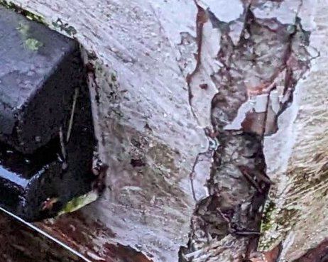

The second photo shows that the internal structure of the corner is in pretty poor condition, so it won't have taken much of an impact to cause the increased damage between the two pictures, especially with vibration from the engine/outdrive.

Having seen the picture I would imagine the transom will need cutting out and repaired properly- the core will be probably be mush now. There will be vids up on YouTube which will give OP some idea of whats involved and how its all made..
28 minutes ago, PaulJ said:
Little confused on comments about the inside as I couldnt see any pic of the inside though.
If you look into the crack, just above the side rubbing band level, you can see what looks to me like part of a roll of glass mat, I don't think it is a roll, I  suspect it is a previous internal repair that has not been forced fully into the corner of the hull. To me, it also looks as if the visible area had not been fully soaked/mashed with the resin. That in itself could allow water to pass through the new layup. The OP also mentioned that there are sings of an internal repair.
Here:
I agree the transom may be rotten inside if it has a core of some sort meaning the whole lot may need replacing, as you say, but if that is the case I doubt it makes any sense to pay to get it done. So DIY or scrap it. If they do decide to DIY it, then making the best of a bad job and not taking the transom out, is likely to be good enough for a few years.
Here:
Ah yes.Thanks. Totally misunderstood.
I took it all as inside the boat and not inside the crack 😀

The other thing we do not know is how far below the waterline that crack runs, I fear it may be a fair way along the bottom, caused by that outer corner flexing as it as/is not properly secured. It has to come out of the water, and it should be liftable onto a truck equiped with a Hiab anywhere the truck can get sound ground close to the canal. But that in itself is going to cost, probably over a grand seeing prices quoted here.
If running the engine gives significant water ingress, or even worse shows signs of the crack extending, then bow haul it. A 27ft GRP boat shoildn't be too difficult. You just need to know where to head for.

My guess would be that at least some of the leak is actually coming through the (outdrive) transom plate especially when under load.
IF its as mushy as I would guess it is then there is nothing keeping the transom rigid- effectively its two layers of GRP with some sponge in between. No way of keeping that sealed..
