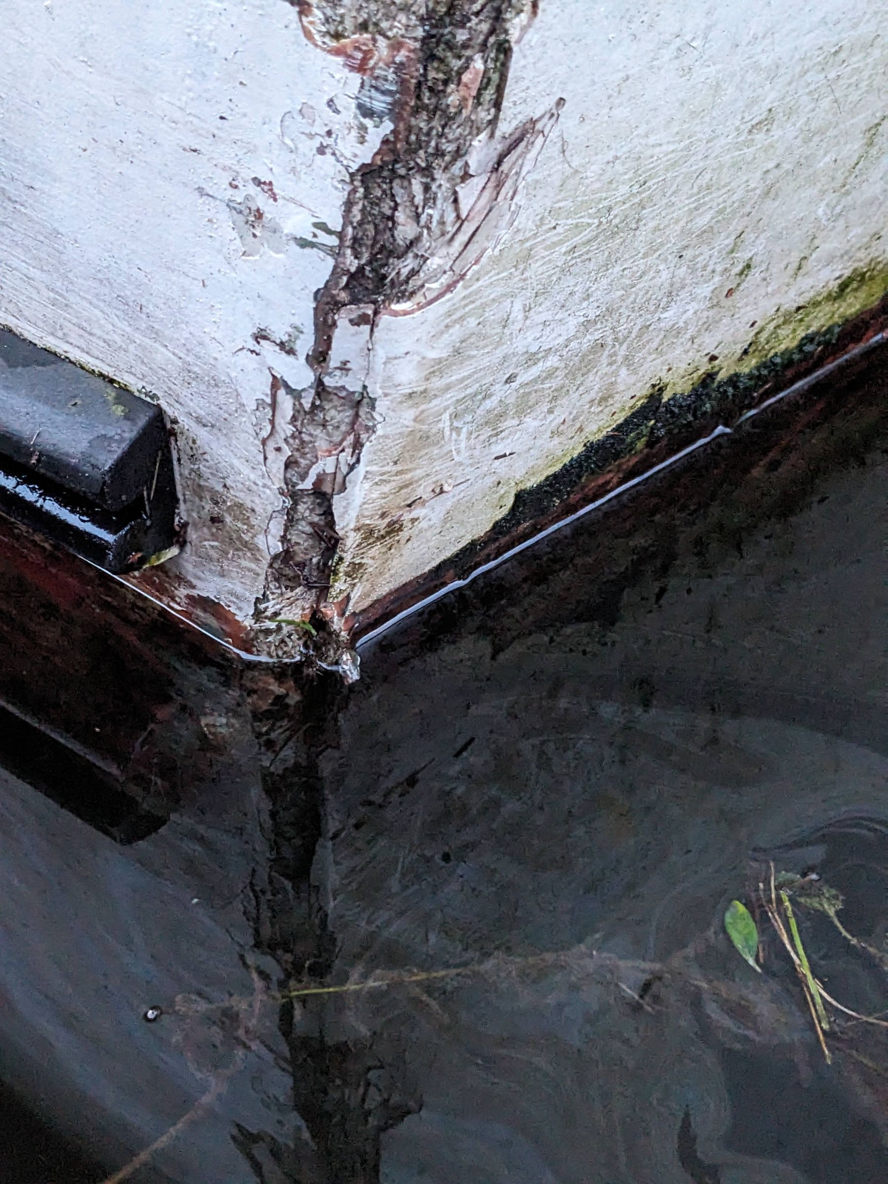

Hello all. Not the post I wanted to start with. We have a sinking problem and would much appreciate any advice.
My daughter bought a 27ft GRP cruiser a month ago planning to refurbish to liveaboard standard. Sailing on the Birmingham and Fazeley towards her new permanent mooring in Birmingham, it (1) broke down, and (2) started leaking badly. The corner of the stern seems to be cracked and is separating from the side, from the bottom upwards and we're having to bail out often to stay above water. With nobody on the boat at the moment and the boat in kind of a bad place it's a huge worry. Looks like an old bodge GRP repair has come apart. We have no clue what do to. RCR are fixing the engine but we're on our own with the sinking.
Forward looking advice if possible please. Yes, we should have had a survey but the surveyor wouldn't do one with it in the water. We needed to move fast to get past a canal restriction and get to the mooring in time, we were on the clock for various reasons. Yes, a steel narrowboat would be more robust but all the ones we could afford had hulls needing major overplating. We thought that as this was in the water and were assured the engine was great, and it was sold as needing electrical and gas work (fine), we could sail a few days then get the interior serviced and upgraded once it was 'home'.
The engine was not great. The hull is really not great. It's a cheap boat but a huge financial commitment for my daughter. We need someone that can do an emergency patch somehow and book it in for a proper structural repair as soon as that can be arranged (drydock??)
Help?

Emergency fixes in the water to stop it leaking:
Most things won’t stick to a wet surface.
You could try an adhesive tape of the type designed for emergency roof repair- make sure it is one which will stick to a wet surface.
Alternatively, West System epoxy will bond underwater. You would need to get the surface as clean as possible (Scotchbrite) and I would stick a sheet of glass fibre mat over it, ideally woven not chopped strand. Push well in to the epoxy to stop it cracking so easily.
Another option if you can access the area from the inside is a layer of underwater epoxy repair putty (Screwfix or similar) just on the crack, let it cure, dry everything off to just surface damp and then a thick layer of spray foam insulation. This should bond well to a damp surface and will flex a bit so shouldn’t fail too fast. Well known fix for leaking wooden boats.

If it is sinking then the crack is below the waterline, and unless the boat comes out of the water I can think of NO way to do an even half decent repair. You certainly can't glass over it with water coming in.
As a very temporary bodge leak stopper you could try mastic tape applied to the outside or Flashband, but I would not hold out much hope. You can also get two part "filler" that is supposed to work underwater. I would fear that engine vibration may open the crack up - especially if this is an outboard or outdrive mounted on the transom.
I fear this sounds terminal and time to scrap it, but if you can get it out of the water you could then grind out the crack, fill with epoxy filler and then, after cleaning and abrading the surfaces, applying several layers of chopped strand glass mat and resin to BOTH sides of the hull, inside and outside. DIY glass fibre work is perfectly DIYable, but this is structural.

Can you see (and get to) where the water is coming in from the inside?
If so then I would shape a bit of wood to closely fit and overlap that section and glue down with plenty of CT1. Wedge the patch securely in place however you can- battens, brackets etc.

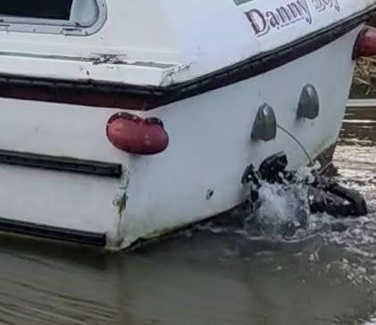

I am sorry, but some of these well-meaning posts don't seem to appreciate that the transoms on some boats have to take all the prop thrust plus any extra stress that may happen when the outdrive or outboard leg gets caught on something. As the OP has not told us much about the boat I fear some suggestions may not produce a repair of sufficient structural strength, although most would probably provide a temporary fix. I say this having seen the whole transom pulled off a small RP boat when the outboard hit a submerged object on the Thames.
If this is an inboard engine on a shaft then the structural strength needed of any repair will be less than either an outboard hung off the transom, or an outdrive bolted to it.
@Chris Yearsley If you don't know what I am on about post a photo of the back of the boat in question.

I'd not thought of that. It's an (Enfield?) outdrive ("Z drive"?). I was wondering how we could have caused so much damage when pulling away from the bank, without noticing it. And the damage goes high up. I wasn't on the boat much on the voyage as I worked all the locks and often got off at narrow bridges to help push away in case my daughter's rather uncertain steering caused issues. She did say that at one point the boat seemed to hit something underwater, hard, but keep going. And there's certainly an old repair inside that corner - so it's weaker than it was designed to be.
The pictures below show the (lower part of) the damage now, amd how much better the boat looked when my daughter bought it. She has been tremendously upset thinking it's all her fault, but if the boat had a weak repair, and then the outdrive hit something, then could it just be tremendous bad luck? I thought I'd read that the outdrive was supposed to kick up if it hit an obstruction, but it's very old and if it's corroded maybe it doesn't move like it should?
It leaks much more when the engine is running. Even with a patch repair I don't want to take it far at all.  Caggys yard is 9 miles, if they get back to me with the ability to help that would be best. For the in-water patch repair, and also the dry full rebuild of the damage, these guys are very friendly and helpful, I just need to find a way to get it dry somewhere for them to work on. Probably not cheap but I'm beyond being fussy and I think this is a problem that needs good, then quick, as the priorities. https://wrcomposites.co.uk/repairs-and-modifications/
