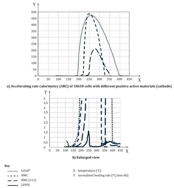

IanD Posted March 9 Report Posted March 9 (edited) What is frustrating is that the relevant ISO document (26325) does understand the difference; immediately before the section describing the susceptibility of different chemistries to thermal runaway showing that LFP is massively (hundreds of times) less susceptible to this (see attached plot), it says this (my bold): Because of the wide variations in terms of battery chemistries, construction, volatility and responses to a thermal runaway event, it is not possible to issue a generic prescription for battery compartment design and ventilation, and for fire containment and fire-fighting mechanisms in the event the latter are considered to be necessary. It is incumbent on the boatbuilder and battery installer to consult with the battery manufacturer and supplier to determine an appropriate compartment design and venting mechanism, and appropriate fire containment and fire-fighting mechanisms, if considered necessary. Edited March 9 by IanD
