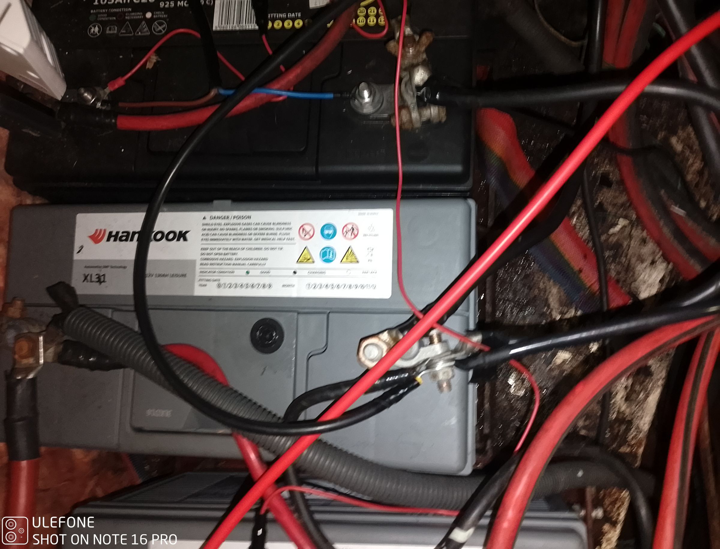

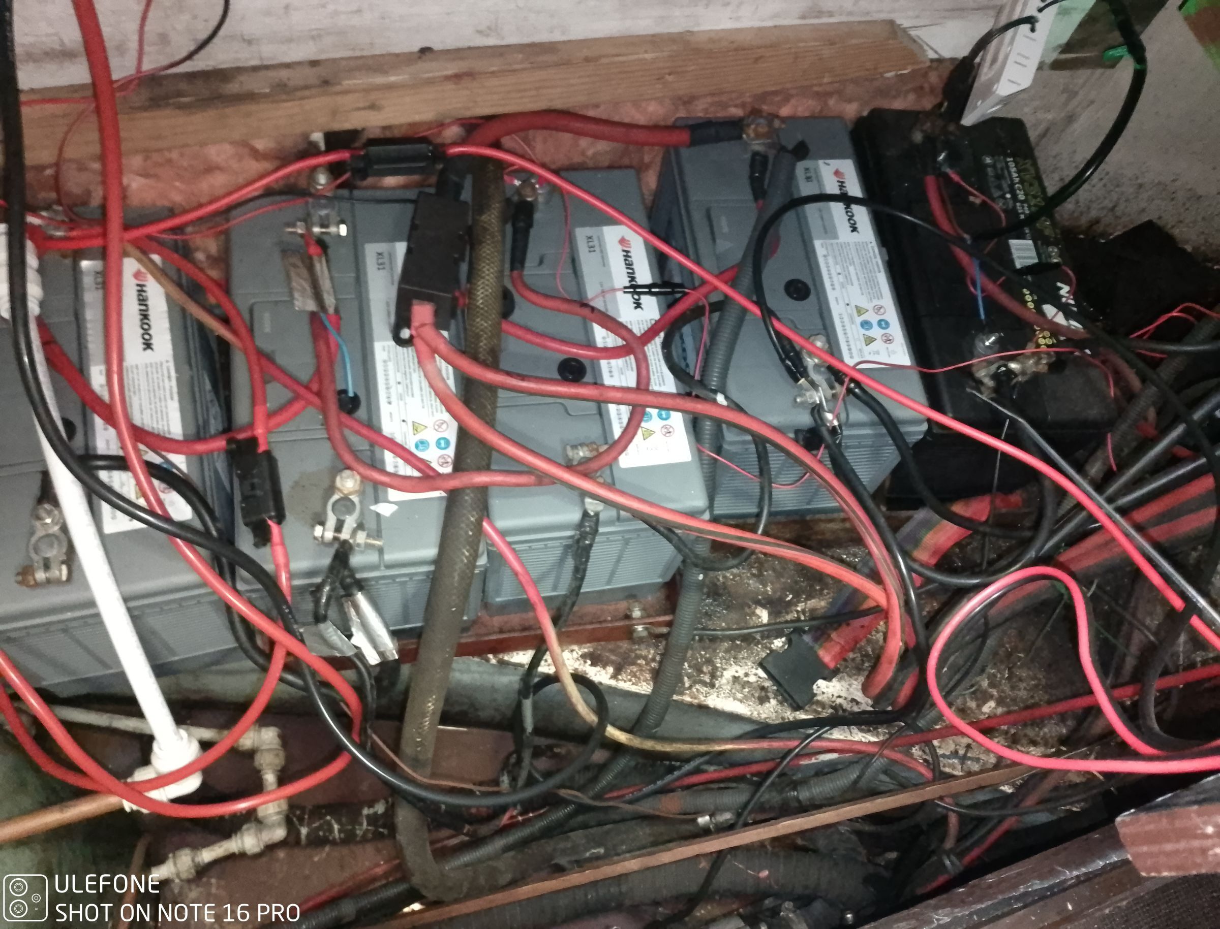

Memories Posted March 1 Author Report Posted March 1 20 hours ago, Tony Brooks said: You are right on at least two counts, but I would ask for recommendations for who to employ, there are some not so competent marine electricians in respect of Li systems. The LI batteries will charge far faster than any Li setup so in summer a decent solar setup can have them fully charged by mid-morning. They don't sulphate and are far more tolerant of deep cycling so you can sue more of their rated capacity and leave them partially charged with no, or little, downside. Here are the pictures I said I would take
Memories Posted March 1 Author Report Posted March 1 18 hours ago, Tony Brooks said: You should know the voltage and capacity of your existing system, if you have 24 volts or are using 6v batteries then it gets a tiny bit more complicated, but you need the same nominal voltage as the existing system, and if you get the same total capacity it will be more than adequate, possibly rather more than you actually need, but that just means you can go longer between recharging. If you don't know the battery capacity post a photo of them so we can work out how they are connected together (series, parallel or series parallel), you don't need to worry about that, we will tell you, and if you read the capacity in Amp hour (Ah) on the labels we can tell you the total capacity. My advice is to look for what is known as "drop in" 12V lithium batteries, rather than individual cells. I get the impression that Frogstar batteries seem to have a fair name on the forum, unless you want to pay for Victron. I posted the pics, hope they help, I have four not three leisure batteries and the starter which I believe is the black one.
ditchcrawler Posted March 1 Report Posted March 1 18 minutes ago, Memories said: I posted the pics, hope they help, I have four not three leisure batteries and the starter which I believe is the black one. There is definitely some work needing doing there. 1 1
Alan de Enfield Posted March 1 Report Posted March 1 (edited) 26 minutes ago, Memories said: I posted the pics, hope they help, I have four not three leisure batteries and the starter which I believe is the black one. apart from the mess of spaghetti, just thought to mention that unless you can find a way of restraining those batteries you will get a BSS fail. Also, unless the batteries are normally covered by a 'lid' then you will have another failure of the BSS as the terminals are not covered. Edited March 1 by Alan de Enfield
Tony Brooks Posted March 1 Report Posted March 1 14 minutes ago, ditchcrawler said: There is definitely some work needing doing there. Yes, look at that earth bolt ready to punch/abrade a hole in one battery.
Alan de Enfield Posted March 1 Report Posted March 1 48 minutes ago, Memories said: Here are the pictures I said I would take Having studied the pictures - in that area alone there is a lot of work to be done. Its pretty simple work but you will need : 1) to know what you are doing, 2) have read the installation regulations (BSS) 3) and follow those rules. If you are either not prepared to do that, or don't feel capable, then you will need to get the sparky who is doing you LI installation to completely re-do the engine bay.
