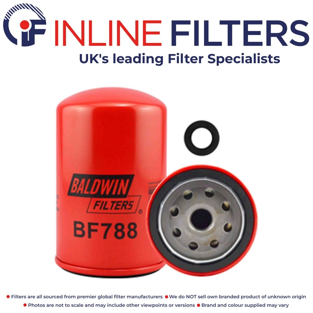

Does anyone on here have any experience with the CRAFTSMAN CM2 16hp engine. I need to source and change the main fuel filter and can't find much info online .
I know it's a Mitsubishi based engine similar to a 2 cylinder Thornycroft but that's about all I know
I don't want to start removing the old fuel filter until I have a replacement.

It looks like a standard "296" filter to me.
Do you have the CM2 engine maintenance manual ?
I have one in Pdf if you want a copy.

The photos do not show a 296 because they show a spin on and the 296 is bolt secured between top and =bottom castings.
It does look like a pretty standard filter to me, so I would take it off and visit a local car parts place (not Halfords or Europarts), the smaller local ones are usually more helpful, and will probably match it up for you. Otherwise, buy one from Craftsman, or talk to an online filter supplier like Filtermania.
Or try here https://yacht-supply24.com/catalog/brand-section/craftsman-marine/craftsman-oil-filter-cm2-16-cm3-27-cm4-42/

1 hour ago, Tony Brooks said:
That is a link to an oil filter  - the OP is wanting a fuel filter.
The fuel filter is here .........
Craftsman Fuel Filter CM2.16/CM3.27/CM4.42/CM4.65/CM4.80 | Yacht-Supply24
HOW MUCH !!!
£38 + £20 postage, and 2 weeks delivery !
Mind you that is the Cyprus based distributor.

fitted a new fuel filter today as well as a little clear plastic inline one .
