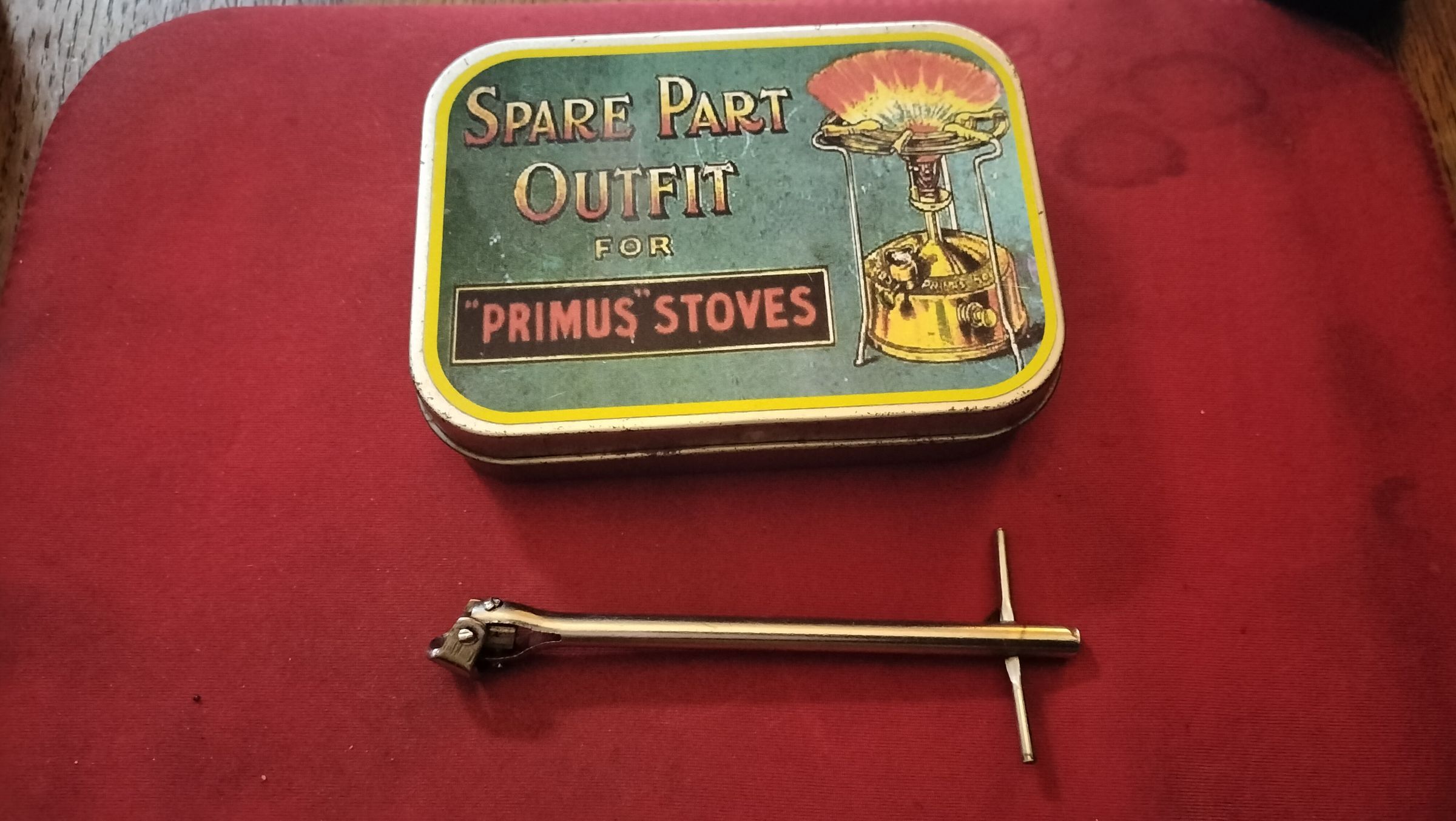

carlt Posted February 26 Report Posted February 26 Is it the nut that this waggly wrench was designed to reach? Just another thought... Is the "nut" you're describing actually the jet which is supposed to be emitting vapourised paraffin? Are you preheating the burner?

carlt Posted February 26 Report Posted February 26 24 minutes ago, mrsmelly said: Cannot help other than to say that we had one on one of our boats and it was a great bit of kit so sort it if you can. Every part on them is serviceable or replaceable. I've got the older model and I keep threatening to sell it but I wouldn't make enough to pay for the divorce. 1
Roadrobin Posted February 26 Author Report Posted February 26 Thanks for all replies, I’ll remove the burner and get a full service kit. Also get a couple of the spanner’s that’s suggested I always pre heat well but just pressurising without heating I have the leak. It’s been a good friend never a problem before in 15 years. Thanks again
carlt Posted February 26 Report Posted February 26 47 minutes ago, Roadrobin said: Thanks for all replies, I’ll remove the burner and get a full service kit. Also get a couple of the spanner’s that’s suggested I always pre heat well but just pressurising without heating I have the leak. It’s been a good friend never a problem before in 15 years. Thanks again The seals go eventually. The spares kit in my photo has a lifetime's supply of seals and stuff. If you need anything for the 079K then https://www.sparesmarine.co.uk/ are the place to go.

Bee Posted Monday at 08:58 Report Posted Monday at 08:58 Almost certainly Carl t is correct, you need the waggly spanner thingy, there are 2 sizes of them and there might be a little fibre washer under the jet which could be the problem. Don't use too much force on it as the adjustable burner is awfully expensive, the non adjustable version is not expensive but then it becomes just a basic primus stove.
Roadrobin Posted Monday at 14:03 Author Report Posted Monday at 14:03 Thank you Bee that's very helpful also I'm about to purchase the scanner to remove the jet

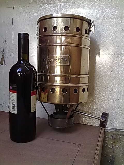

blackrose Posted Tuesday at 09:20 Report Posted Tuesday at 09:20 29 minutes ago, alias said: As a rough rule of thumb a litre of water is a combustion product of a litre of liquid fuel. It would only add to condensation if it was vented inside the boat, rather than out through a flu. So the Taylor heaters are flued? - sorry I didn't realise, I couldn't see pictures from the link. My paraffin heater was un-flued (the type shown below) but I never had any condensation issues with it.
alias Posted Tuesday at 09:36 Report Posted Tuesday at 09:36 14 minutes ago, blackrose said: So the Taylor heaters are flued? - sorry I didn't realise, I couldn't see pictures from the link. My paraffin heater was un-flued (the type shown below) but I never had any condensation issues with it. Presumably your ventilation was adequate to dissipate the products of combustion.
