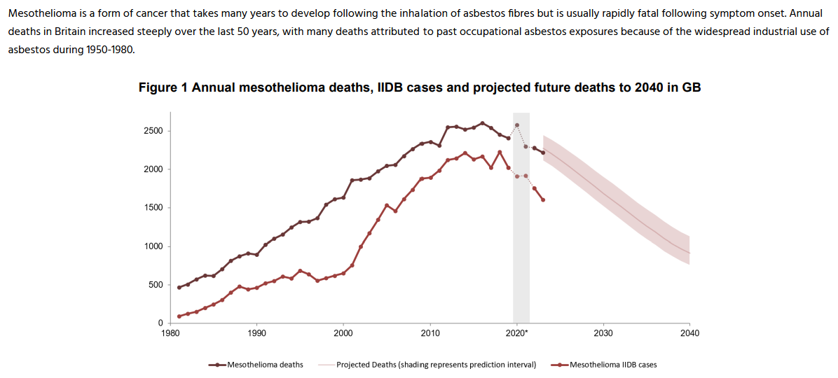

So why is if killing more people today then it did in the peak.
It's not any more, as a quick search shows -- this is from the very first link returned... 🙂
Death rates carried on rising until about 2018 due to past exposure and the long time it takes to kill people. But the rates have been falling since 2018 and are projected to carry on falling, because the people who were exposed are dying off.

Yes it's still the biggest cause of workplace-related deaths in the UK, as the site I got that from shows.
https://www.ukata.org.uk/library/asbestos-health-statistics/
The death rate is however now falling, since it was banned 45 years ago and more and more people who were exposed have died from it... 😞
