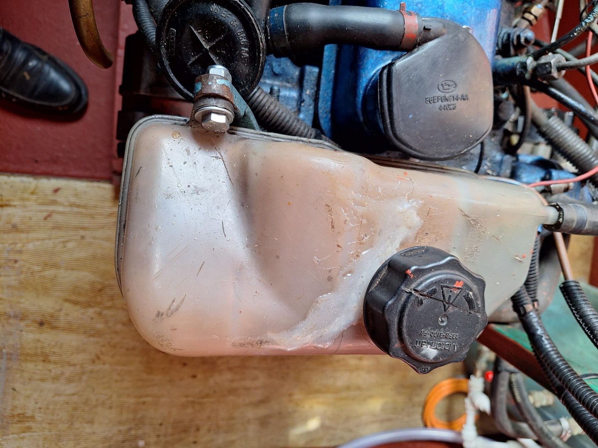

Sid Charles Posted March 2 Author Report Posted March 2 I have ground out the crack with my dremel and used Araldite to seal (a big splodge) and so today I will test to see if it works.

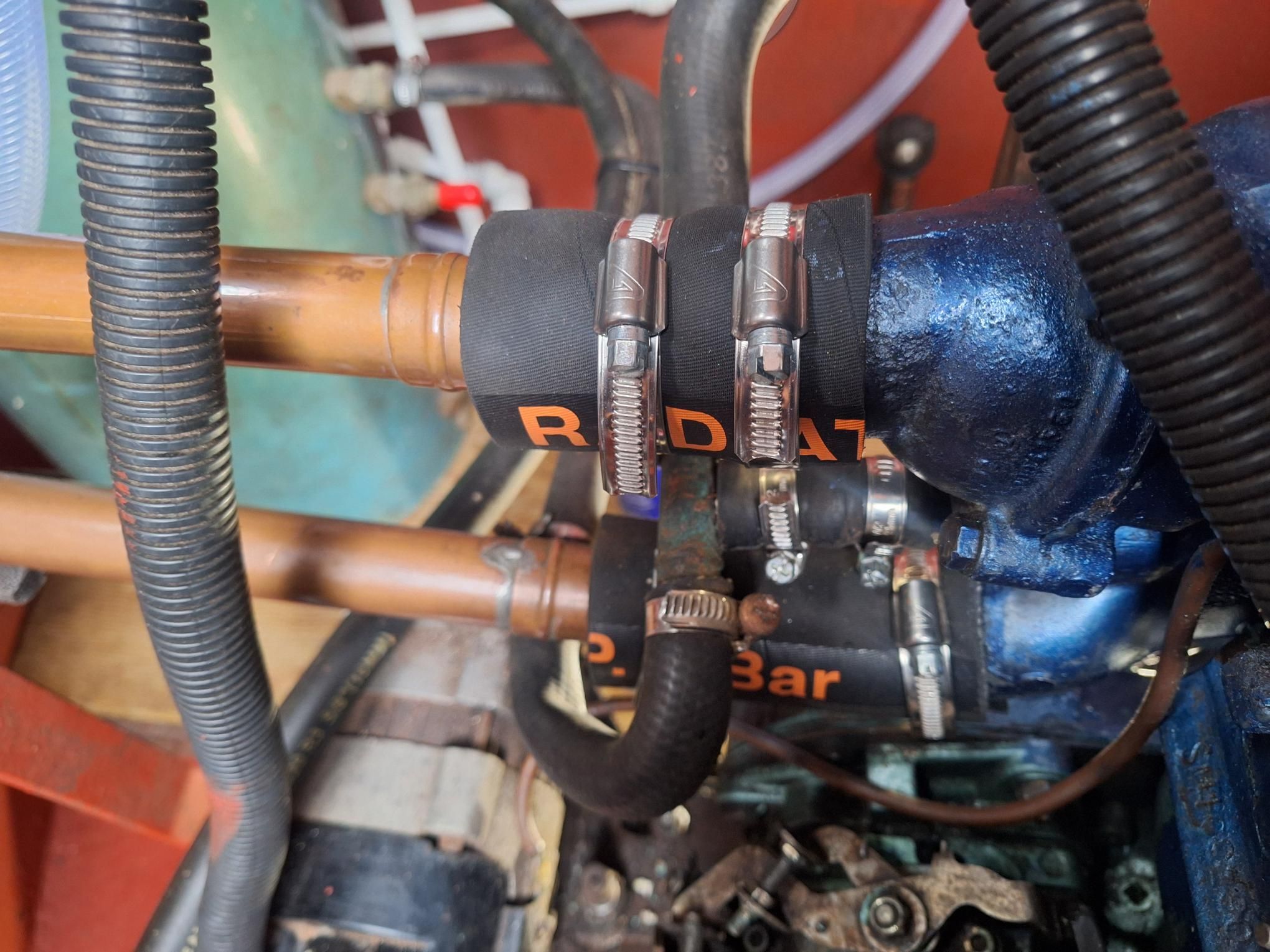

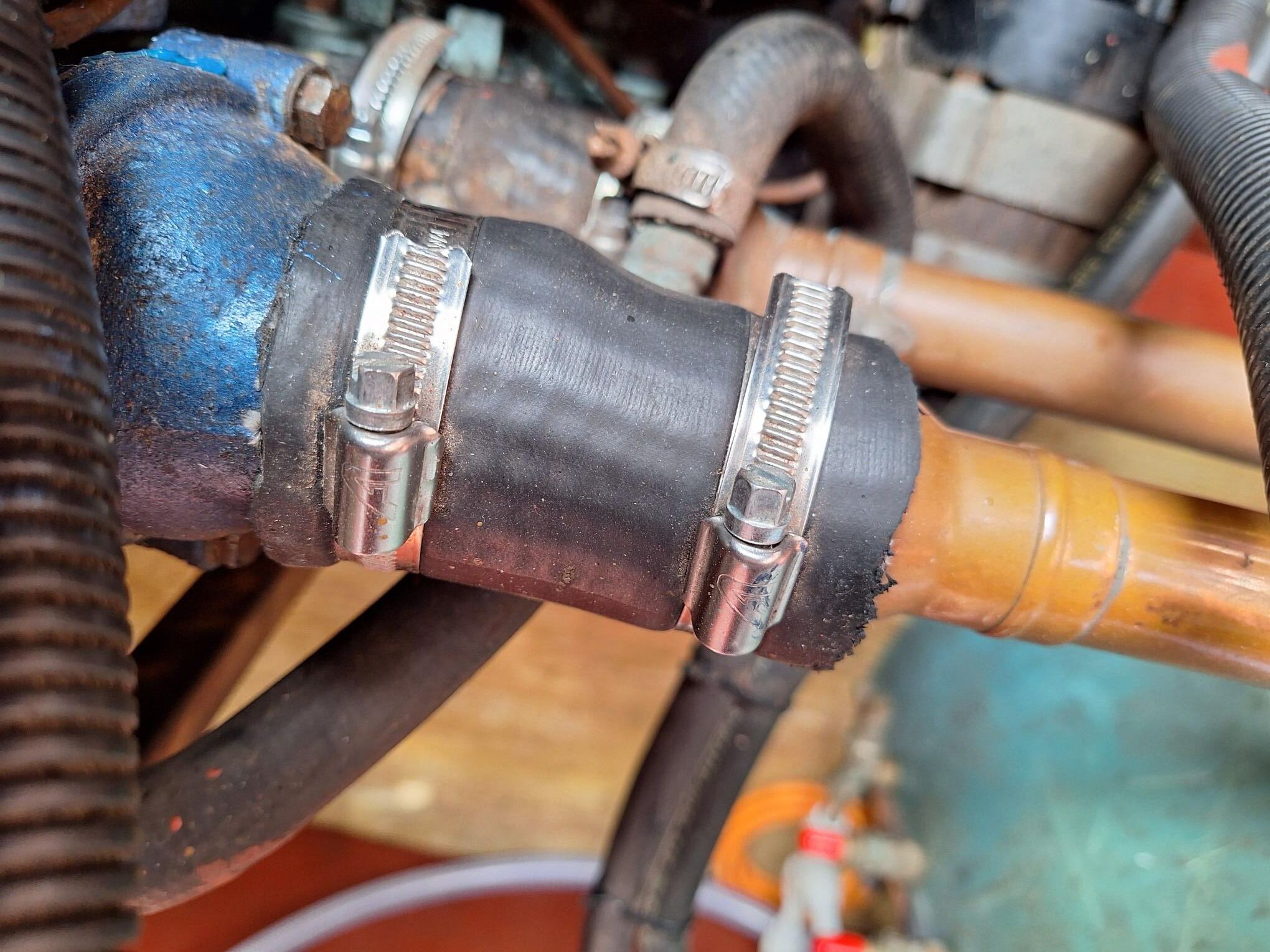

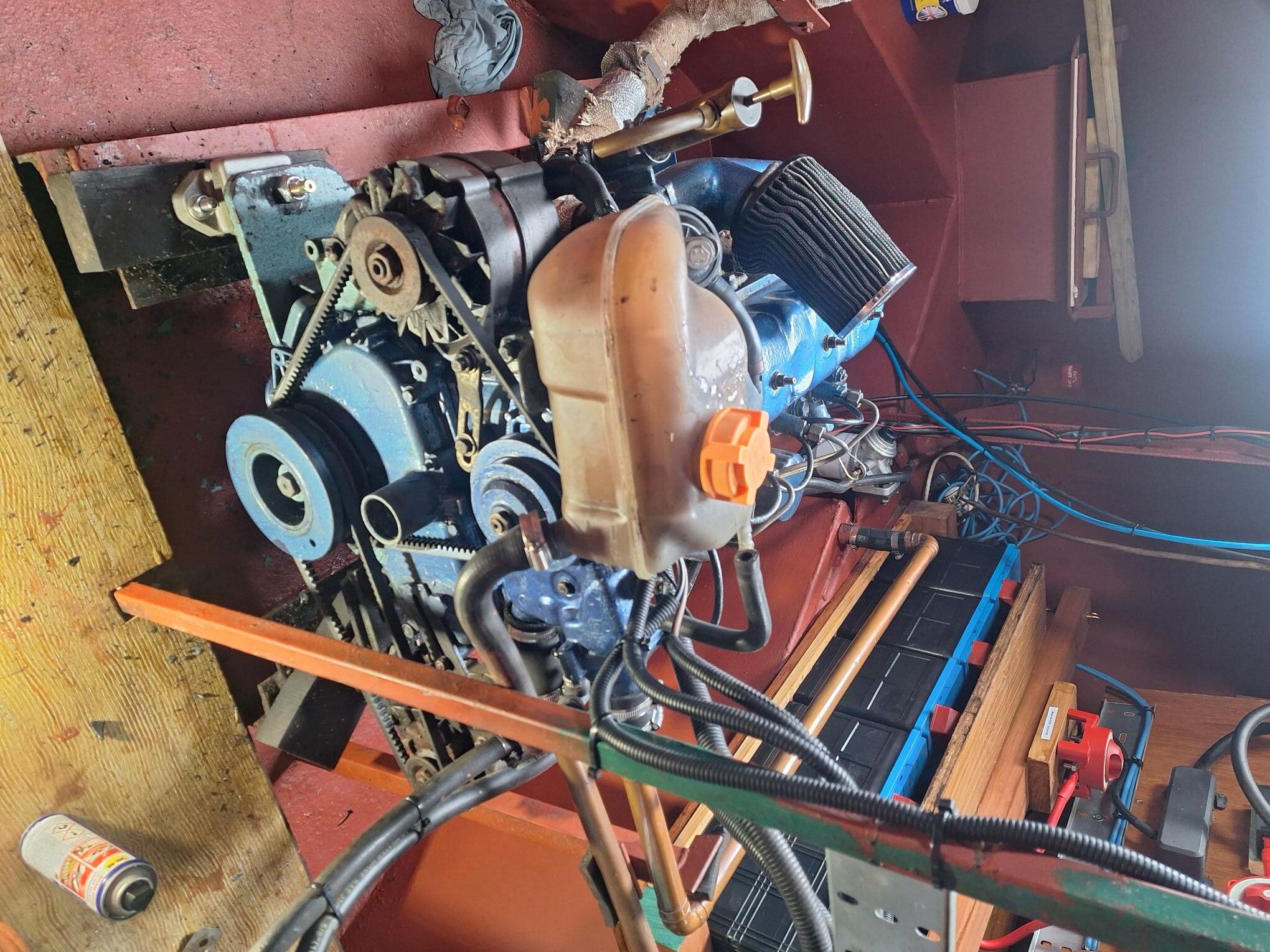

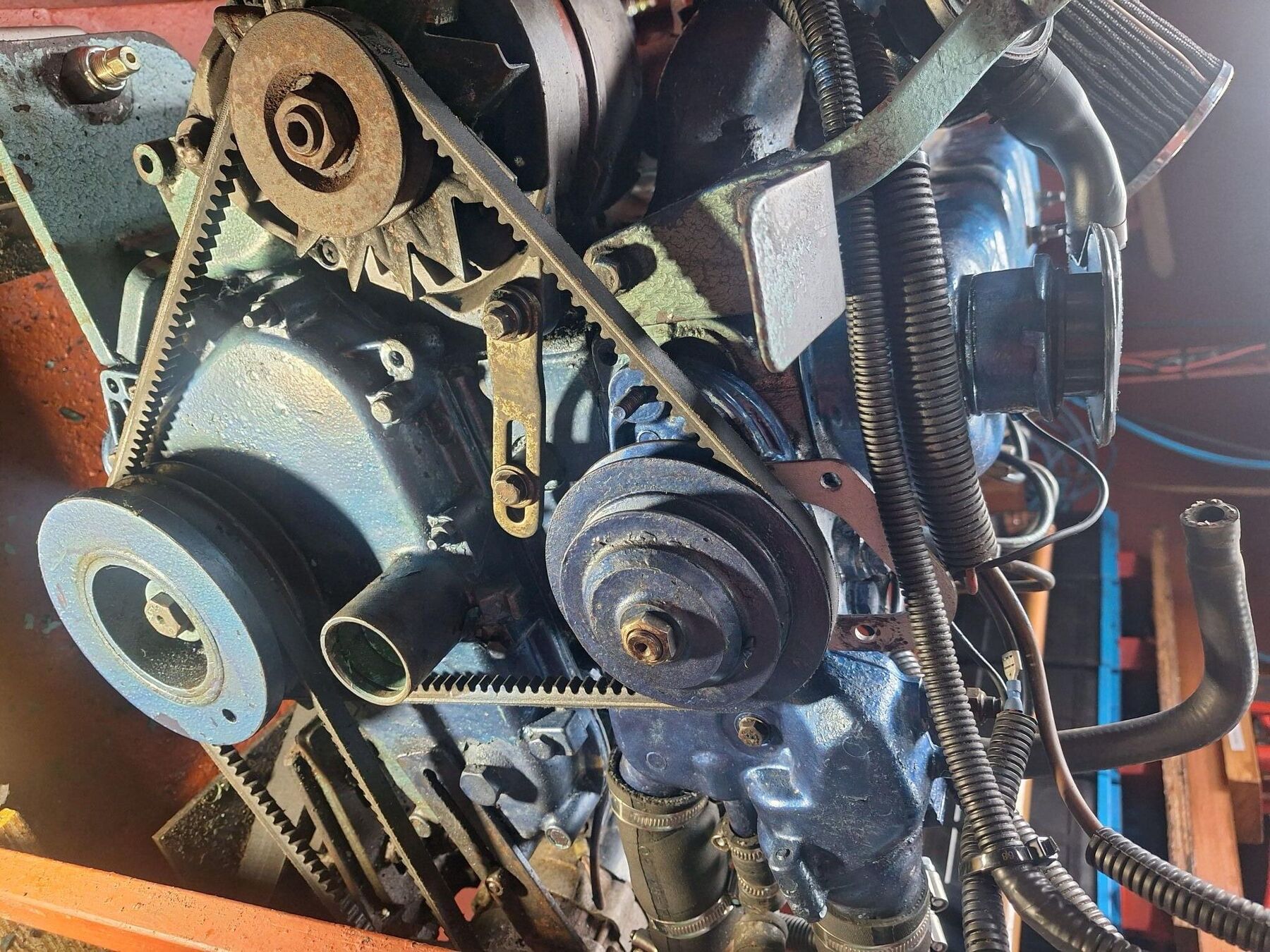

Sid Charles Posted March 3 Author Report Posted March 3 Job done, the Araldite did the trick! Yesterday I ran the engine for the first time since replacing all 4 engine mounts, WOW what a difference, the engine doesn't jump around anymore and when I select reverse the great big bang has gone, it is still more clunky than going into forward but nothing like it was. I was very pleased until I noticed a drip of water running down from the water pump, it's the rubber hose I had to codge up, the hose required is a swaged down one (which they don't make) the water pump end is about 43mm then it joins a copper pipe which I think is 32mm. I purchased a Peugeot replacement for a bottom radiator hose but it curves just after coming off the water pump, I need it to be straight. I messed about with the jubilee clip and the drip stopped, but I can't rest, at the weekend it's coming off, and I am going to try to find something more suitable, trouble is they never give dimensions when they advertise on ebay or the like, you can see the hoses in the picture, I need the lower one which would be the oddest shaped one.
Jen-in-Wellies Posted March 3 Report Posted March 3 Flexible coolant hoses are a thing. They typically have a spiral wire inside to prevent them collapsing when curved. https://www.carbuilder.com/collections/hoses-cooling-system?filter.p.m.custom.sub_type=Flexible&filter.v.price.gte=0&filter.v.price.lte=99&sort_by=best-selling
Sid Charles Posted March 3 Author Report Posted March 3 17 minutes ago, Jen-in-Wellies said: Flexible coolant hoses are a thing. They typically have a spiral wire inside to prevent them collapsing when curved. https://www.carbuilder.com/collections/hoses-cooling-system?filter.p.m.custom.sub_type=Flexible&filter.v.price.gte=0&filter.v.price.lte=99&sort_by=best-selling Thanks, Very interesting
Sid Charles Posted March 6 Author Report Posted March 6 I have purchased some better coolant hoses now, shall sort it out in the morning, the Araldite seems to have fixed the tank however, the cap is split, got a replacement coming, hope it is the correct one, otherwise it's all looking good.
Tony Brooks Posted March 6 Report Posted March 6 1 hour ago, Sid Charles said: the cap is split, got a replacement coming, hope it is the correct one, otherwise it's all looking good. Good, worth persevering. Those caps should have a stainless steel disk inside the cap, under a rubbers seal. this is the pressure/vacuum valve, so if both caps have different pressure valves you can change them over, although I doubt you really need to pressurise for canal and summer rive use.

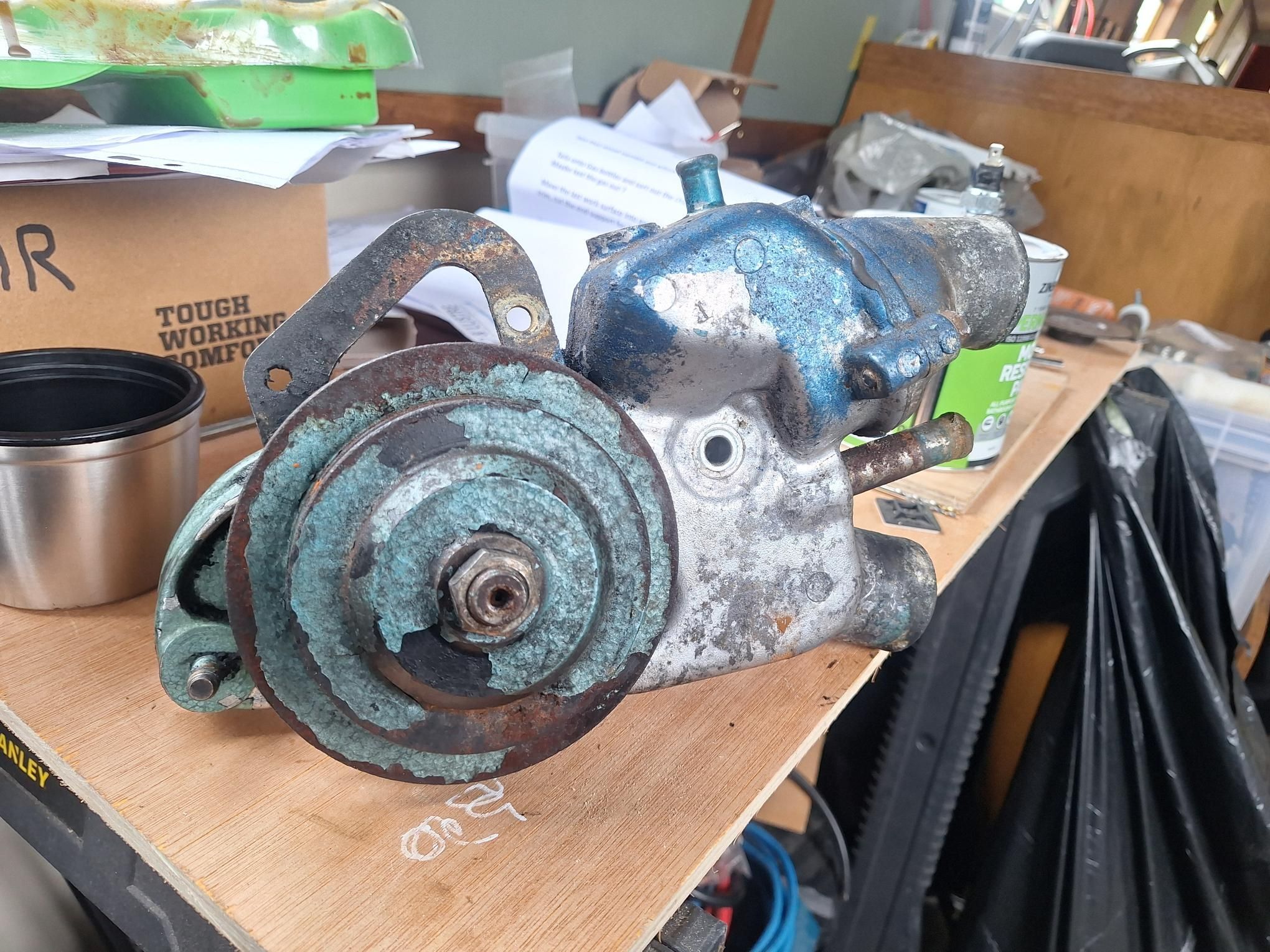

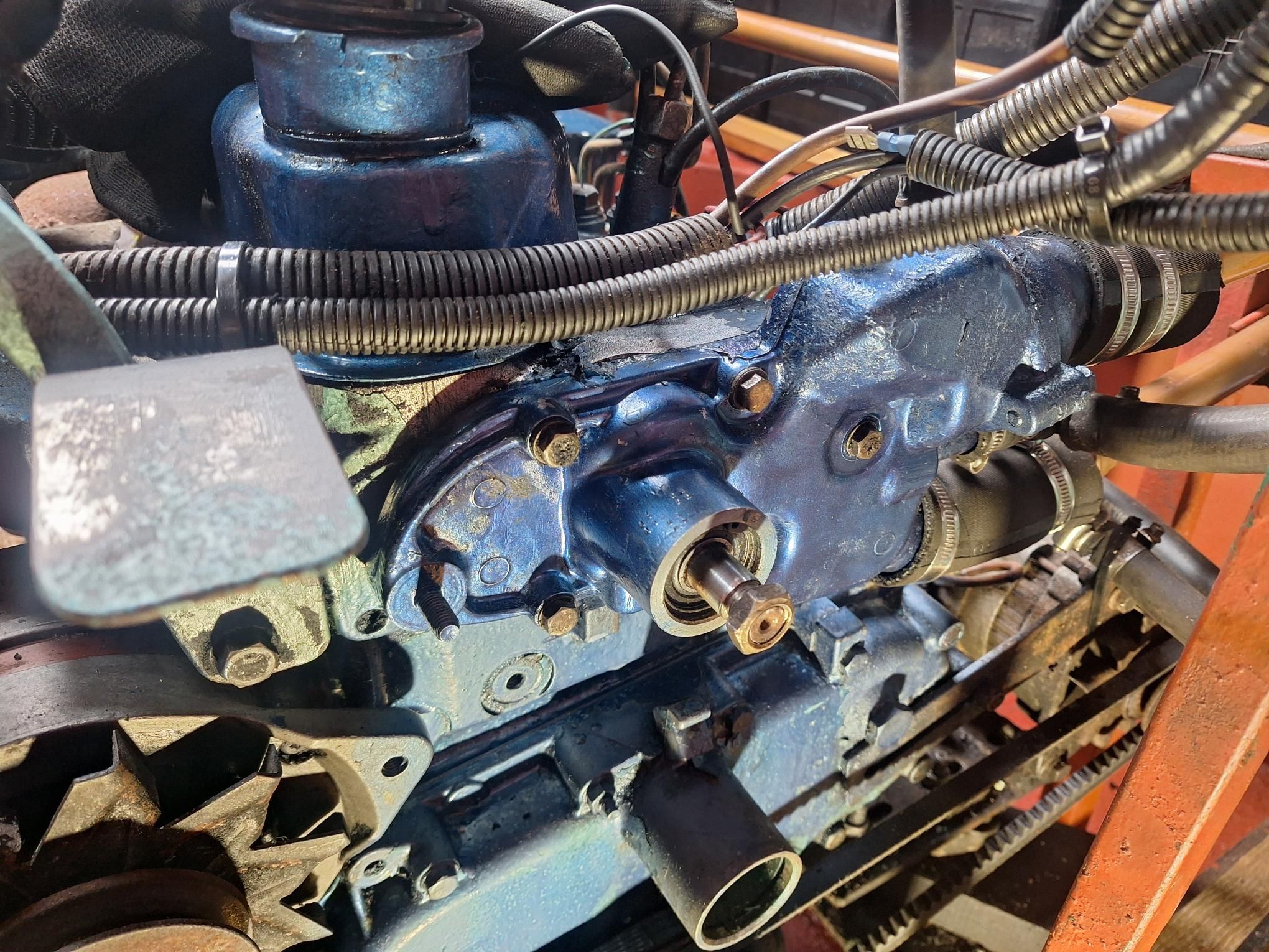

Sid Charles Posted March 8 Author Report Posted March 8 Well I wanted to replace the rubbish coolant hoses, which I fitted 18 months ago; they were made from chopped-up car hoses, however during the stripping I found horrible gunge in the hoses, it must be from the engine block because I cleaned the skin tank as best as I could, so I went the whole hog and took the water pump off to check it was all there, it was actually OK, but now I have peace of mind. Now all back together with new hoses and clips. 1
