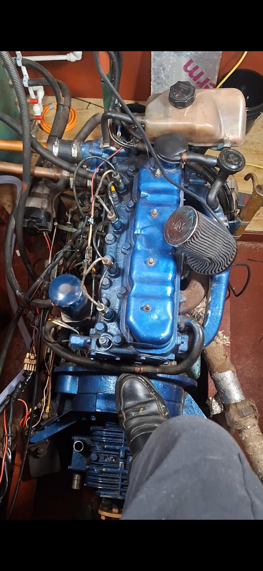

A lovely photo of the engine. Just a pity there is a great big leg obscuring the bit in question ie the gearbox! However it does say “ATF” which suggests a mechanical box
I was wrong again, I can now see the bolts holding the two halves of the case together, that is a fair indication it is a Hürth that uses balls running up  ramps to provide the bulk of the clamping force for the clutch plates. This still does not later what I said above about trying it on the gearbox lever, ensuring it ATF oil (Dexron) in it, and then it is possibly needing a strip down and internal inspection - or changing for a PRM mechanical box.

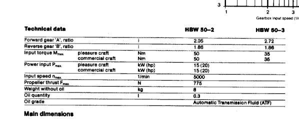

Here are ratios for some Hurth boxes, but the difference between ahead and astern will be similar across the range, they are a bit greater than I thought/said, but not as great as you posted

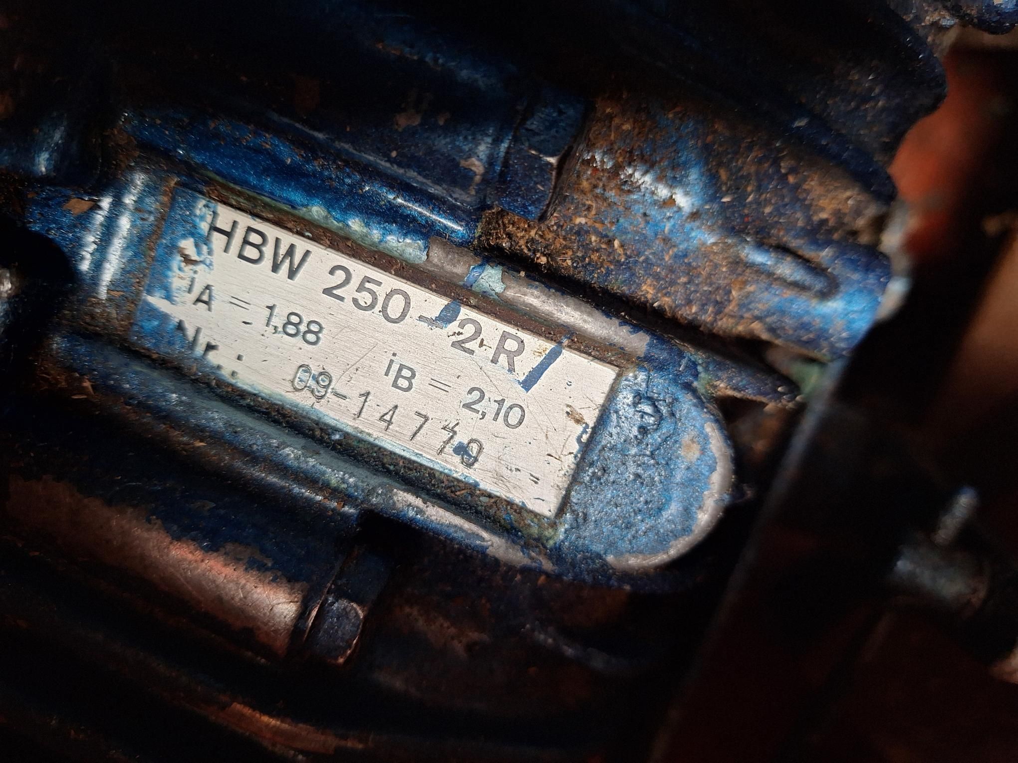

From the photo the forward gear ratio is 1.88 and the reverse ratio 2.10,which is the opposite way round from your table.
It is not worth arguing about. I was trying to save the OP chasing what looks very like duff information to me. I agree the letters on the label suggest that but!
Whatever the label says whichever gear needs an idler will have the one of the gear train pair that is slightly smaller than the ahead gear, simply so its teeth clear the mating gear on the output shaft. On modern hydraulic boxes being driven "backwards" it may be that the idler can run for extended periods under load and in that case the ratios would be reversed, but mechanical gearboxes that typically do not have an oil pump for forced lubrication and rely on flooded bearings or splash it is bad practice to run them in nominal astern while driving the boat forward. I can't see any reputable manufacturer doing that, so unless we can see what the manual that came with the box says I stand by reverse having the lower ratio. In any case the difference will be nowhere near a whole number as someone claimed.
The PRM mechanicals are different in that they have a common 2.47:1 astern ration and varying ahead rations, only the 3.06:1 ahead option has anything like a whole number difference between ahead and astern, in that case it is a difference of 0.65. That may make a noticeable difference in engien revs sound between ahead and astern.
