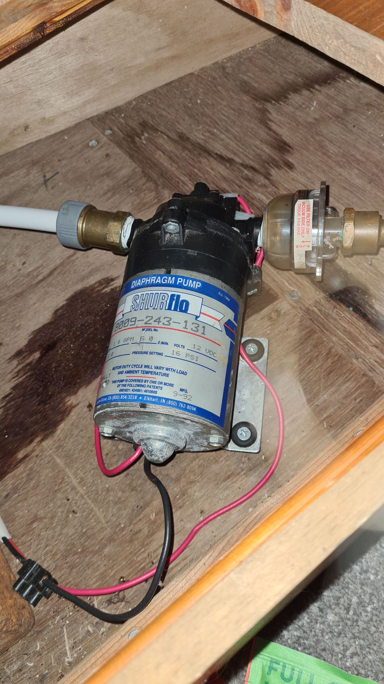

Hi, I am currently on my first proper trip on my new (to me) narrow boat. When I purchased the boat last year the survey reported the water pump not working, it works fine but takes ages to kick in would this be a pressure switch issue? Or maybe a pump? Would a accumulater help?

So when you open a tap, nothing happens for sometimes over 40 seconds maybe a minute then the pump kicks in and water flows at good pressure, opening all the taps seams to help but this could be a coincidence. I dont think i have an accumulater
Is the pressure switch part of the pump or can i get it separately? I assume the switch is open circuit until the pressure drops the closed supplies the pump, I will test it in the morning, too many beers tonight.

The pressure switch is normally integral to the pump. However, sometimes an external switch is attached, such as the square d type, which may be used in place of the internal switch. It will be fairly evident which you have by looking.The inbuild switches are usually a simple microswitch.
You could try fitting a new pump. But I have found the take apart clean and put back together routine, maybe with new O rings,  to be sufficient to restore water pump performance. Include cleaning the filter on the input side of the pump.

It has been reported that the very small port between the pump head and the pressure switch gets furred up so it takes longer for the pressure to drain from the switch housing and longer for the pump to cut in. The switch is on the end held with a couple of screws which should let you poke the port out. In the photo you strainer looks a bit mucky, but that may just be the light.
I think the label says it was manufactured in 1992, so 34 years later it is probably overdue for replacement even if you manage to get it working a bit better with some fiddling. It must surely be on its last legs! And I would also say that 16psi (just over 1 bar) is a rather low design pressure for the pump.
The purpose of an accumulator is to stop the pump rapidly cycling on and off when a tap is partially opened. So you only need to service/replace or fit an accumulator if that annoyance presents itself.

Based on my experience it probably isn't.🙂. As others have said it's pretty old and 16 psi seems low.

Thanks everyone for the feedback, i think after 34 years the boat deserves a new pump.
I bet a new one wont last 34 years. Take the switch off, poke the hole out, put it back together and try it. You haven't lost any thing and if it doesn't work replace it. Do you really need higher pressure?
