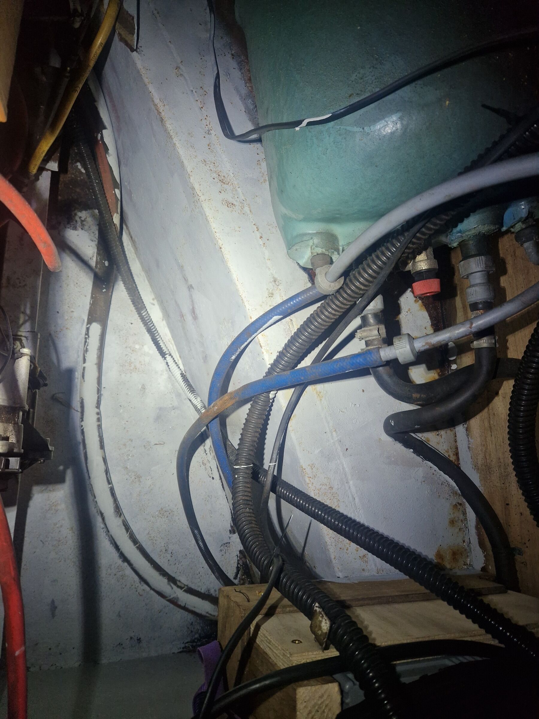

Thats the red knob that started my problems
