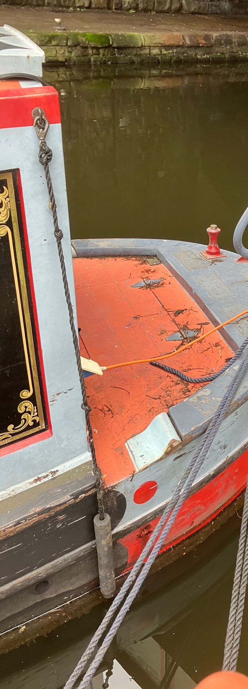

I normally cruise with my fenders up. There attached to built in loops on the side of the gunnels, just hanging down when moored and laying on top of the gunnel when cruising.
My question is, is there a way to keep them safely laying on the gunnel without them rolling off?
Yes, but not by using the eyes, use longer ropes and fender hooks on the handrail. They can then be lifted off and stowed away. This also allows you to place them to suit any bank projections. Otherwise, you can get flat plastic fenders that would not roll off, but may be brushed off by vegetation because they are likely to be wider than the gunnels.
I use soft shackles on the loops on the gunnels so they can quickly be removed and placed on the roof when leaving a mooring.
Lifting fenders before leaving a mooring isn't an issue. I want to know how to deploy side fenders when single-handed and coming into a mooring; into a big lock with other boats or mooring up against another boat?

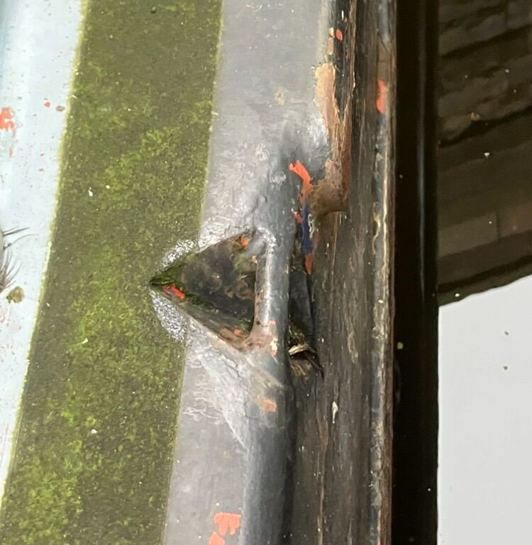

But I have the ability to fit more than 2 fenders. I have 4 of these eyes fitted each side and 4 cut in fender eyes on the gunnels each side as in the photo, so I have more than enough places to put fenders and the ability to move them to whichever side I need to. I have about 6 fenders on board used when the mooring dictates.
