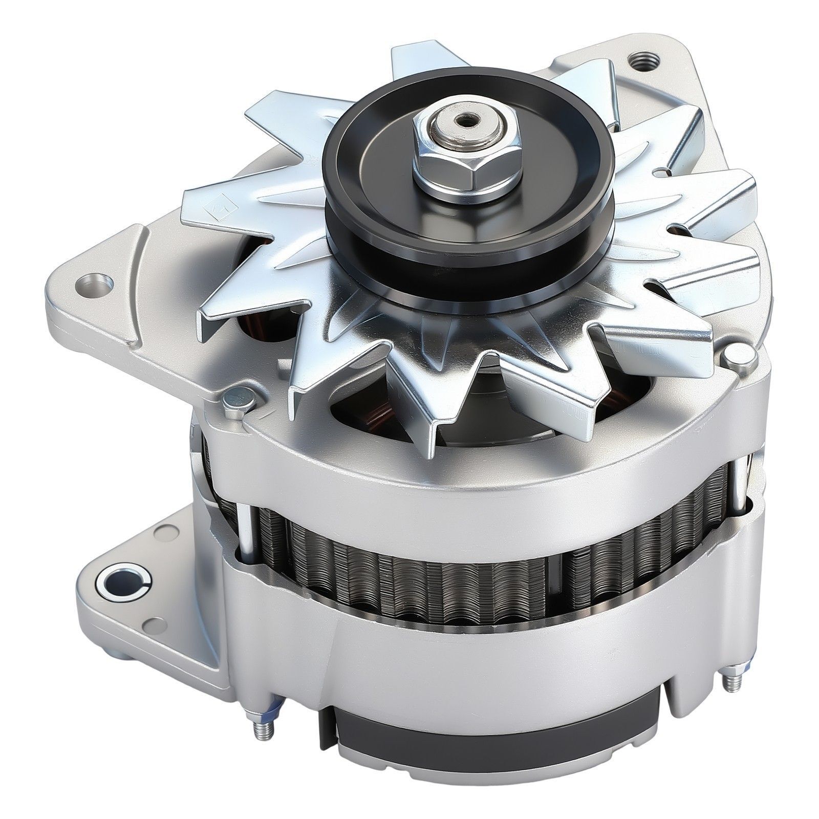

I see, so I probably want to buy the left-hand one (which would be mounted on the left when facing the pulleys side, although this is on the starboard side of the boat). But good to know that I can swap over the handedness if I get the wrong one. But, it still doesn't really help me understand about the rotation. Or can I just trust that the alternator will likely rotate the correct way regardless of handedness? The fan does seem like it has a correct rotation direction .
The alternator and fan looks like this. Is this fan supposed to rotate clockwise or counterclockwise when looked at from the pulley?

In all probability, yes you can trust that the fan will be correct for the engine rotation because Beta engines rotate the same way as maybe 98% of all similar engines, but it is not a 100% certainty for any engine. In ant case, as long as you get another A127 the fan from the old alternator should fit, and that one would be for the correct rotation or a universal one. The time things may get difficult is if you bought a different make, then the shaft size might be different.

Clockwise like most alternators, the cooling fan pulls air out of the casing.
(the alternator itself will work either way)
