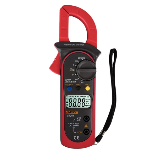

Why not just use a multimeter set to amps ?
Most boaters these days have one and they only cost ~£20-£30 (but ensure it does DC amps not just AC amps)
Digital Clamp Multimeter St201 2000 Counts Meter Ammeter  Voltage9672 - Picture 1 of 10
  • Author
#8
Yes. That is an idea and I do have one.  Never thought of that. But I would really like to keep an eye while using it. It’s not essential but something I’d like to track more easily than having to go below while someone else uses the windlass.
#9
Point of Order, that one doesn't do DC. The DC ones by UNI-T have a different jaw shape.
Also, the UNI-T DC ones are nearer to £50. Or were last time I bought one!
