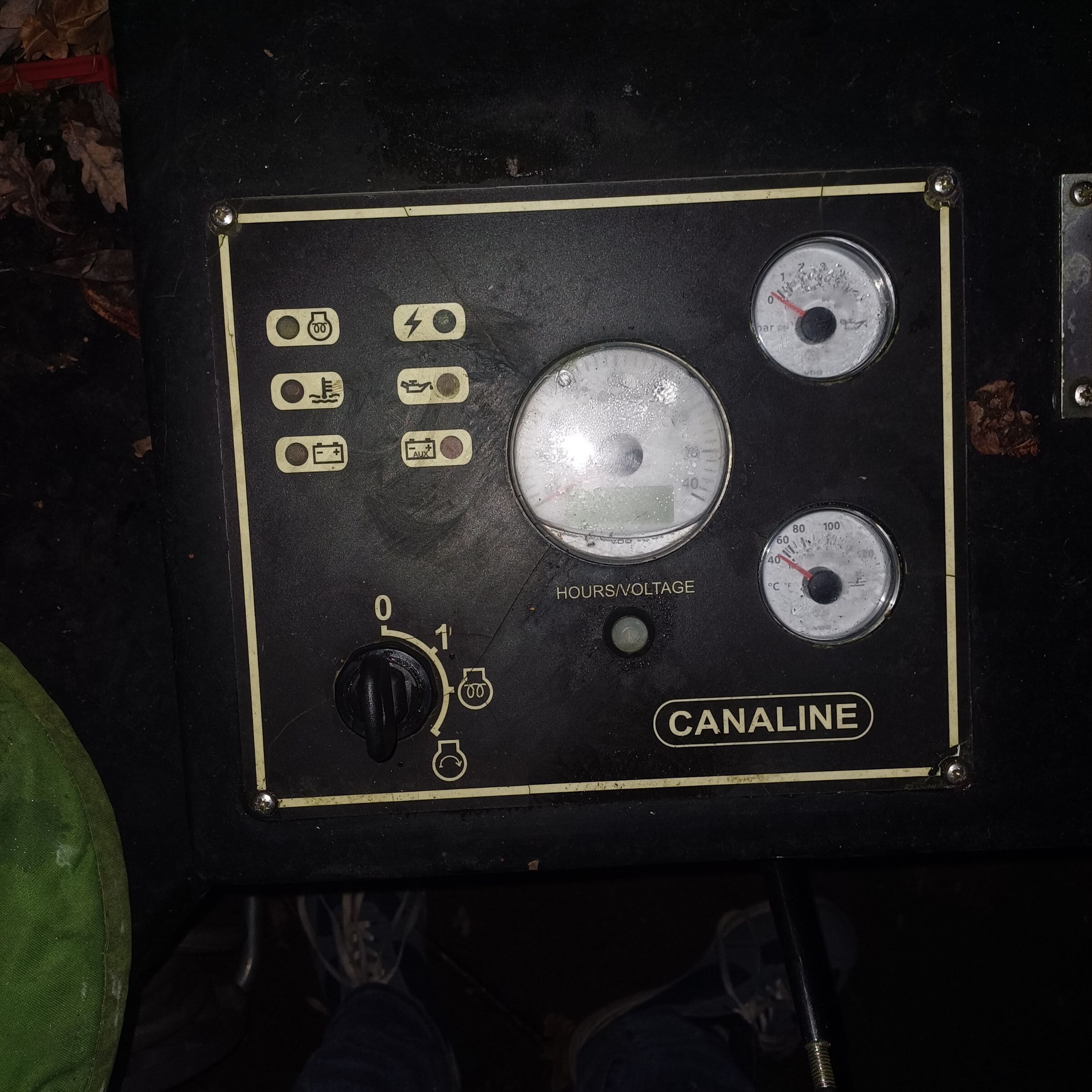

My engine isn't turning over at all, conditions are very cold here (canal frozen) and it hasn't been started for a week. The lights come on except the coil light and when I turn the key to ignition I get nothing. Is it likely the battery is too cold or just completely dead?
Start with simples.  Check engine battery terminals for cleanliness and tightness, including cable to engine mass.
The panel lights come on when you turn the key to position 1. But when you turn it to the heat or start positions do they go out? That would suggest a flat battery.

Thanks all. I tried again last night and it did try turning over but wouldn't start. The coil light didn't come on as usual so I'm thinking that there is perhaps not enough power in the battery at these temperatures to heat the fuel?
looking at the symbols on the ignition switch AND the warning lamp, I think what you call the coil lamp is actually the glow plug warning lamp. It should only come on when you turn the key to the second position (glow plugs on) and may stay on while the key is in the third position (start). The fact it does not come on suggests to me that there is a good chance that the warning bulb as blown or the glow plug supply from the switch has failed (fallen off?).
Although in this case I still suspect a discharged and probably faulty battery, the glow plugs are used to make cold starting easier in cold conditions, so you need to make sure the glow plugs are working. At the very least, put a volt meter (20V DC) or a test lamp between a glow plug terminal and clean metal on the engine and operate the glow plugs. The test lamp should illuminate, or the voltmeter read battery voltage or a little less. This only proves you have an electrical supply to the plugs, but one or more may be burned out. The easiest way for a typical boater way to test them is to take the plugs out and connect them across the battery to see if they glow - DO NOT hold the tip if dong this, you may well get burned as they heat up. I repeat, faulty glow plugs will NOT be the reason the engine is not spinning over fast enough to start.
Clean up the cable terminals and battery posts, wait until later today or tomorrow and try to start the engine again. Temperatures are set to rise to a balmy 5 degrees above zero tomorrow in the East Mids!

Thanks all, great advice as always. Will get the volt meter onto it later and give it another shot. Temperatures should be above freezing today so still holding out some hope.
Take the voltage reading before turning over the engine, THEN take a reading whilst you are turning over the engine (you may need someone to turn the key whilst you look at the voltage - depends on your 'set up')
When did you last full charge it , how old  is it? Can you measure the voltage ? The coil symbol is the engine Heater plugs, It should illuminate when the key gets to that position, does that happen?

Been wading through this....if the engine has heater plugs, this weather they need a good battery, and 30 to 60 secs on the heater plugs, other wise forget it - that was how my 1.5 started, the Gardner was different, push the button under the rack and then the starter.......
FWIW, BMMC 1.5s are known to be less than perfect starters in the cold and definitely need a long glow plug cycle, even longer if the glow plug holes have not been decarbonised for years, but the OP seems to have a Canal line engine which is likely to be Isuzu that uses modern larger diameter glow plugs. That should be a much better cold starter, but it will still need glow plugs or lots of cranking in this weather. Holding glow plugs in operation for longer than the manufacturer/mariniser advises is not a very good idea, it may burn the plug(s) out.

As @Tony Brooks said, the maximum amount of glow plug time varies from engine to engine - 30-60 seconds is fine for a BMC with older glow plugs, but modern engines need far less time and 60 seconds is likely to reduce the lifespan of the glow plugs. HMI/Isuzu have it in bold in the manual, no longer than 10-15 seconds.
6 minutes ago, ditchcrawler said:
Lack of heat wont stop it cranking
True, but from what the OP has posted I have doubts that he knew the "coil" symbol was for glow plugs, or even what they are used for, so he may have been starting it for weeks without using the glow plugs, that and limited running MIGHT be why the battery is now flat. Other potential faults available.
I guess the OP could try jump starting off his domestics assuming they aren't flat now...   You will just need to connect the domestic battery positive to the starter battery positive with a decent jump lead. The negatives <should> already be connected together (but its a boat so never assume...) Conventional wisdom says connect the starter battery first in case there is a build up of hydrogen gas near the flat battery which Lead acids can give off and a spark could ignite. (just saying - personally i think you have more chance of winning the lottery but....)
