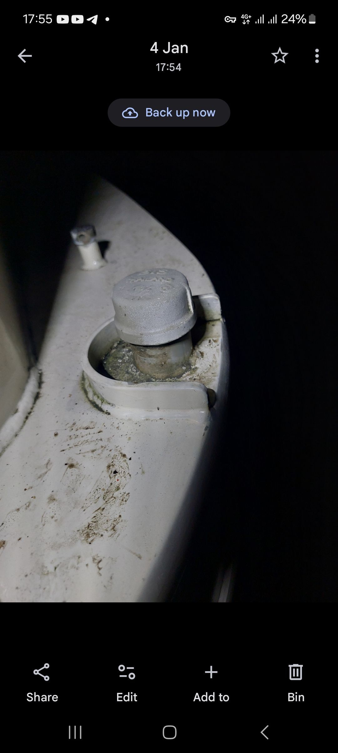

Troyboy Posted January 4 Report Posted January 4 Drill straight through the cap and fit a long shackle padlock.
Poppin Posted January 4 Author Report Posted January 4 35 minutes ago, Alan de Enfield said: Is yours a Reeves boat ! Colecraft 24 minutes ago, Troyboy said: Drill straight through the cap and fit a long shackle padlock. I thought that, but water ingress? Surely rain would get in
MtB Posted January 4 Report Posted January 4 3 minutes ago, Poppin said: Colecraft I thought that, but water ingress? Surely rain would get in I doubt any diesel tank is totally free of water under the fuel. A little bit of rain added to the litres of condensation in there won't hurt much.
pearley Posted January 4 Report Posted January 4 I had a chain welded to the cap and padlocked to the fender chain.
Troyboy Posted January 4 Report Posted January 4 Provided you ensure the padlock is a tight fit in the hole you drill no rain water will get in . As Mtb has replied there will already be condensation in your diesel tank and I suspect you also have a water trap in your fuel line . There will be some swarf when you drill the hole so some grease on the drill bit will help catch some of that or a magnet placed on the upstand pipe . Any you don't catch will settle at the bottom of your tank and won't be worth bothering about.
Tony Brooks Posted January 4 Report Posted January 4 Drill and tap the cap, tighten it down, drill a dimple through the hole and use a security screw to prevent the cap being easily turned.

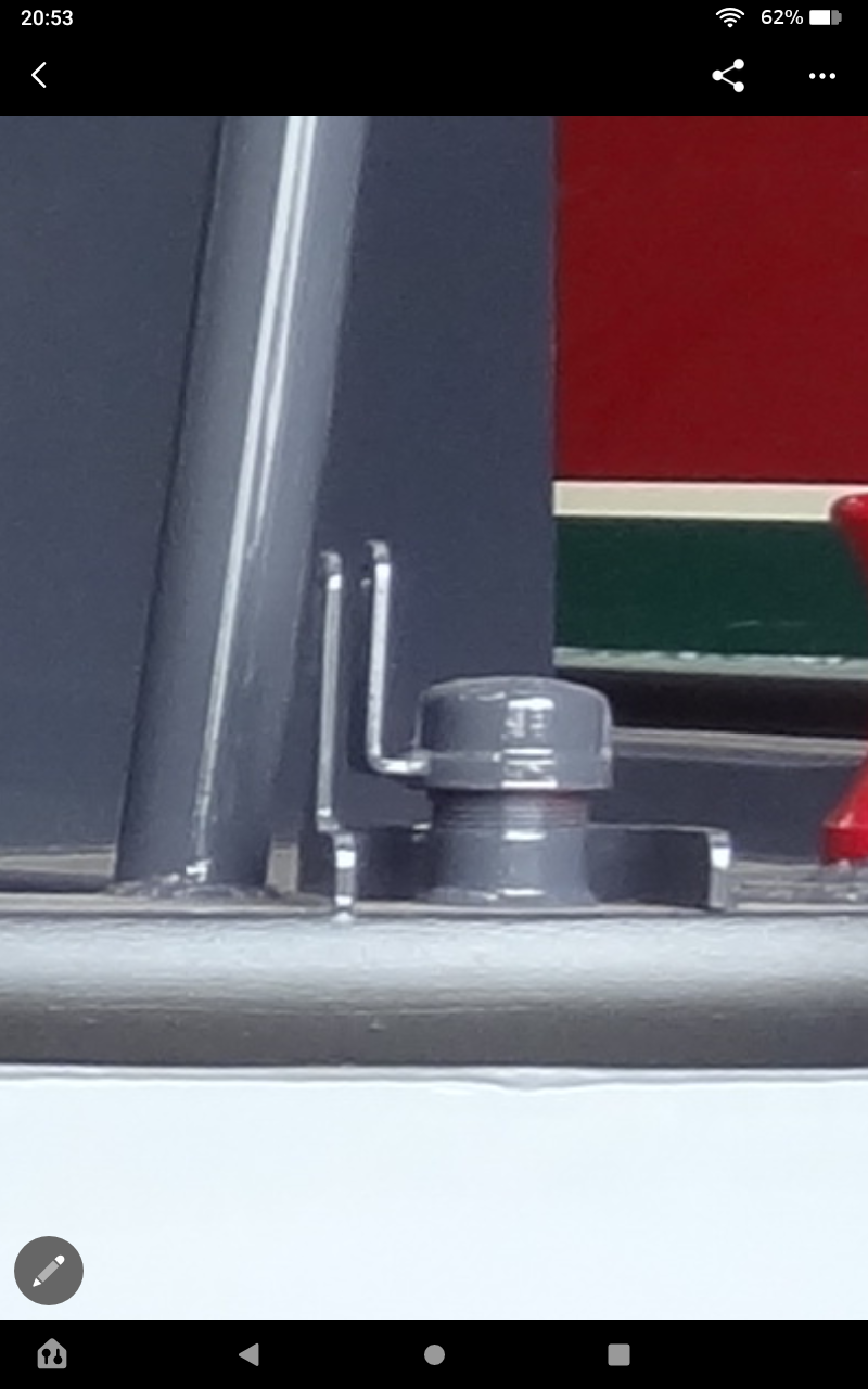

PeterF Posted January 4 Report Posted January 4 Here is the set up on mine, holes in the welded on lugs for a padlock.
MtB Posted January 9 Report Posted January 9 On 04/01/2026 at 20:55, PeterF said: Here is the set up on mine, holes in the welded on lugs for a padlock. The usual way a thief uses to defeat this type of lock, or so I've heard, is to unscrew the air vent fitting nearby and put his syphon tube into your tank through that instead.
magnetman Posted January 9 Report Posted January 9 You could get a hex cap and do it up really tight with a stillson or large adjustable spanner. That way the person considering nicking the fuel would need to have a large tool with them. They might have one but they may equally have come with the assumption that they can remove the cap without heavy tools or knock a padlock off with a hammer. Sometime will correct me if I am wrong but I think these are 1.25" BSP caps. Stainless steel hex cap £12. https://www.ebay.co.uk/itm/125786757186 Check the exact across flats size then get a big spanner. If you routinely keep a 50mm spanner hanging inside the back door this is a valid self defence tool as it is there for another reason. This one is tasty https://www.ebay.co.uk/itm/157595951524 Or a British Rail brake pad spanner https://www.ebay.co.uk/itm/205334908058
