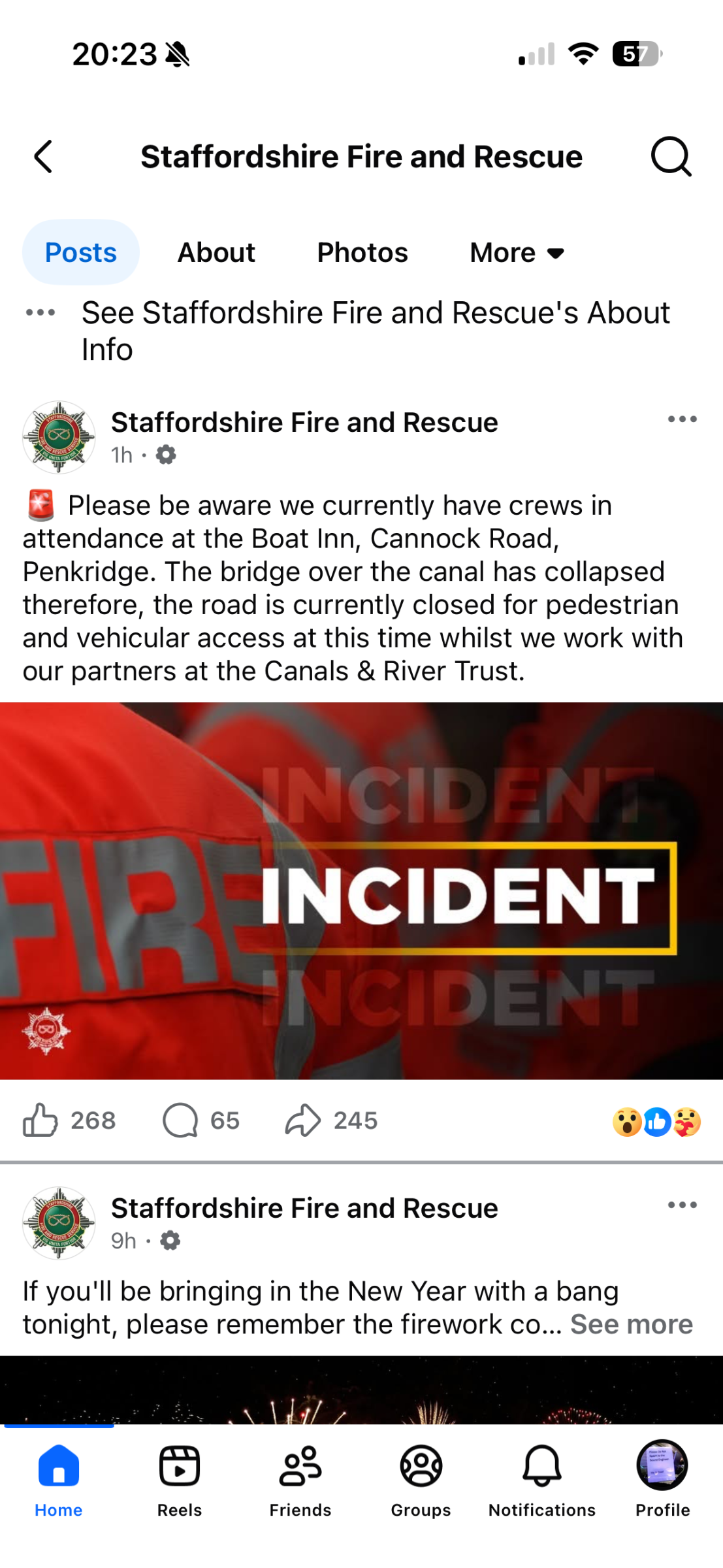

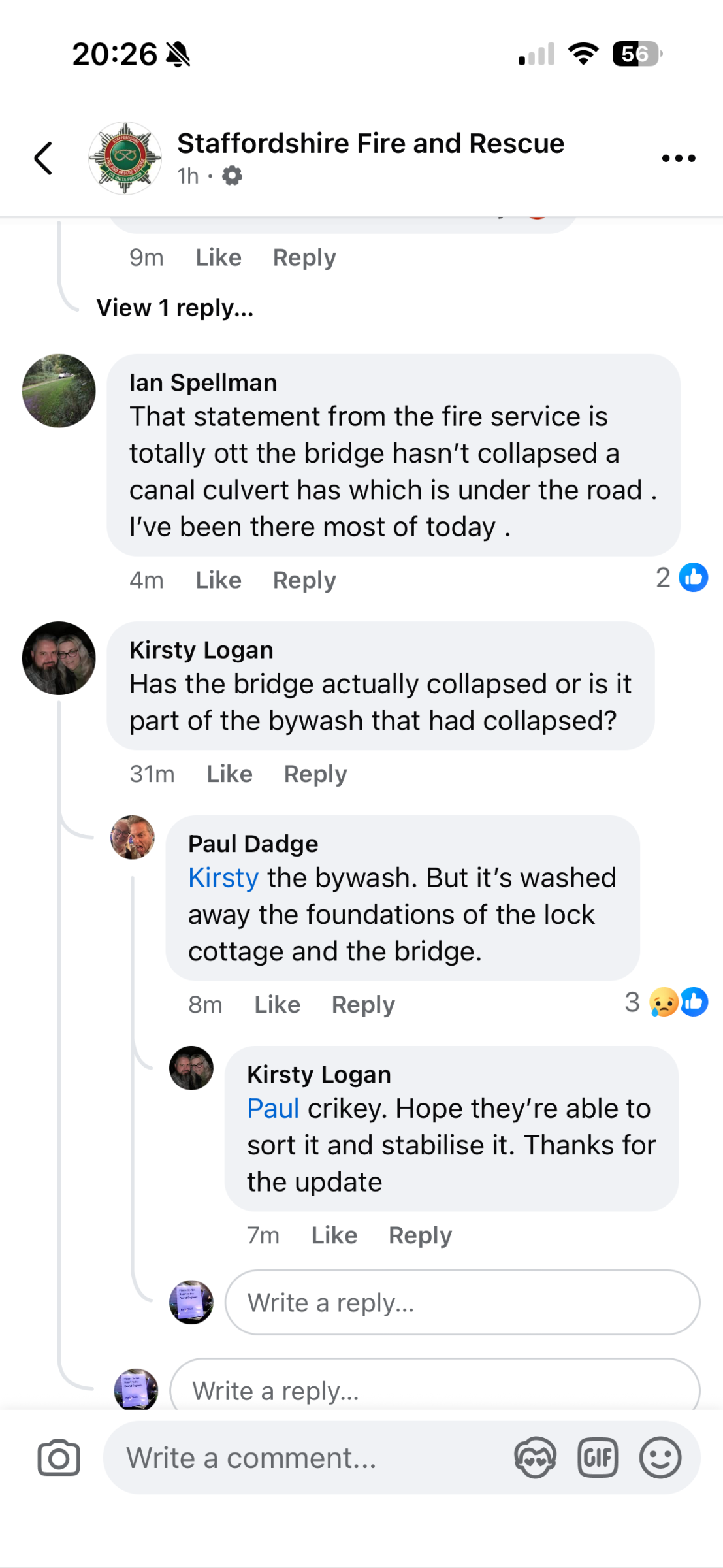

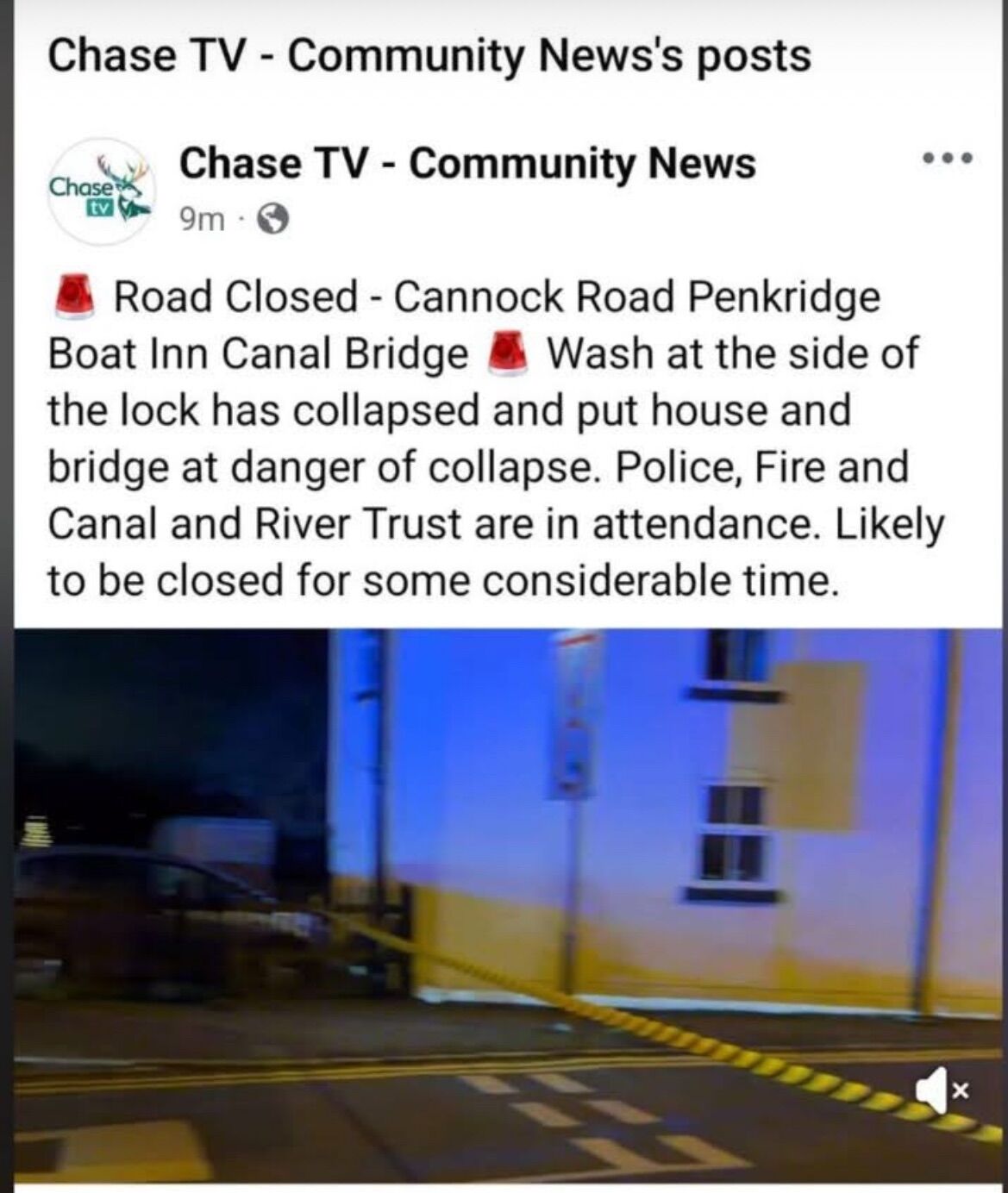

frangar Posted December 31, 2025 Report Posted December 31, 2025 Just seen this from Staffs fire & Rescue on Facebook https://www.facebook.com/share/p/16fXLaSURX/?mibextid=wwXIfr Hopefully not as serious as it sounds Sounds like it might just be the bywash rather than the whole bridge….still might mean a stoppage I guess. 1
frangar Posted December 31, 2025 Report Posted December 31, 2025 Sorry didn’t see this thread. Some screenshots from staffs fire brigade page on this thread I started. 1

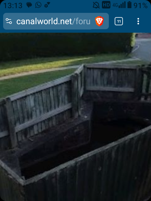

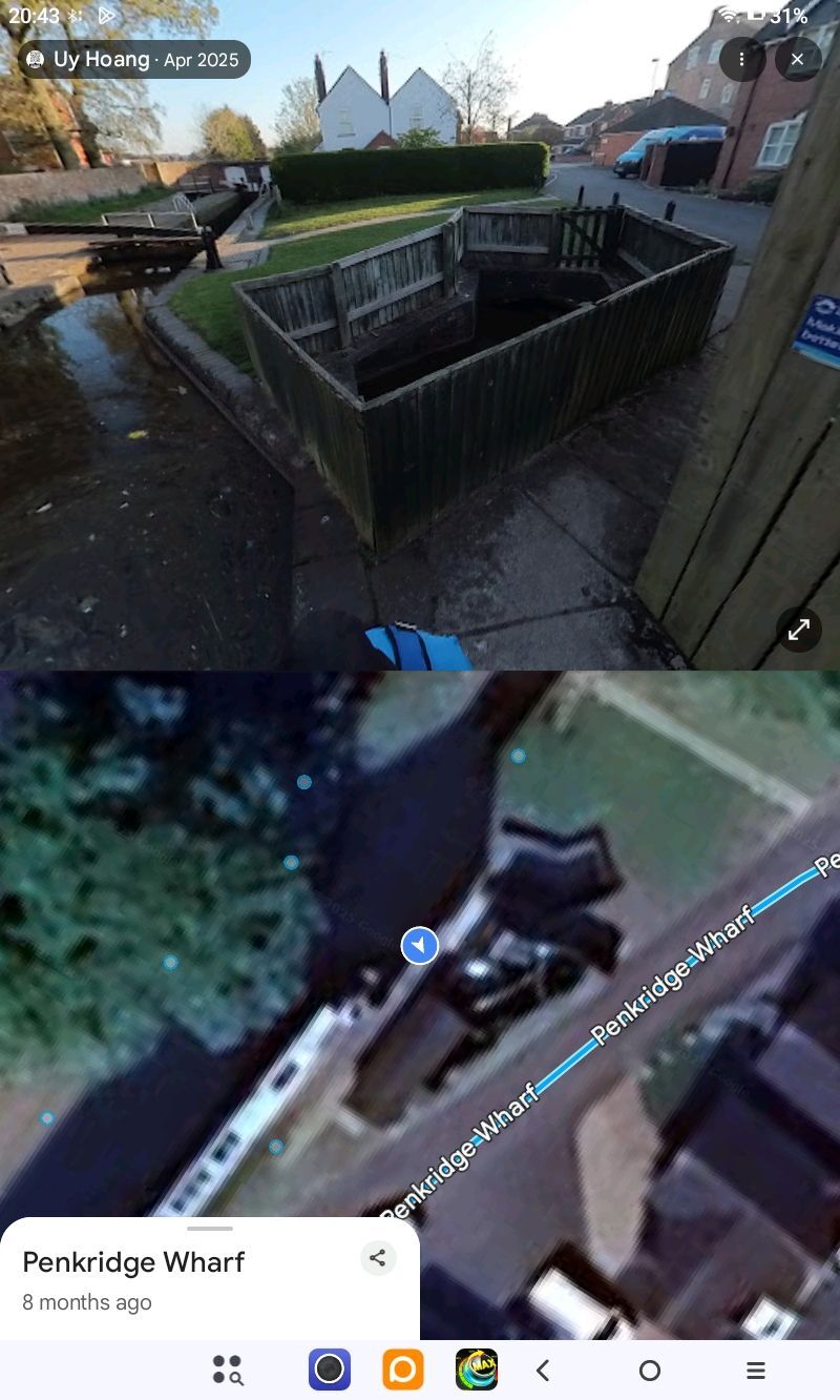

magnetman Posted December 31, 2025 Report Posted December 31, 2025 Presumably this culvert That could be a real can of worms. Is that the bywash for the lock? If that goes under the house... Oh dear.
frangar Posted December 31, 2025 Report Posted December 31, 2025 4 minutes ago, magnetman said: Presumably this culvert That could be a real can of worms. Is that the bywash for the lock? If that goes under the house... Oh dear. Yes I think it does go at least alongside the house and comes out under the bridge. So it’s probably affected the foundations or at least that’s the concern immediately.
magnetman Posted December 31, 2025 Report Posted December 31, 2025 Interesting that the CRT stoppage notice issued this afternoon identified an obstruction. I wonder how it was discovered. Maybe an abundance of caution and it will turn it to be okay. Sounds well dodgy if it's inaccessible.

frangar Posted January 1 Report Posted January 1 A report I read this morning now says burst water pipe causing subsidence but I’m not sure if they would class a culvert issue as a water pipe! It seems the house might be having the issues not the bridge….hopefully it can be sorted reasonably quickly either way 1

frangar Posted January 1 Report Posted January 1 CRT are now saying it's the culvert that has the issue....and they will be working to get the bridge open to road traffic ASAP. What impact this might have on navigation they havent said on what Ive seen so far. I guess the big issue is the culvert is buried and possibly goes under the corner of the house which will make repair tricky and expensive. Does anyone know why some canals favoured covered/piped culverts and some preferred open channels? Is it just location or when they were built or is there another good reason?
magnetman Posted January 1 Report Posted January 1 6 minutes ago, frangar said: CRT are now saying it's the culvert that has the issue....and they will be working to get the bridge open to road traffic ASAP. What impact this might have on navigation they havent said on what Ive seen so far. I guess the big issue is the culvert is buried and possibly goes under the corner of the house which will make repair tricky and expensive. Does anyone know why some canals favoured covered/piped culverts and some preferred open channels? Is it just location or when they were built or is there another good reason? It might have been covered over later on. The fenced off bit seems to have a concrete box over it which does not look very old. A recent modification?

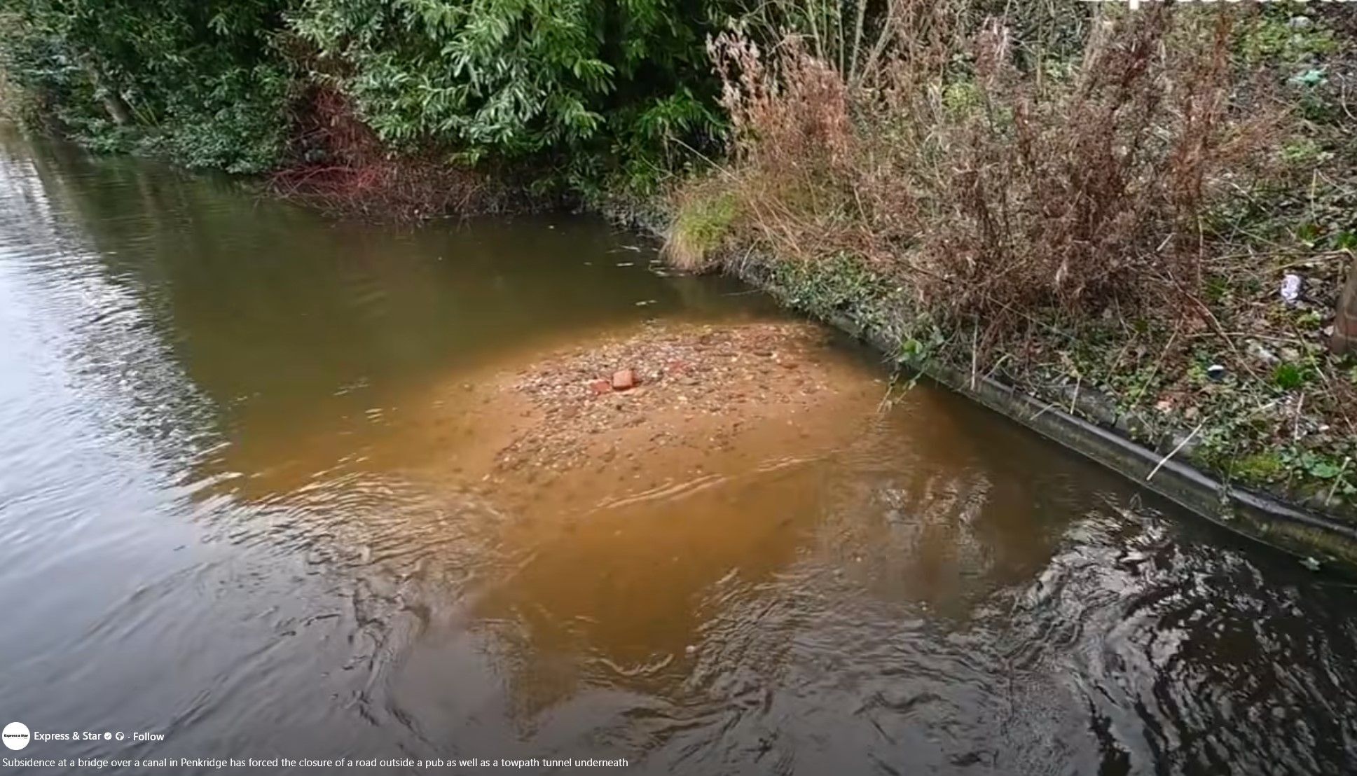

frangar Posted January 1 Report Posted January 1 Here’s an another video from facebook showing the debris in the canal and the collapse under the house….and a lot of pointless footage it has to be said! https://www.facebook.com/share/v/17bCiD5boT/?mibextid=wwXIfr 23 minutes ago, magnetman said: It might have been covered over later on. The fenced off bit seems to have a concrete box over it which does not look very old. A recent modification? I wonder if some of that work was done there when the new houses and access road was constructed? I’m not exactly sure when the new development was done….possibly late 1990’s??
magnetman Posted January 1 Report Posted January 1 I wondered if it was the housing. Maybe an open bywash was viewed as a safety hazard. It's a bit sad if that's what happened.

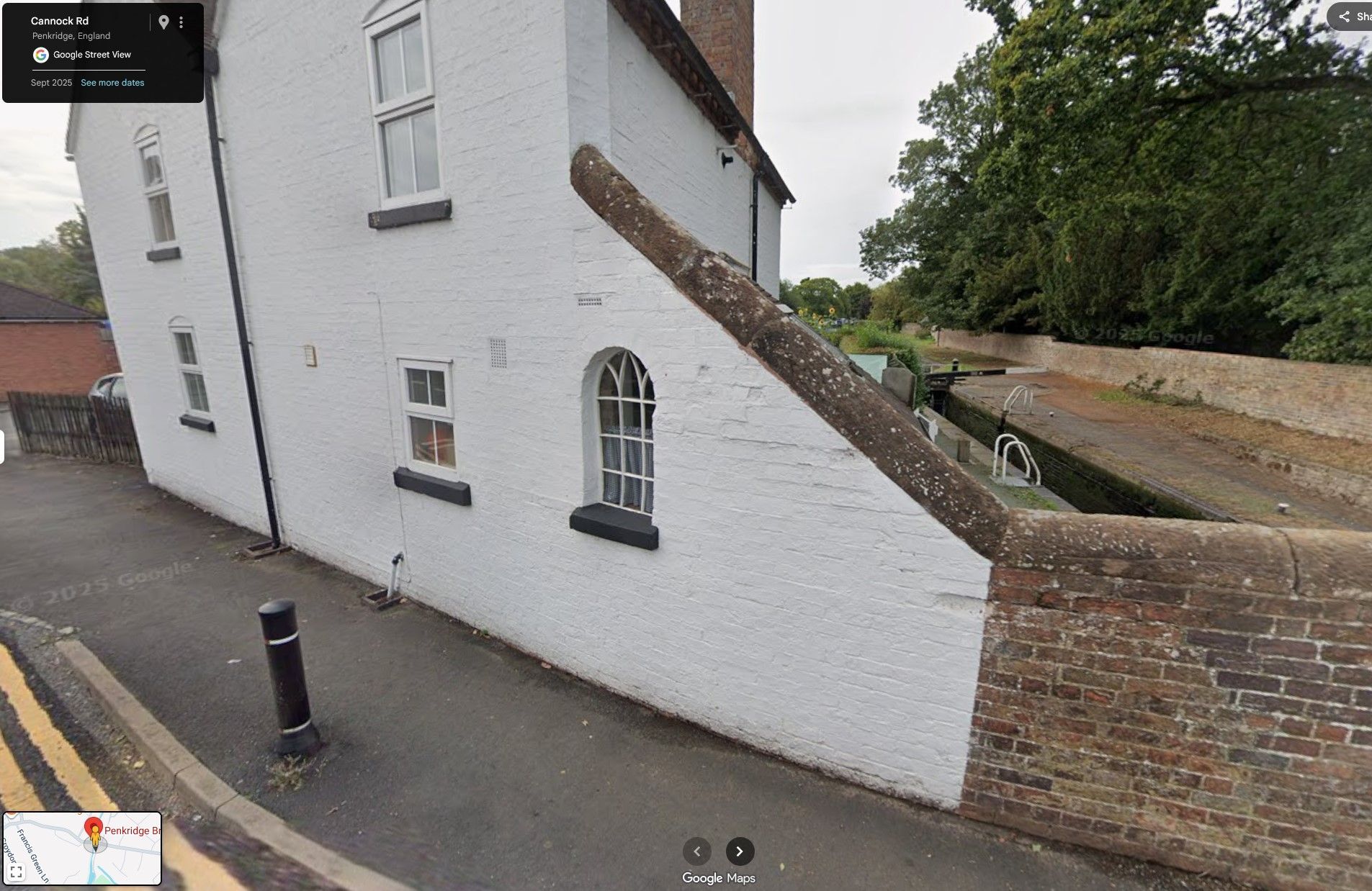

IanD Posted January 1 Report Posted January 1 (edited) Looks like the tunnelled culvert that runs under the bridge and the corner of the house (or the outbuilding) has collapsed, and the resulting debris has washed out into the canal below the lock. Edited January 1 by IanD
David Mack Posted January 1 Report Posted January 1 I wonder who is liable for damage to the culvert and damage to the house. Not an issue when both were owned by the same organisation, but I wonder what covenants were put in place when BW sold the house off. 1
NB Thistle Posted January 1 Report Posted January 1 Got to love social media, I've seen confident statements saying the incident was everything from a small hole in the road to two arches and the adjacent cottage in a state of collapse. It will be good when we find out exactly what's actually happened!
