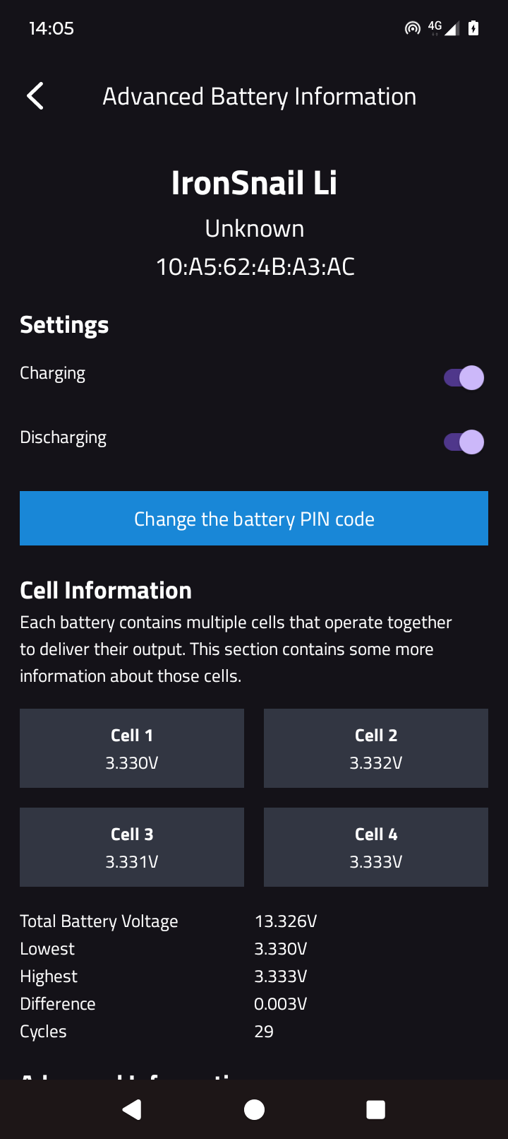

How can it disconnect charging and allow discharging when the battery (with internal BMS) only has one set of terminals? Either the cells are connected to the terminals by the MOSFETs (charging and discharging allowed) or they're not...
The BMS will use different conditions (temperature, voltage, current) for charging and discharging to decide when to do this, but it can only do one thing -- connect cells to the terminals or disconnect them. If it's done a HV disconnect to prevent further charging, the battery is disconnected from the load and can't supply power to it, and if it's done a LV disconnect to prevent further discharging (so the load voltage drops to zero) it can't do any recharging (or supply the load) because it's now disconnected -- until any external charge sources (e.g. MPPT) can provide enough power to bring the load voltage back up past the LV threshold.
If you mean it doesn't allow *further* charging (or discharging) and disconnects the cells depending on the conditions, that would be correct -- but it's not what you said... 😉
I'm not just being picky here, it's an important difference between using drop-in batteries with internal BMS (like Fogstar) and a system where the BMS controls charging sources -- which *can* do what you say because it has separate control over charging (sources) and discharging (loads).
I belive its called electronics Ian... 🤣😂
Sarky comment aside. The frogspawn does do that. I had someone panicking recently... nothing working etc .... turned out his fat finger had caught the discharge off switch on the frogspawn app....

Sorry but it can't -- it can *choose* when to disconnect depending on voltage/current/temperature/charge/discharge/cell balance/fat finger, but once it's disconnected for whatever reason -- while charging or discharging -- it can't do "the other thing" until it has reconnected.
So you can't have charging disabled (HV disconnect) and continue to allow discharging into a load, and you can't have discharging disabled (LV load disconnect) and still allow charging. It's both (connected) or neither (disconnected).

The Fogstar supplied BMS can do this. MOSFETS for charging and another set for discharging. Presumably with blocking diodes, like this. Certainly on mine, I can manually turn charging, or discharging on and off, via the app.
11 minutes ago, Jen-in-Wellies said:
The Fogstar supplied BMS can do this. MOSFETS for charging and another set for discharging. Presumably with blocking diodes, like this. Certainlynon mine, I can manually turn charging, or discharging on and off, via the app.
I'm afraid your "presumably" is wrong -- you can't have high currents flowing through forward-biased diodes, the power dissipation is far too high (about 100W at 100A).
There may indeed be two internal MOSFETS which can block the two opposite cases (Vout>Vbatt=HV disconnect and Vout<Vbatt=LV disconnect), and you can separately tell the BMS when to trigger disconnect depending on charging or discharging (current direction), also temperature (can't charge when cold), and indeed whether to allow charging or discharging at all -- but when the MOSFETs are on they're on (low resistance, a few milliohms), and when they're off they're off.
For example if you only permit discharging (charging disabled) then the battery will drive the load, if you then connect a charging source (e.g. MPPT) and ramp the current up the current drawn from the battery will decrease until it hits zero. As soon as the charging current exceeds the load current and current starts to flow into the battery, the battery *will* disconnect. This means it no longer holds the load voltage down, and there's nothing to stop this carrying on rising if the charging source doesn't stop it, because the battery is no longer controlling the voltage at its terminals.
