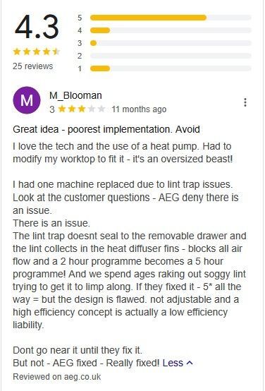

I did look for a heatpump washer-drier when I was fitting out a couple of years ago but there weren't any. The AEG is the only one now but the fact it's not shown as available on the AEG UK website (and nobody in the UK has any stock) makes me suspicious, not the cost... 😉
Maybe they withdrew it from sale because of problems? See here...
