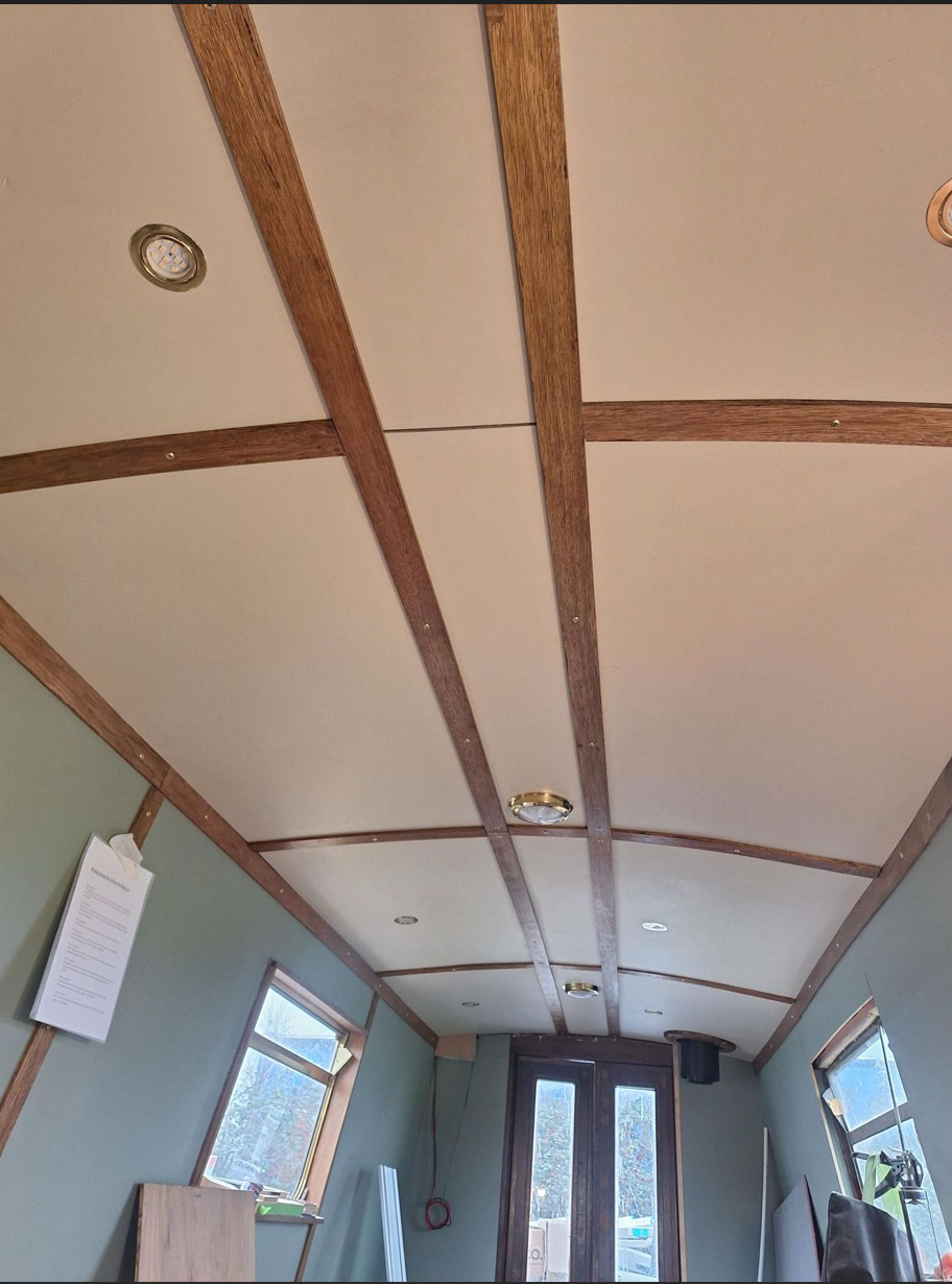

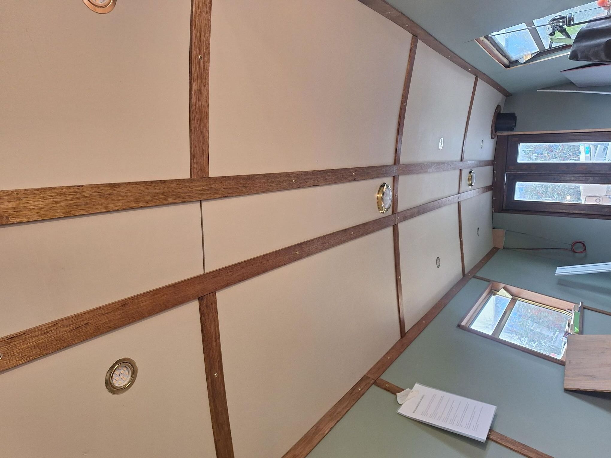

Well I have been re-fitting this boat for nearly two years and during the winter months I have encountered the cold, but yesterday and today for the first time I encountered actual damp, well wetness so bad my paperwork was soggy. The boat is insulated really well and fully lined, the windows are all sealed and no doors open, it looks pretty serious! could it be that on Sunday I had the boat warm and the sun also helped, and overnight the frost attacked, just how does it all work? it's something new to me, will damp and condensation be my enemy forever? are there any tips? can't turn picture again

Any heating in the boat? Ventilation?Any water in the cabin bilges?
We're you producing water vapour from cooking/showers/breathing?

David, the boat is bone dry in bilges I took it down to bare metal, no water on board at all yet
Turned it for ya!

I can't see any signs of permeant high level vents, so goodness knows if there are any low level ones.
Warm air holds more moisture than cold air, and someone working in a boat, burning gas, and cooling will make plenty of vapour. If there is insufficient ventilation then as the air cools it will give up its moisture, usually on the coldest surfaces. Ventilation will help exchange the warm moist inside air with cooler, dryer outside air.
Unless the rain is driving, try opening the window hoppers.

You may have a point, I sealed some vents and the Mushrooms are still off the roof so maybe that is holding the warm air which then cools to water. Hmmmmm

Before you start cutting the head lining boards, try leaving a couple of hoppers open and see if it helps, if it does then recut the roof vent holes, but you will also need lower level vents so hot air can rise up through the vents and cold air flow in lower down to replace it.

Where's the dampness or condensation accumulating exactly? I can't see from your picture.
As others have said, ventilation is important.
Apart from lack of ventilation one other factor which hasn't been mentioned is that when you first return to a cold boat and light the stove or switch on a diesel heater, because the air inside the boat heats up much faster than the dense, solid objects in the boat, the moisture in the warm air is drawn to the cold objects and condenses on them. If you come and go every week or so and the boat goes through several cycles of heating and cooling the moisture can accumulate.
I've noticed this especially in low level cupboards which had a load of tools inside. There was so much water in them I thought I had a leak! Once I emptied the bottom of those cupboards and put some small vents in the doors the problem went away.
