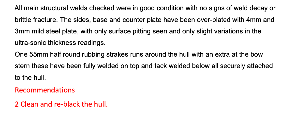

I'm looking at a beautiful 26ft Piper boat, 1972. Good quality new engine and nice friendly lay-out. The survey report says this about the hull – I am new to boating and wonder if anyone can advise me on whether this is good or bad?! I'm aware that 1972 is a pretty old boat; the price is just under 13k so pretty cheap for what it is and I have time to do things that need doing: getting new heating sorted, repainting, etc. Any advice would be much appreciated – thank you!
Screenshot2025-11-20at21_06_23.png.2205f4104666d82ce2586827dd792742.pngScreenshot2025-11-20at21_06_34.png.82186d1f80c954f8337181674f266c61.png
If you intend to insure this 'fully comprehensive' then you will not be able to do so without more welding work - it seems the minimum thickness insurers will cover is 4mm and you have most of the thickness readings at below 4mm.

Surely the overplated sides are a lot more than 4mm, as that's just the thickness of the overplating. There must be some original steel left underneath - same with the rest if it.
when a boat is doubled, it is only the outer 'skin' that is measured / included - no one can tell the state of the original steel - it could even be perforated.
The original steel will continue to corrode beneath the new steel - here is an example of a piece of overplating removed showing the condition of the original ...............
Photograph 4 shows the faying surface of the doubling plate that was removed and which can be clearly seen to be corroding from the inside outward. It can also be seen in this photograph the doubling plate had been welded to the harpin in places making the doubling plates seam weld porous to water to entering between the doubling plate via the gaps created when the D sections harpins were originally stitch welded in manufacture. The fault would have been compounded by crevice corrosion and a poor maintenance programme though out the vessel’s life.
Edited by Alan de Enfield

Yes there are a number of overplated boats 'out there' but have they been overplated with thicker steel than 4mm ? has the erosion / corrosion on them led to them being below 4mm ?
You might enjoy picking fault with others posts but do you know the answer ?
Consider the OP, looking to spend her / his / their hard earned pennies on their 1st boat and asks a question for reassurance they are not buying 'trouble'. They get a response with two unquestionable facts :
1) the boat has many 'thickness measurements' below 4mm.
2) insurers will not provide fully-comp cover for boats with thinner than 4mm readings.
Now the OP is advised to consider if he / she / they want to go ahead with the boat on the basis that they will only be able to get 3rd party cover, and it is pointed out that this is sufficient cover to get a licence.
That is not scaremongering.

I wouldn't be overly concerned about those readings on a £13k 1972 boat.
As stated by others, you can't insure a boat of that age 'Fully Comp' with under 4mm readings...however...with those readings I'd be happy to insure just Third Party Only, which you can do regardless of survey result.
If you like the boat and everything else about it is right for you, I'd be going for it.
In fact I'd go as far as to say I think you'll find it hard to find a boat under £15k with a new engine and sound hull and you seem to have on there.

In general I agree with those saying not to be too alarmed.
THe price sounds good for a Piper boat, (even a smal one), and if the engine is really new that is a decided bonus, (although you don't say what engine it has, I think.}.
If I have a concen it would be the use of just 3mm steel for some of the overplating.  I can't recall coming across that before  - normally I would say that 4mm is the usual minimum.  It seems a odd choice as the cost difference between 3mm and 4mm I would expect to be fairly minimal.
To some extent, I would say whether you should buy or not depends on how much residul funds ypu will have after purchase.  Inevitably with a boat of this age you'll end up spending quite a lot on something - even if the hull proves to have no urgent need of any work.
Good luck with it anyway - I've always has a soft spot for Pipers.

Maybe 3mm was used because it's lighter than 4mm and a short 26' boat doesn't have much buoyancy to spare when you take the bow/stern taper/swim into account?

Alan is however correct in his response to this point. Even the most positive & optimistic surveyor would never include the thickness of the original steel which has been overplated. It was too thin in the first place which is why it was overplated, so only the new plating is measured and quoted. The remaining original steel behind shouldn't count in anyone's estimation.

As a leisure boat, it would be great. The thickness wouldn't worry me at all - think about the rate of corrosion and that represents and you can see how long it may last. As a liveaboard with all my worldly possessions on it I would be inclined to buy the tug instead - more space and the ability to insure fully comprehensive which is less about the boat and more about the contents.
Since the OP has time to sort it out, I would get it blasted and epoxied because that will minimise any further corrosion. Blasting will probably show up a few deeper pits, which I would get welded up before painting, and I would also get the underside of the guard iron fully welded too. The original thinking was that the water would drain out but in practice it has been found that corrosion between the guard iron and the hull causes a wedging action and eventually something gives - either buckling the hull or cracking the welds.
One big advantage of this boat is that it is very short. It only takes about a third of the time and materials (and hence a third of the cost) to do things to the hull. This means you can stick a full coat of epoxy on in one go and then have a cup of tea!
