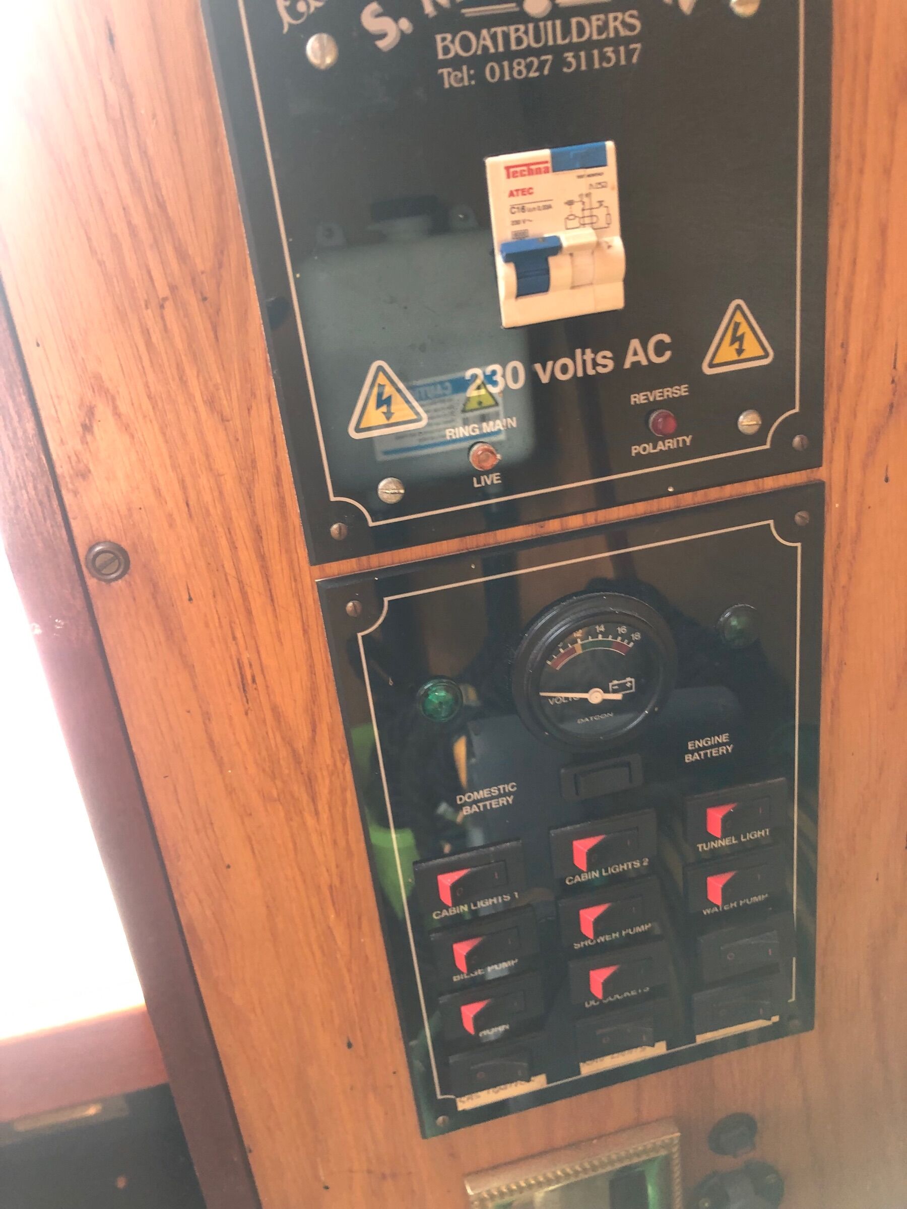

I’m relatively new to boating and brand new to this forum . We have a 50ft Steve  Hudson nb. Have been doing some upgrades and so on but have not found any fusebox. I’ve looked behind the switchboard near the gearstick but only found 2 in line fuses. Have I missed something more obvious ?!

Are you sure these "switches" are not MCB circuit breakers (modern fuses)? They can look like switches until one trips and switches itself off.

it’s in good condition and the stuff is original Mainly . I wondered whether the switches were mcb circuit breakers…

Anyway, probably the question relates to dc, and I think the dc distribution panel has switches which are also breakers. I’m not certain because ours was a one-off with digital dc distribution.

And those pictures show 9 MCBs (Miniature circui breakers) as well as one blade fuse that looks like it is a late addition.

confirmed what I suspected
