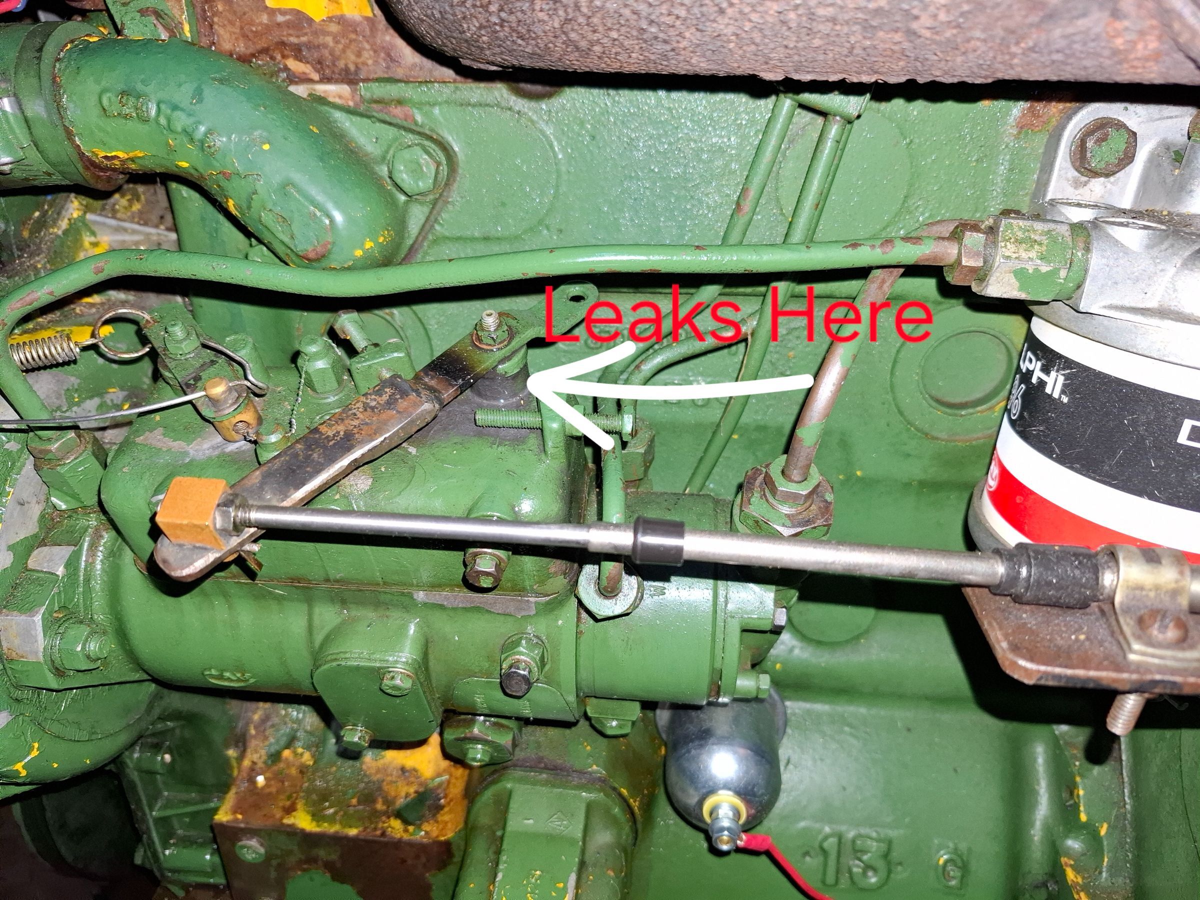

The whole area around the pump is wet with fuel, particularly the fuel regulator shaft (throttle)
That is often caused by cable "overthrow" when you set it to idle. The lever stops against the idle stop screw, but the cable tries to push it some more. This results in the lever shaft being pushed against one side of the O ring in the rectangular "top". I expect that O ring is well-worn, but make sure there is no overthrow when you refit the pump. Adjust the fitting on the end of the cable if required.

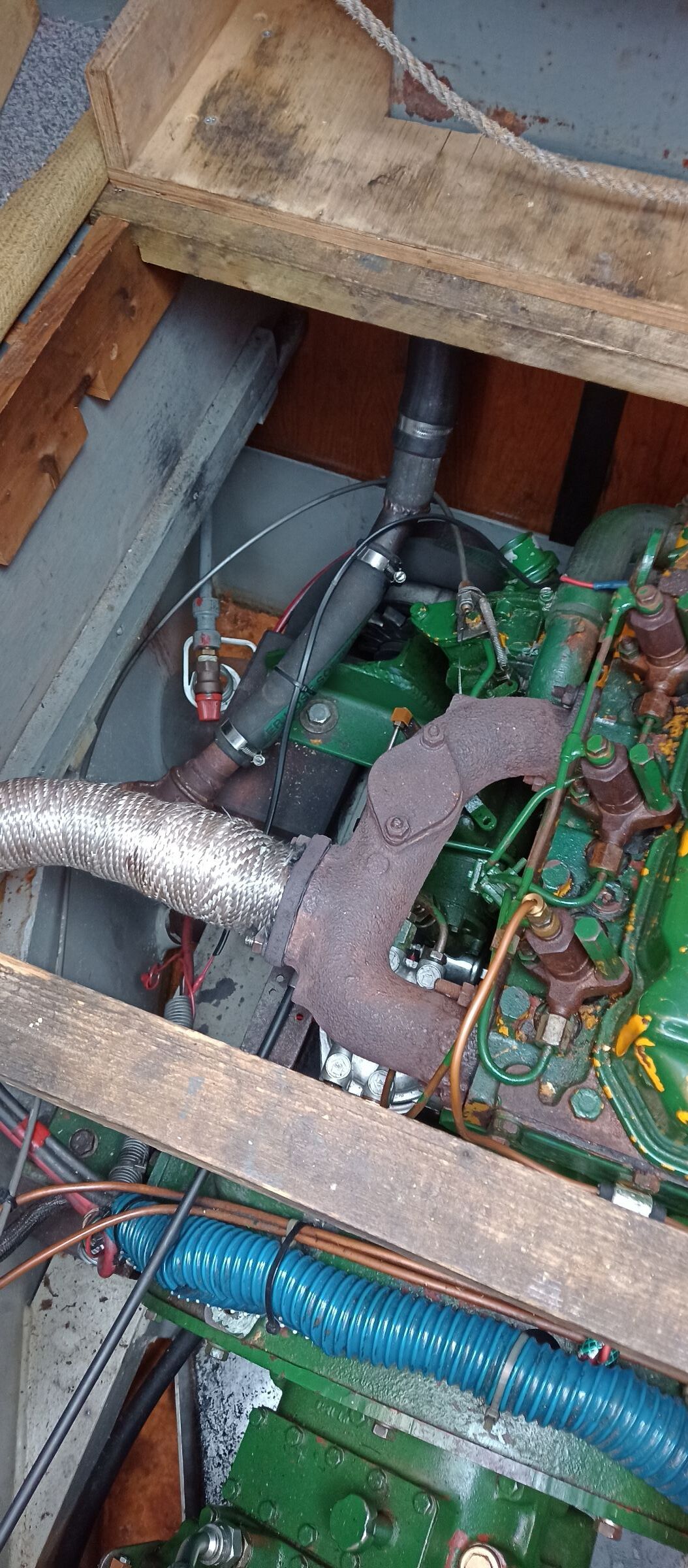

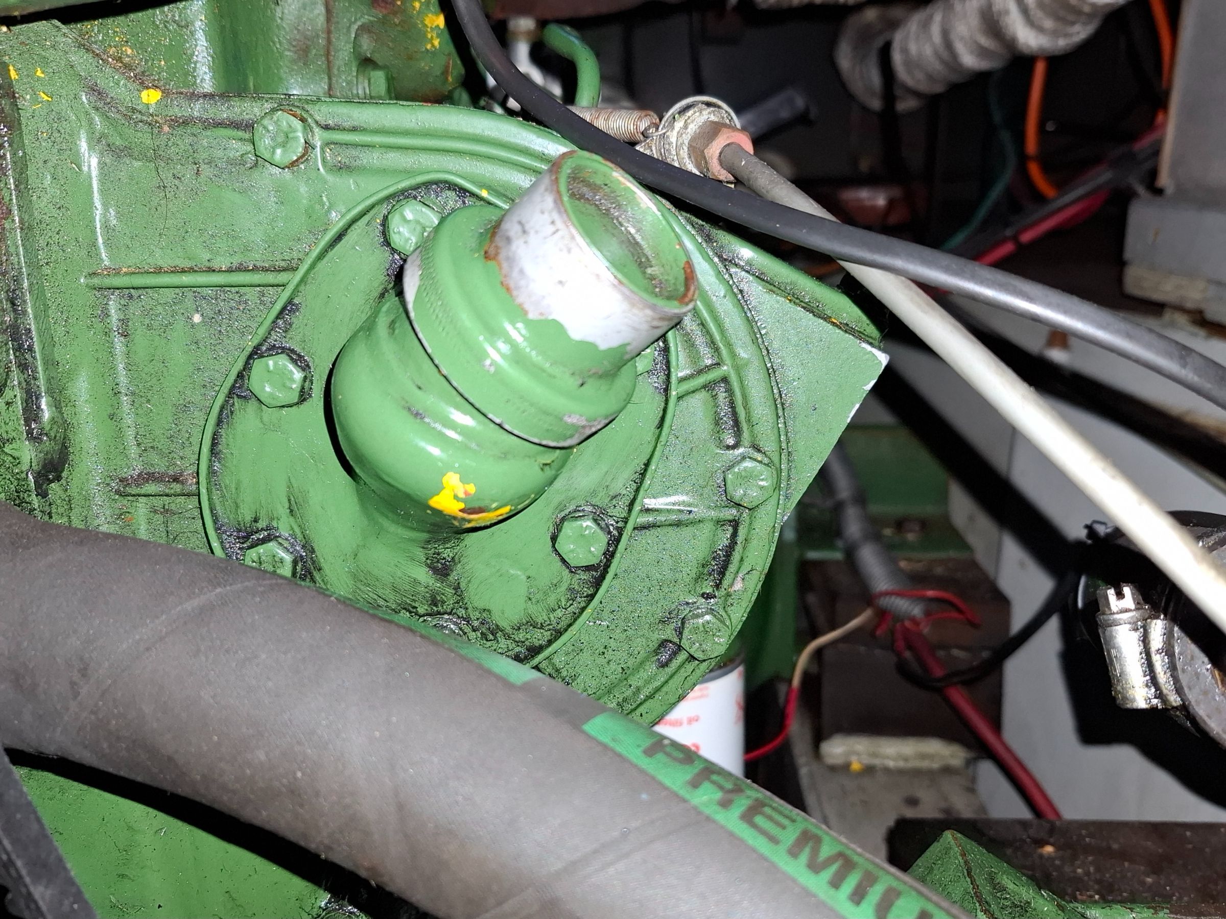

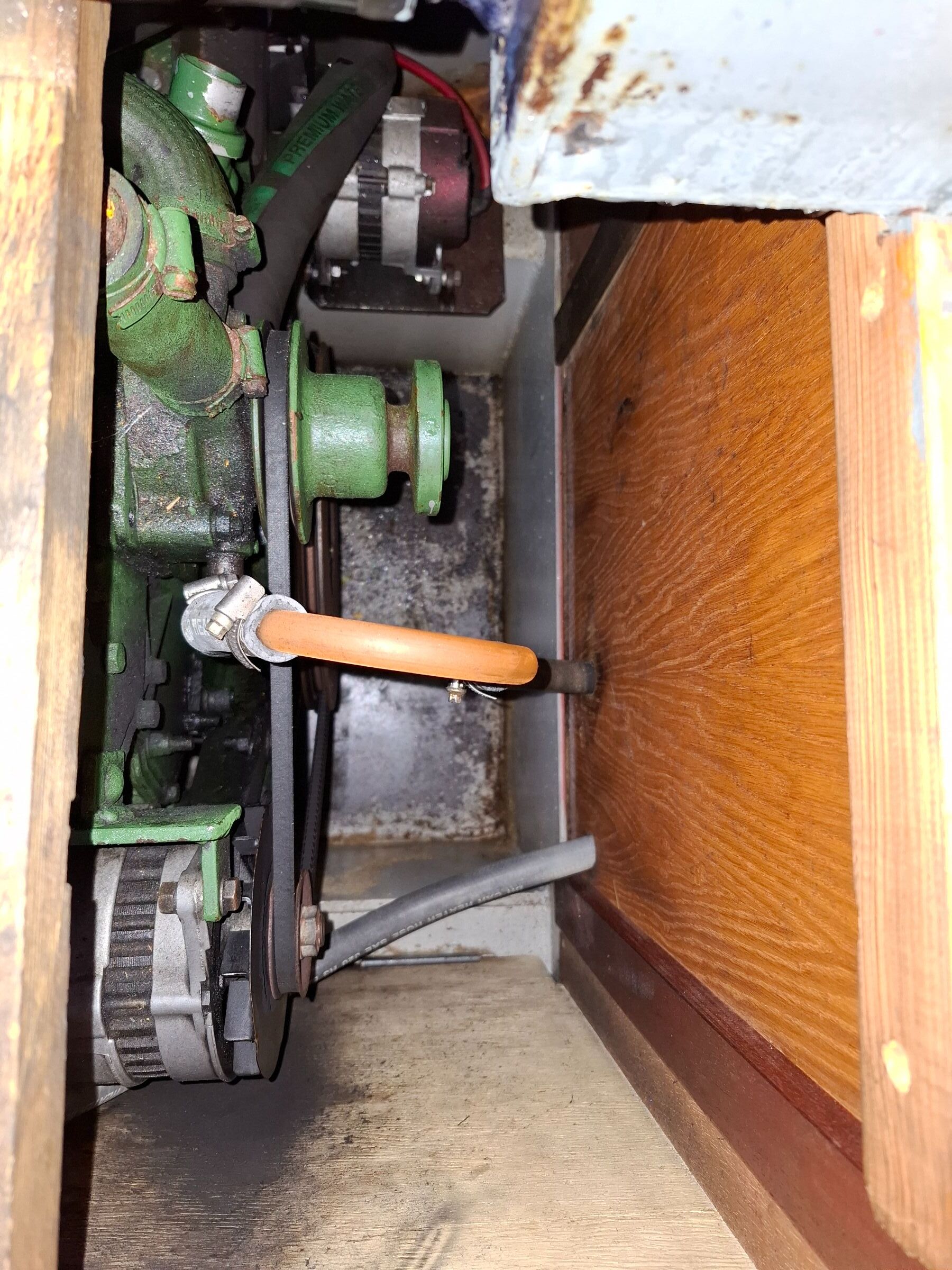

You're correct, the test will be if I have  reasonable access IMG_20250617_142820189.thumb.jpg.289053453c9b081b0d508a67776762e3.jpgbetween the engine bay bulkhead and the timing cover.
I'm not on the boat at the moment so I can't check. Fingers crossed?
Thank you for the hints and tips.
On 23/11/2025 at 20:15, Oversway said:
Thank you John B. Yes that is the procedure as outlined in the manual that I intend to follow. I've also watched a video where a guy removed the pump from a MF tractor with a Perkins engine.
There's actually plenty of room

The leak was traced to perished o rings on the pump throttle shaft.
I called a local diesel specialist who came out to me on site. In no time he had the pump apart and replaced the offending seals. Fantastic service and the guy certainly knew his stuff. ("Ive done thousands of these") I can thoroughly recommend them.
